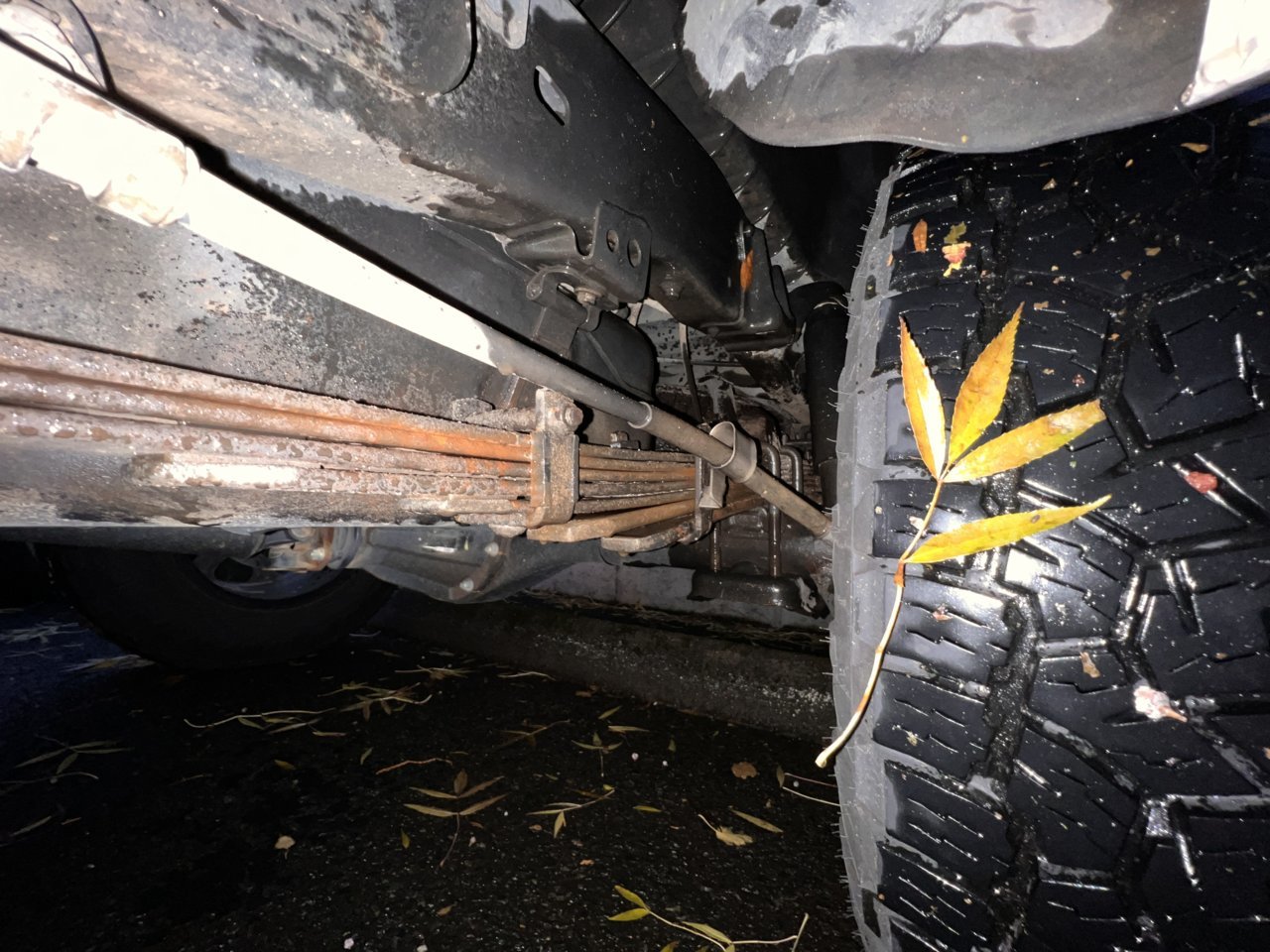

    So…I’ve had my suspension for almost 2.5 years. It’s noisy as all get up and has rust. Anyone experience this much rust? Or is this normal?

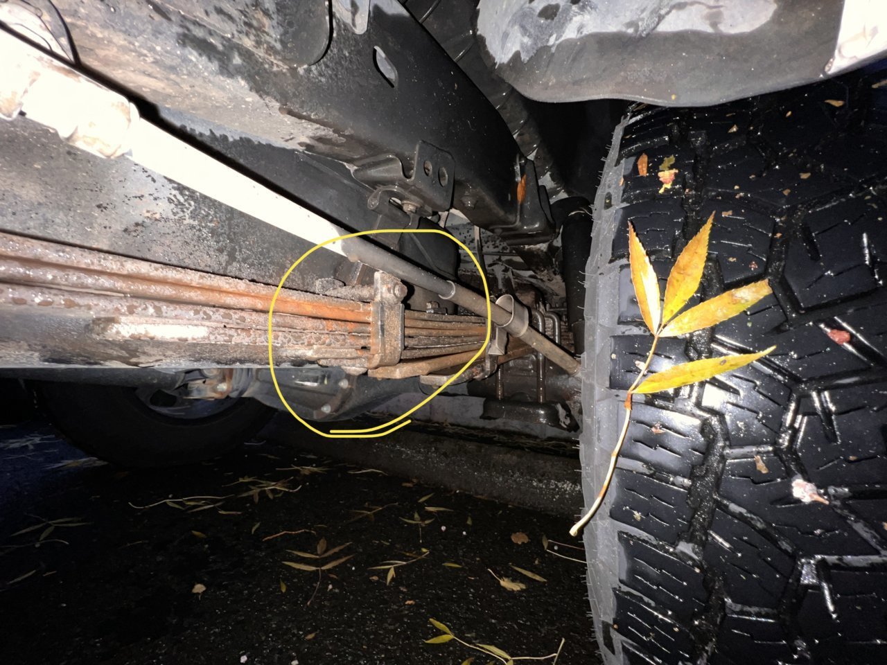

    Id say that looks a little heavy for rust. That said, I’ve kept my under carriage and leaf packs well covered in wool wax.
    They have the 3 year warranty, send them the pic on insta and see if they reply.
    Their username does not come up for a tag…
    Here is where mine was squeaking bad- I’ll also upload a pic of what mine look like. Might not get as much snow but they snow and brine a lot here in MD during the winter.
    Superhulk LB[QUOTED] likes this.

    @Superhulk LB here’s mine. Most of what you see is from the wool wax.

    That’s pretty clean. I sprayed mine with wool wax or the other stuff. I wash mine after any beach trip. I didn’t expect it to rust so much. Oregon also rarely uses salt. Thanks for the pic and info.

    You’re pretty close to their shop right? Maybe I’m remembering that wrong but take a drive up/over/down there and see what they say. Or go to one of their coffee meet ups and ask lol

    Yeah, about 45 minutes away. That’s probably my best bet. Lol.
    Sadly, my factory parts are rusting a little too. Drives me crazy.
