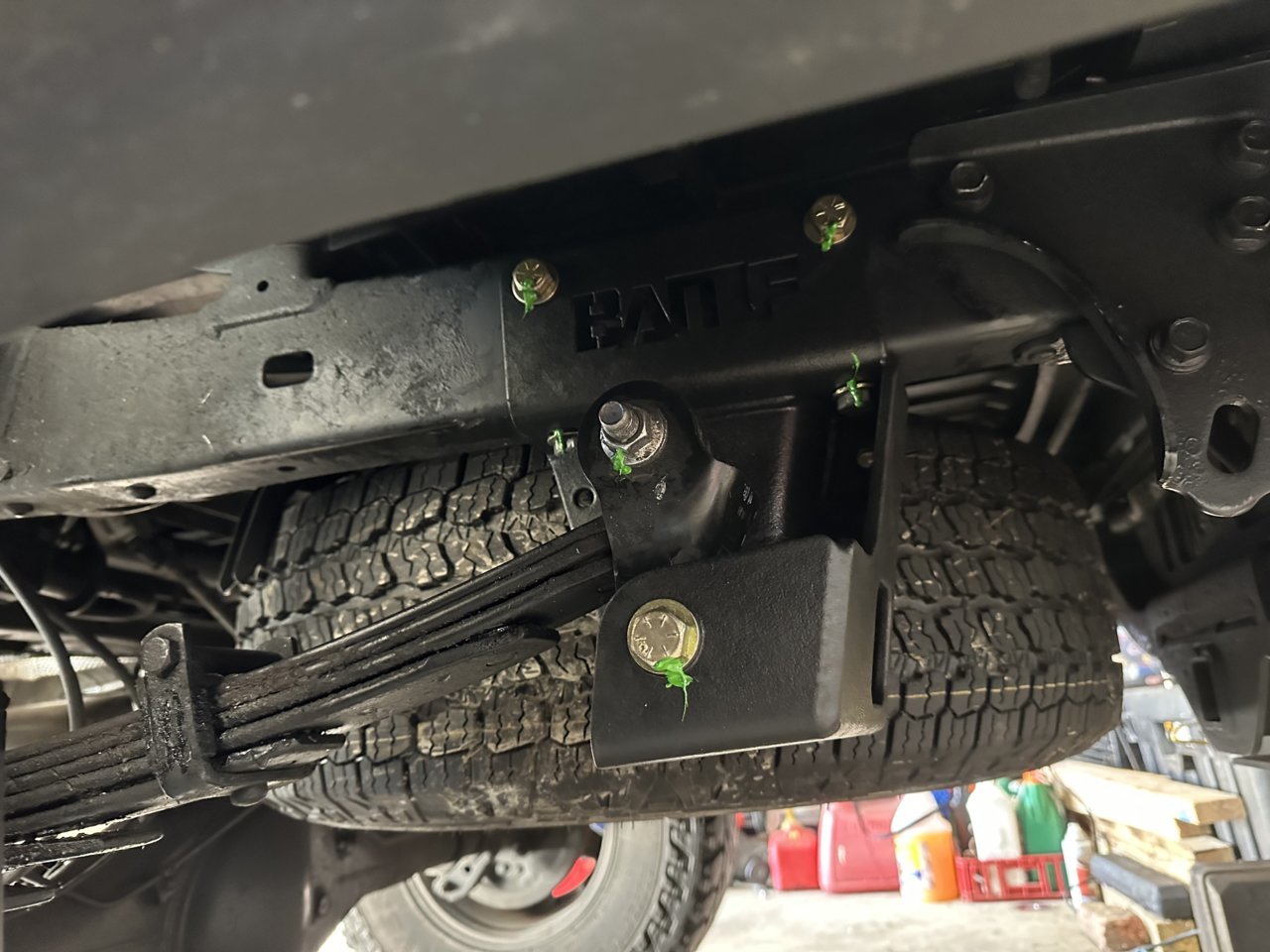

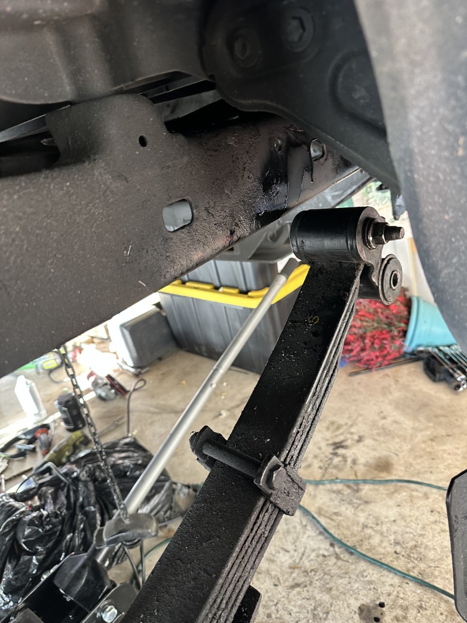

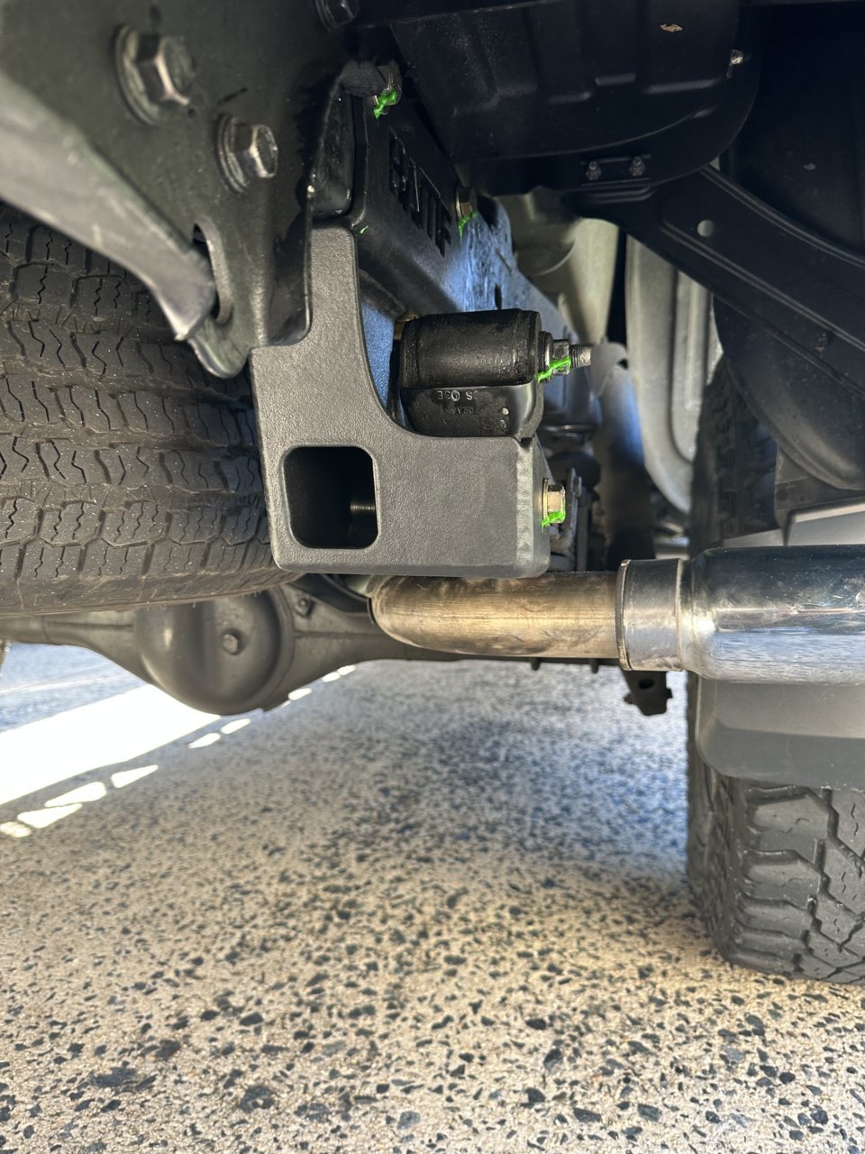

  4. Jan 1, 2023 at 5:15 PM
    #2524
    hyrule_trd
    hyrule_trd It’s a Secret to Everybody
    Jan 26, 2020
    #317260
    10,113
    Eric
    Harford County, MD
    2020 Black TRD OR
    Ironman Stage 1 Foam Cell Pro lift kit, 255/85/16 Cooper ST Maxx, SCS BR6 Wheels, SPC UCA, Heated seats, MESO TRD start button, Meso Total Tail v1, Meso V5 mirror white DRL turns, bed decal, ditch and hidden bumper lights, screen protech, RAV4 radio knobs, steering wheel anytime camera kit, dash cam, ECGS bushing, Timbren Active Off Road bump stops with Wheelers flip kit. 35% Xpel CS Ceramic Tint, KD Max Tune, SumoSprings front bump stops, RRW Sliders ‌ ‌ ▲ ▲‌ ▲
    Got them in the other day! I kept the stock shackles though. From what I could tell, it would take a lot or articulation for the leaf to rub on the shackle but they are definitely close. I opted to not cut the leaf at this time. In the future I might but the hd shackles but getting them now was over budget.
    The removal of those stupid rivers was terrible. Took all of about 6 hours to get them out, the about 1.5 hours to get the new hangers in. I had a angle grinder, bearing press and drill with colbalt bits…
    If you have or know someone with a plasma cutter, that seems to be the easiest way to get them out.
    this was probably the worse thing I’ve done on the truck lol. And I’ve messed with the seat upholstery to add heated seat elements. It could be that I’m old and not used to spending hours working like that.
    The ride feels better, but I’ve not driven at higher speeds that usually showed the shudder but will in a few days. The back does feel more stable and less… bouncy maybe. Going over speed bumps and things feels different now. Would I do it again… yes… would I try and find someone close and willing to do it for a few hundred.. probably

    Lord! That's a while. I'd heard it's a bear, but I didn't realize it was -that- bad. I think I'll take my time making the day dream a reality :rofl:

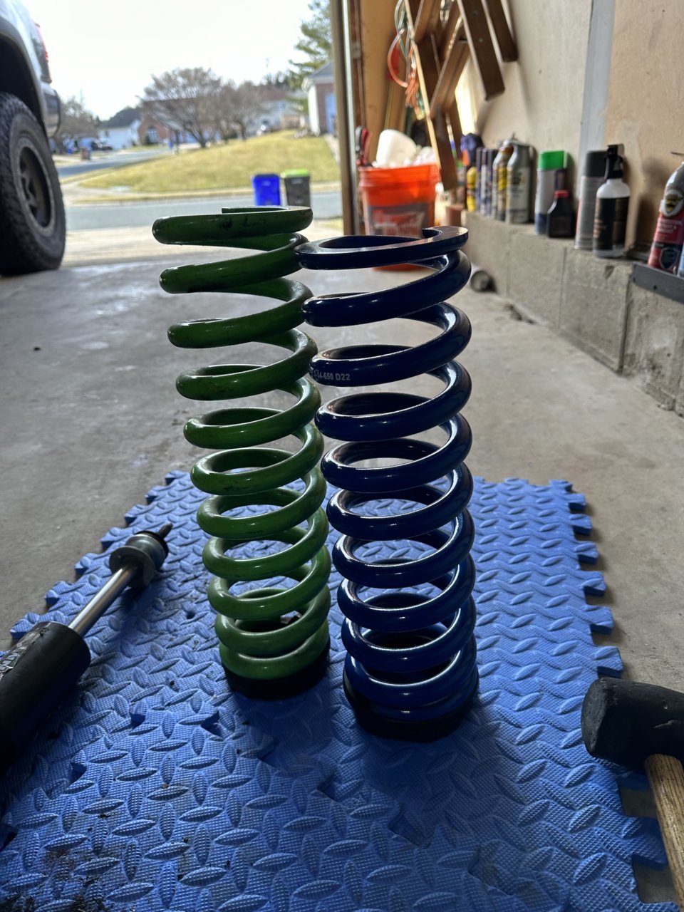

  12. Feb 6, 2023 at 2:07 PM
    #2532
    hyrule_trd
    Jan 26, 2020
    #317260
    10,113
    Eric
    Harford County, MD
    2020 Black TRD OR

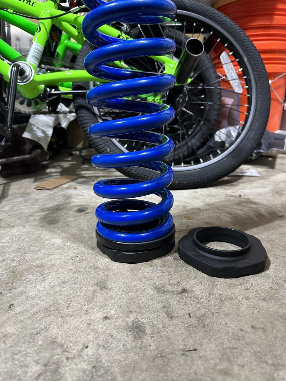

    Im planning on swapping the springs over on Friday. The spring seat I modified is not the best looking but it’ll do the trick. The spring, isolator and seat come in at 15.25” while the free heigh of the IM spring is 15.35”. So pretty close overall.
    Unless I change my mind, I’ll be raising the spring seat up by about .25-.35” to account for the difference in height and the difference in spring rate. I don’t need or want 3 full inches of lift, looking for 2.0-2.5”. Keeping the pressure off the cv axles.

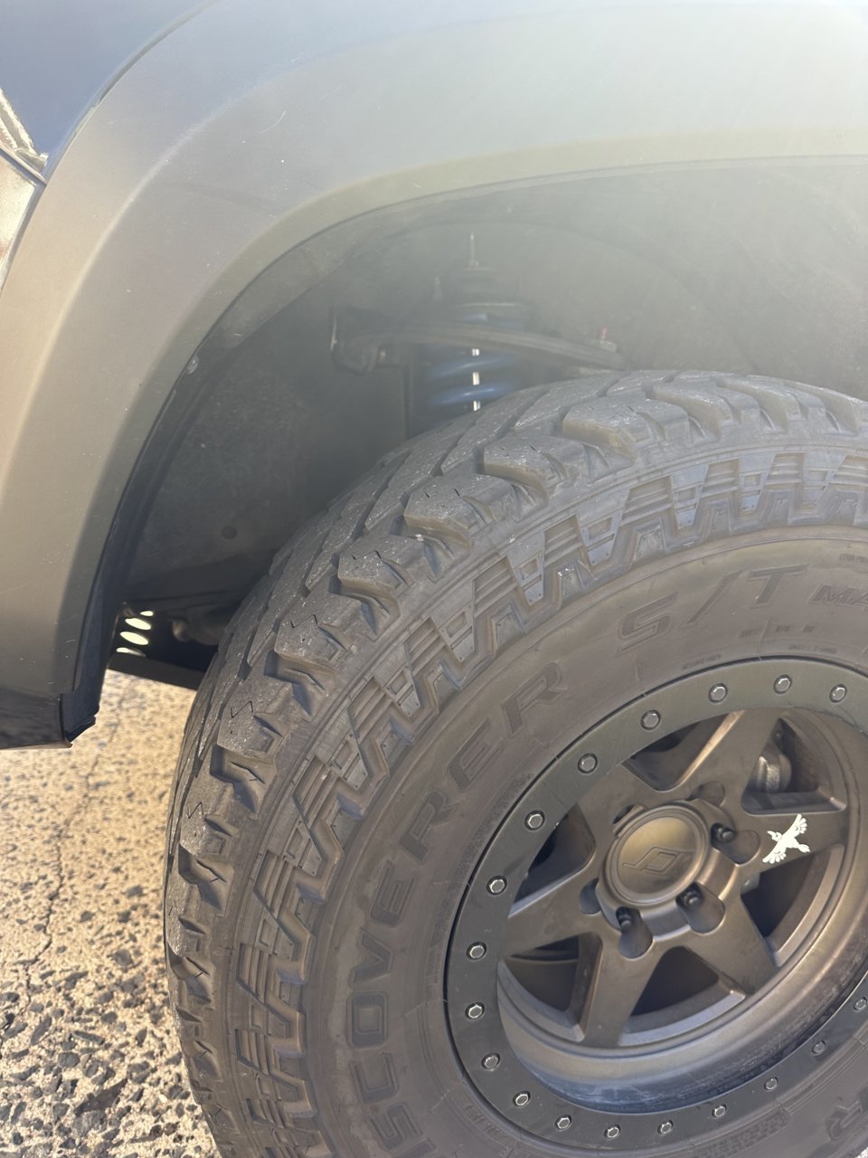

  13. Feb 6, 2023 at 4:57 PM
    #2533
    steelhd
    steelhd Well-Known Member
    Dec 15, 2013
    #118650
    3,523
    Eastern WA
    2011 DCSB TRD OR
    AFAIK 2" is as high as ya want to go to protect the CVs.

  18. Feb 10, 2023 at 9:36 AM
    #2538
    hyrule_trd
    Jan 26, 2020
    #317260
    10,113
    Eric
    Harford County, MD
    2020 Black TRD OR
    After about 1.5 hours I got the springs swapped out! Bad news, I couldn’t break the lock nuts loose so the height isn’t where I want it.
    Good news is I think it has more of a plush ride. I’ll know once my wife or kid rides withme. No noticeable dip or lean during turns.
    Bad news, when I swapped the springs last time, I buggered up some of the bushings. I’ll get new ones to swap out soon. I need to pb blast the lock nuts to break them free. I don’t think wd40 will be enough.
  19. Feb 15, 2023 at 3:22 PM
    #2539
    hyrule_trd
    Jan 26, 2020
    #317260
    10,113
    Eric
    Harford County, MD
    2020 Black TRD OR
    Cool fact I learned today. The lock rings have a slot on them with an extra lock screw. On the seat portion of the nut. I’ll take a pick tomorrow when I pull mine apart again to try and raise the spring seat lock nuts.
  20. Feb 16, 2023 at 7:35 AM
    #2540
    JFriday1
    JFriday1 Well-Known Member
    Jan 14, 2019
    #279318
    698
    Jesse
    Lakewood, CO
    19 Taco TRD-Sport, 16 4Runner
    Mobile Mechanic in Denver Instagram - "Jfriday123"
    Correct there is a set screw that goes from bottom to top and other set screws that go in towards the threads. I usually just leave one set screw in towards the threads only.
