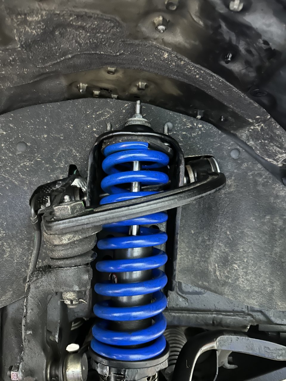

    I’d not used those set screws as a locking device, only the side ones.
    Me too. Though that might even be too high with the Foam Cell Pros being valved stiffer. I will eventually go to a few other shops for a purpose built spring seat and not the make shift one I (poorly) cut with a hacksaw from wheel spacers.
    Hoping the pb blaster worked its magic overnight and I can adjust the passenger side upper lock nut. Once I get the height where I want it, alignment and ride feeling, I’ll post my review of the change.

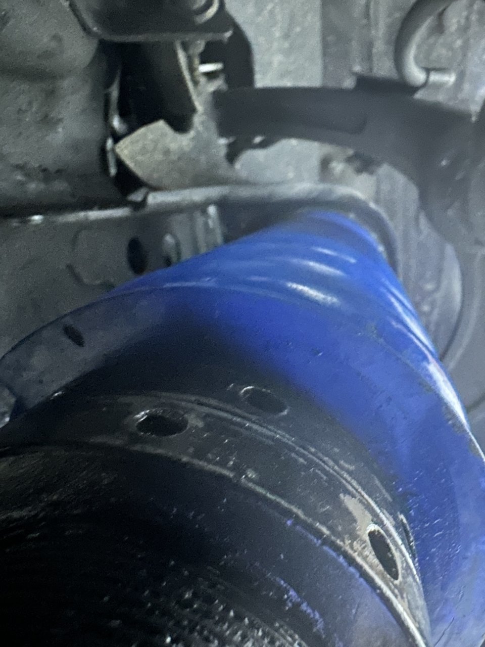

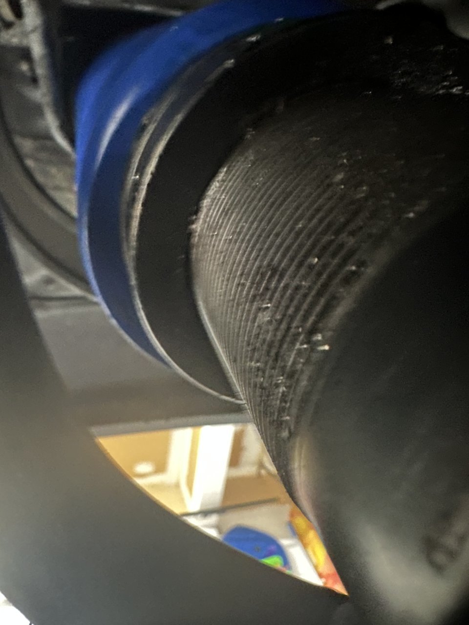

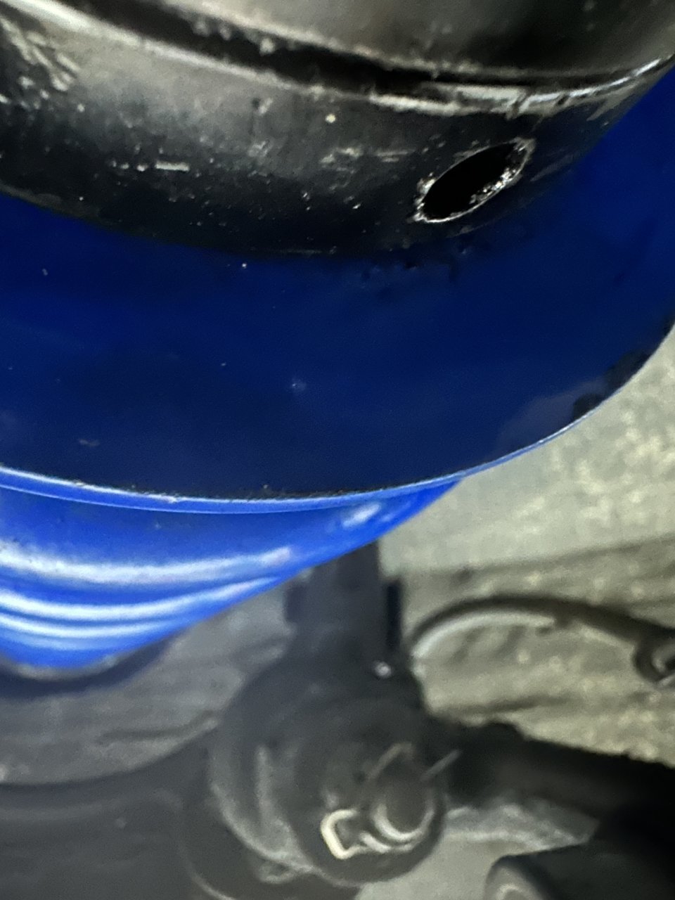

    It took a bit of straining but I eventually broke that but loose and everything set and back together.
    Just need a test drive and go over speed bump and it’ll be ready for an alignment if the height is good.
    the three bottom pictures are the spring sitting directly on the lock nut. I would not recommend doing that.

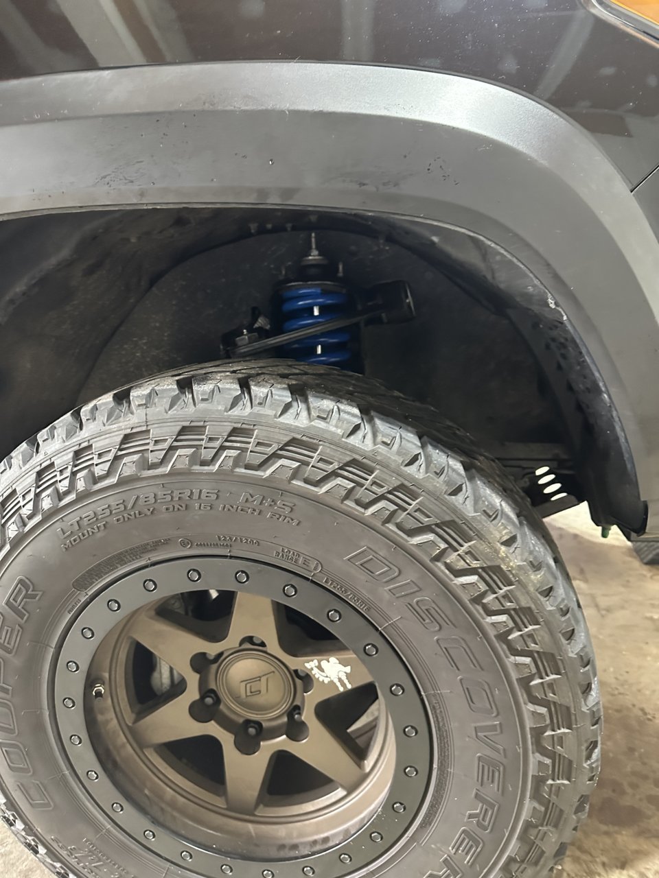

    Me again, I got a few miles on the springs and while I’m still waiting on the alignment, I’ll share my initial thoughts.
    I think the 650# springs are a huge improvement over the 720# springs. The truck feels smoother going over bumps and pot holes. It seems to even out quicker without the bounce back that it did have. If that makes sense. It’s slightly stiff but has a plush feel to it as well when going over speed humps. There is still no front end dip when braking or noticeable body rolls.
    I don’t have it set too high but with my current at home alignment, I couldn’t get the 255/75s to rub.

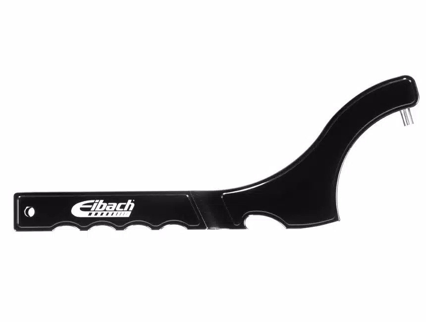

    I own the Ironman 4x4 front shock adjustment tool and it works ok for making adjustments on the shocks while installed on the truck.
    But, I recently picked up this Eibach adjustment tool for their stage 2 shocks and tried it on the ironman foam cells. It works much better. It fits perfectly on the shock collars and you can take a long 1/2" ratchet extension and plug it in to the end of the tool. It was a night and day difference for adjusting it while mounted on the truck. a little wd40 on the threads, make sure all of the set screws are out and crank away.
    hyrule_trd likes this.

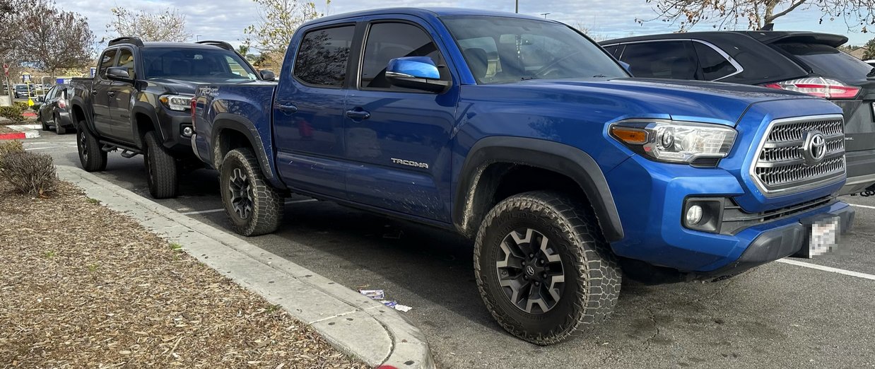

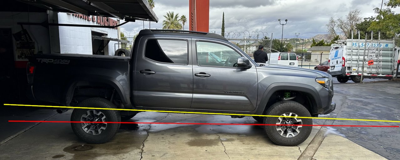

    Hey guys, been a while since I made this post...life intercedes, you know...anyway... We have a couple few thousand miles on the suspension now, just did an oil change so I think around 6K. The ride has remained consistent and I haven't really noticed any "settling". I ended up keeping it with the two leaves out of the rear, so the rear is at about the 1.5" higher point and I'm just going to live with it.
    I guess my beef with this whole thing is that it shouldn't matter that much if the springs add capacity to the overall GVWR...the lift is supposed to be 2.5", and out of the box the rear was 3.5" higher than the front with the 2.5"...that's 6" of lift and is ridiculous. I get what steelhd is saying, and yes, there should be some preload on them so when I throw weight in the back that the thing doesn't bottom out...that's what the stock springs did with not even 500lbs...but more than 3" of preload is pretty extreme.
    Here it was with the out-of-the-box kit...I'm surprised the slip yokes on the driveshaft didn't fall out driving to the alignment shop!
    I'm no spring engineer, but I understand that it's a complex balance with the number of leaves, progressive spring rates, increased arc for the lift, and then managing the ride quality between the laden and unladen weight of the vehicle, so perhaps it is what it is...whatever, we've taken a couple trips with four of us in the cab and about 500lbs of gear in the back and that rear height doesn't budge, but the on road ride quality is great! Even empty, the on road ride is as expected...a little stiff, but not rattling your fillings...and a thousand times better than the lame stock springs!!
    Not the best photo, but here it is with the leaves removed from the rear spring pack...this blue one happened to have parked in front of me, so I took this photo real quick, but you can kind of see that mine is now sitting fairly level...
    So overall, I feel the quality of the kit is good and I'm satisfied, but I do feel there could be some improvements. One thing for sure are the bolts on the spring straps...fortunately, I caught that bolt facing the wrong way and ready to gouge the gas tank when I did the install, but that seems to be a well-known and quite old problem that I feel they should have long since corrected in production by now.
    Now I'm itching to take this thing off road, despite the street tires, and see how it does!! I live in southern CA, and have spent a lot of years tooling around the west side of the Panamints in Death Valley...before they made it an NP and locked it down. I notice on current topos they've changed much of the BLM land to "wilderness", so I'm using my old topos from the 90's showing all the roads that Remi Nadeau built back in the late 1800's...but I digress...
    Thanks guys for the input, and hoping my experience here may help someone else in the future... -Rob

    Great write up Rob! The truck looks good your adjustments. Before…. Well that’s crazy lol.
