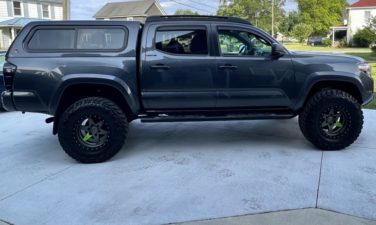

    What’s up TW! Just over a year since I originally posted in here with the FCP stage 2 Heavy coils and heavy constant leafs. Rear was about 3.5” higher than the front after initially installed. I pulled 3 & 5 from the leaf pack and after settling the truck sits with about a 1” difference between front and rear. I can live with that for now. I tried to make some adjustments on the front with the IM spanner wrench to level out the front but no luck with them still on the vehicle. Might try again when I have more time. IMG_0513.jpg

    Good looking truck!
    I was not able to use the IM spanner wrench while they were on the truck. i used the Gedore one listed in the products below. Someone posted another spanner, the Icon I think and said it worked well while they were on the truck. That’s a page or few back.

    Thanks @hyrule_trd! I might end up pulling them and getting a good spring compressor then make the adjustment. It’ll be a good reason to buy a new tool.
