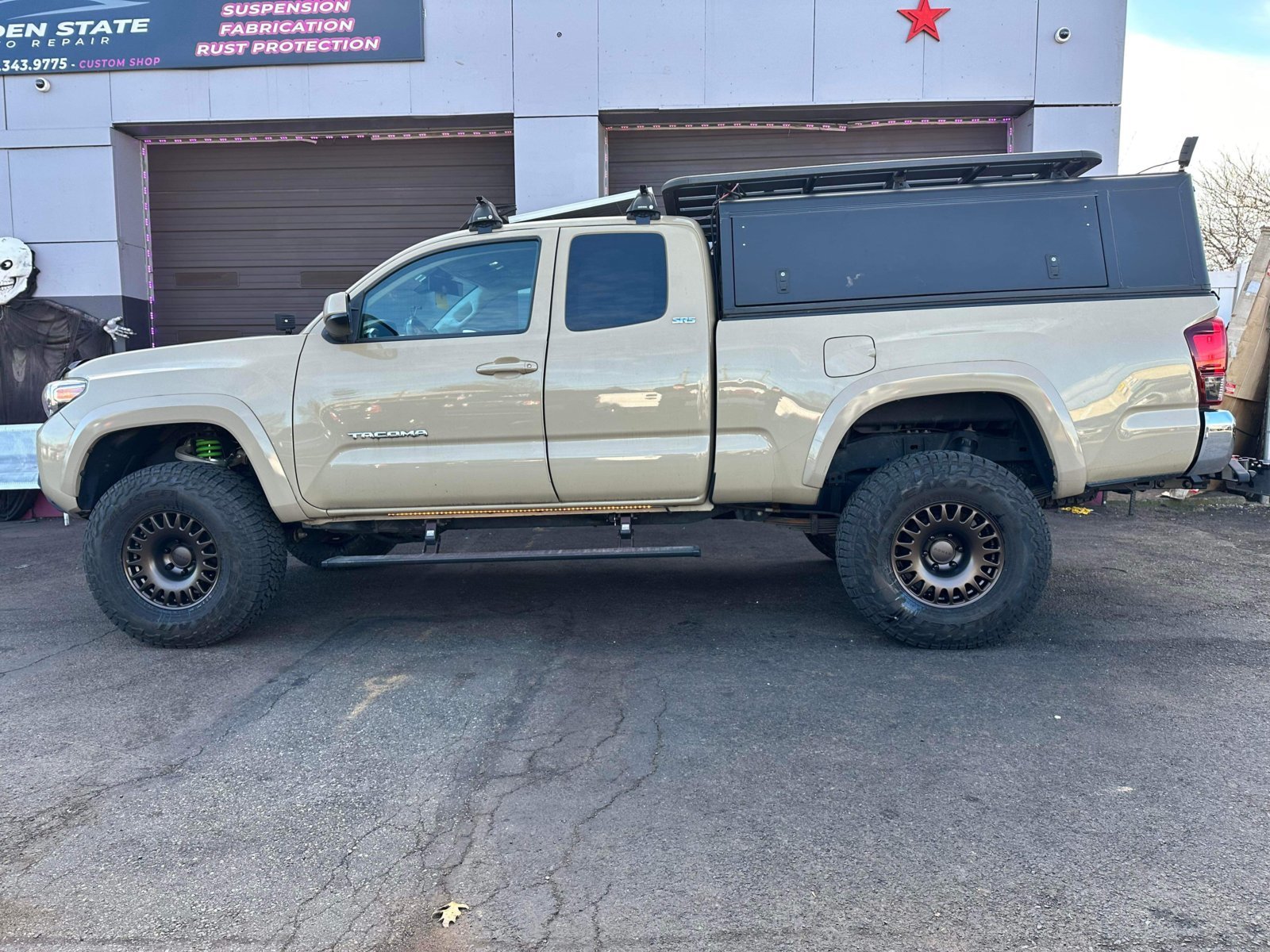

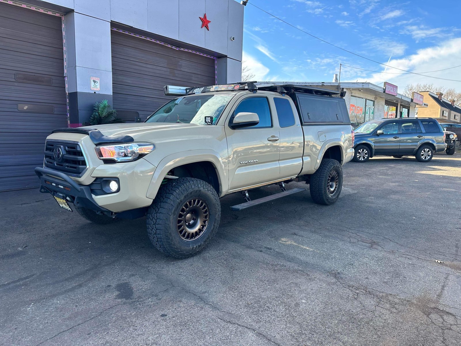

    Sway bar spacer, shaft spacer and no adjustments from date of purchase. CMC done from previous rubbing on a 16inch -38 fn wheels with 285/75/16 switch to nomad 16 -10 same tire size was able to eliminate vibs between 55-65 mph maybe due to offset of -38. 5.29 regear 2018 access cab sr5 4 banger LCE long tube headers OTT tune. Amp research step,Front bumper,full size spare,alucab canopy,lithium battery 100ah,65 dometic fridge ,roofrack, hitch bikerack,camping gears,15 water gallon tank, 100 watt solar panel. Now i just want to remove the 3rd leaf to soften and and drop the rear.Performance front and constant load rear installed 2 years now.

    Nice looking truck!
