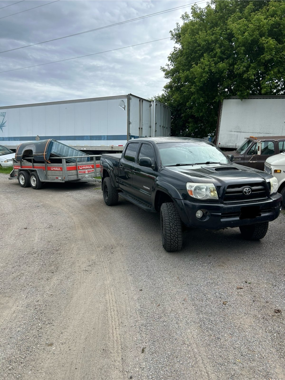

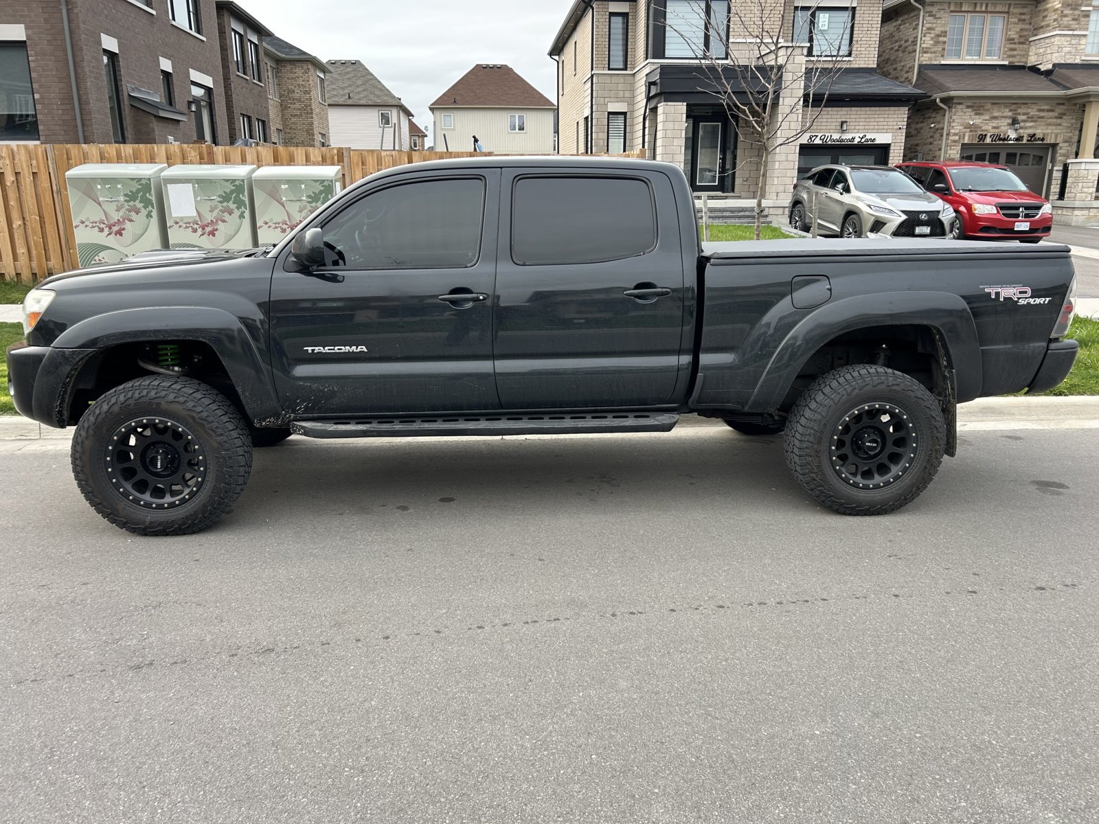

    Hey guys, I have a 2008 Tacoma trd sport DCLB. I’ve had the Ironman foam cell pro lift on for a few months now. I’m loving it. I got the dynamic/performance leafs and the 3” 720a coils. When I first installed the kit, it was 4” of lift in the rear and 4.5” of lift in the front.
    A few months later it sits 4” in the rear still and now 4” in the front. Drives great on the highway. I really love the visual look too but it’s a tad jarring going over roundabout bumps or speed bumps. How much do you guys recommend I lower it? Or should I wait for my 150 lb front bumper to come and see how I like the ride then?

    That seems like a lot of lift! Any pics?
    If it’s not going to be long, wait for your bumper. Maybe throw a bag of sand or gravel in the bed and see if that helps.
    I also think the lift is a little jarring. Was the lift set at that height from IM?

    Yeah it definitely is lots of lift! Here’s some pictures. I can try and get some better ones. I’ll throw a bag of sand in there for now. Trying to get a camper shell and bumper on there before the year is out so I don’t have to mess around with the suspension.
    I’m also thinking of getting some wheelers super bumps for front and rear to help out a bit around town. I purchased through cap-it which is a Canadian company. I think they just buy from IM and resale so I’m assuming yes it was set like this by IM.

    The truck looks great! I’m sure the cvs are struggling a bit lol. With that much lift you might eat through the cv boots quick.
    You might want to check and see if they’re set right but there is nothing you can do about the back besides remove a leaf. If you lower the front then you’ll have more rake.
