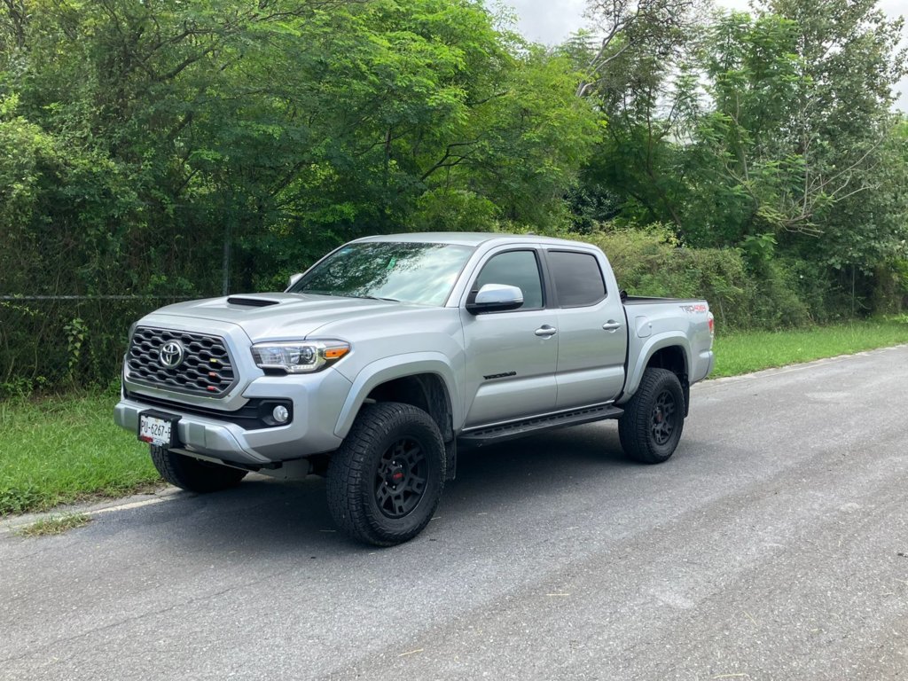

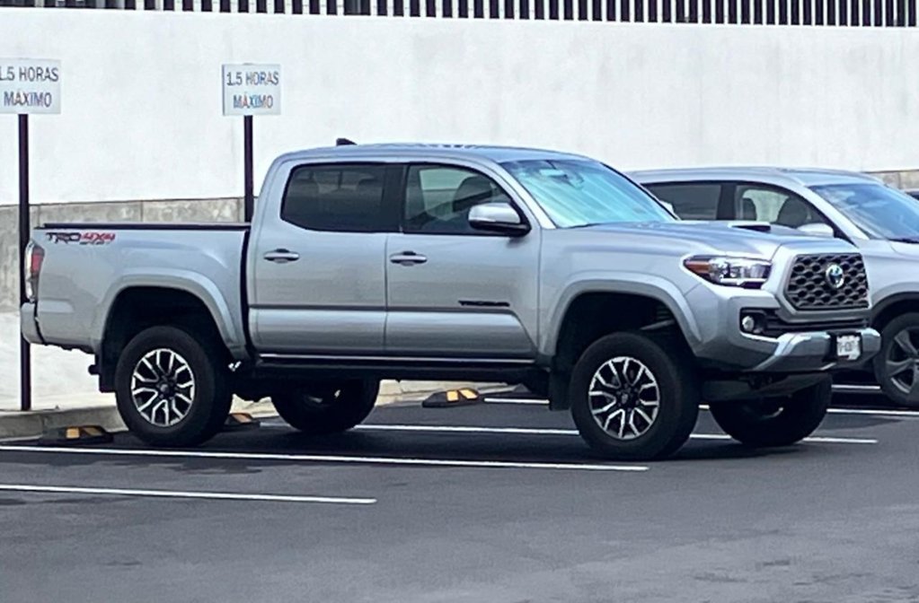

    Finally, I have the lift kit installed. It feels more precise but slightly on the firmer side... not bad. I'm waiting for the tires, but I like the stance and the way it drives

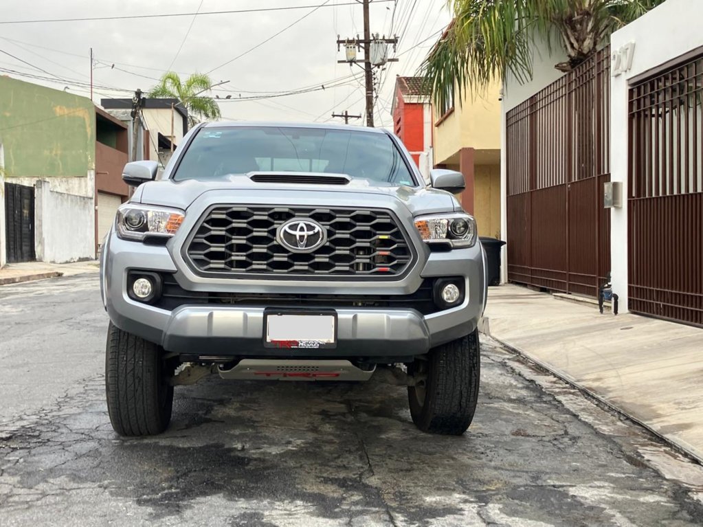

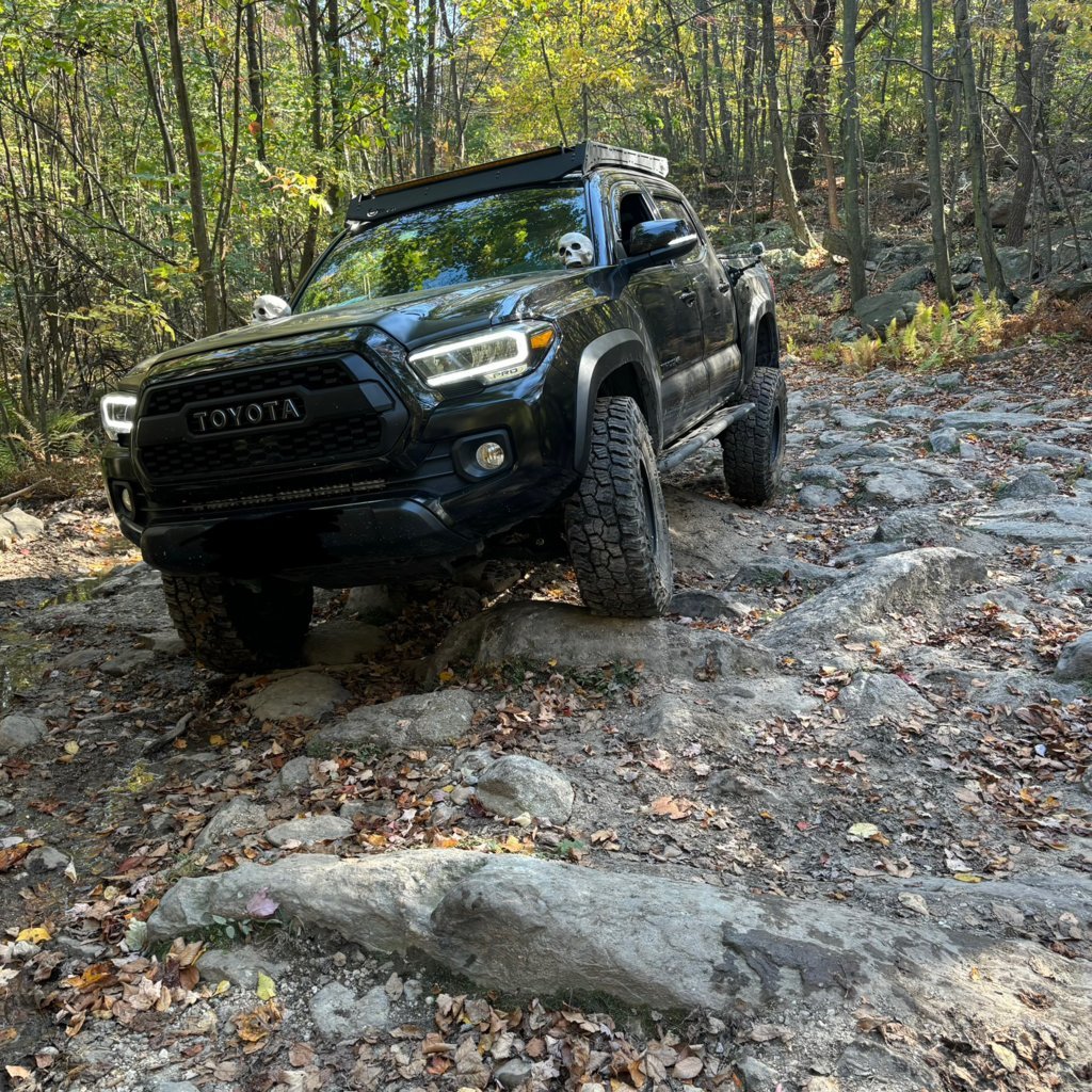

    I did go to the 265/70R17... It is my daily drive ... so It keep the same Power, the same MPG, and it does drive great

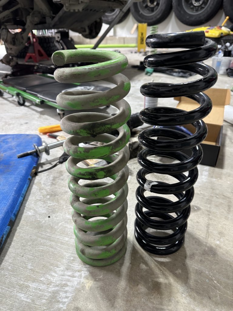

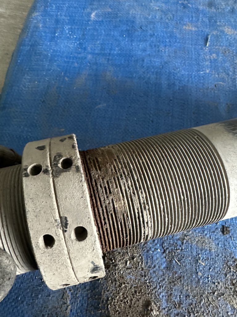

    Well, after getting a set of OME 2886x springs off fb marketplace for $30 I swapped them over.
    They are the 660# set of springs and 402mm vs the Ironman 720# and 390mm.
    A few notes, the OME do fit but it’s a close fit. There was a lot of rust and dirt built up on the threads under the spring seat. I spent a bunch of time cleaning and then sprayed woolwax on the threads and under where the spring seat is. Also the inside and bottom of the seat.
    I was set at about 2.5” of lift before the swap. Right not, with only going off the curb and a few sudden stops I’m at 3” lift. Hoping it’ll settle more, I don’t feel like lowering the springs.
    I’ll update with a review after some time on them.

    Another member got me interested in it again then I saw a set of springs for $30 and thought, that I already needed an alignment, so what’s a couple hours of work.
    Actually glad I did and cleaned those threads and all. Plus the passenger side isolater was cracked and causing squeaks. Had to take shit apart for that too.
    I do need to decide if I want to lower it a bit more but I got a few days of driving to see.
    Hope all is well!

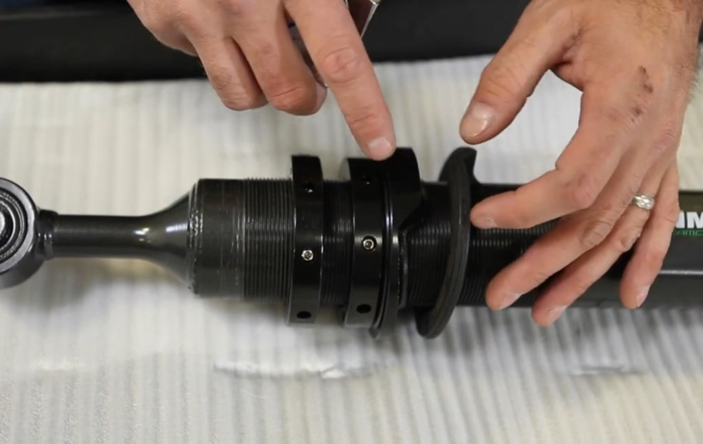

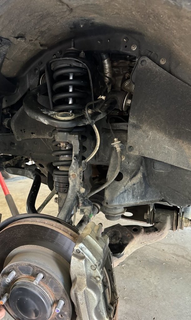

    I’ll let you know if I notice anything. I should have taken more pics of it but was trying to get things done.
    I did take a quick look and don’t think it should be able to move. There is a lip on the inside of the spring seat and rubber isolator. I grabbed these pics from the IM build video.
    Kind of tough to tell in the pics but they can be seen. Theoretically they should prevent the springs from contacting the threaded part of the shock body.

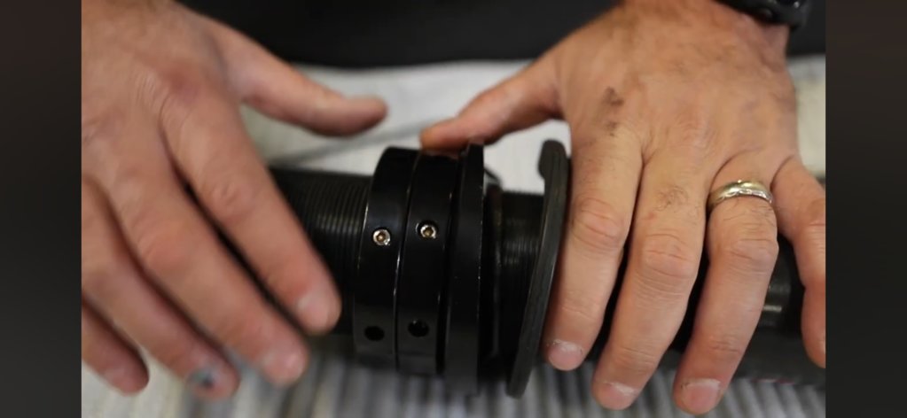

    Hey guys, I’ve chimed in on this thread before. I have foam cell pros. But wanted to share what I found out about tonight scrolling. Ironman is releasing a new shock series that is a monotube and has black springs instead of green!
    I do like the green but I know some of you don’t. I read on a YouTube comment from the official Ironman international channel that said they are designed to be more comfortable then the foam cell pros and if I read right, will be replacing them. Here’s a picture of the kit:

    no problem, they look sweet. I would upgrade to just the shocks depending on price and if they make any difference.
