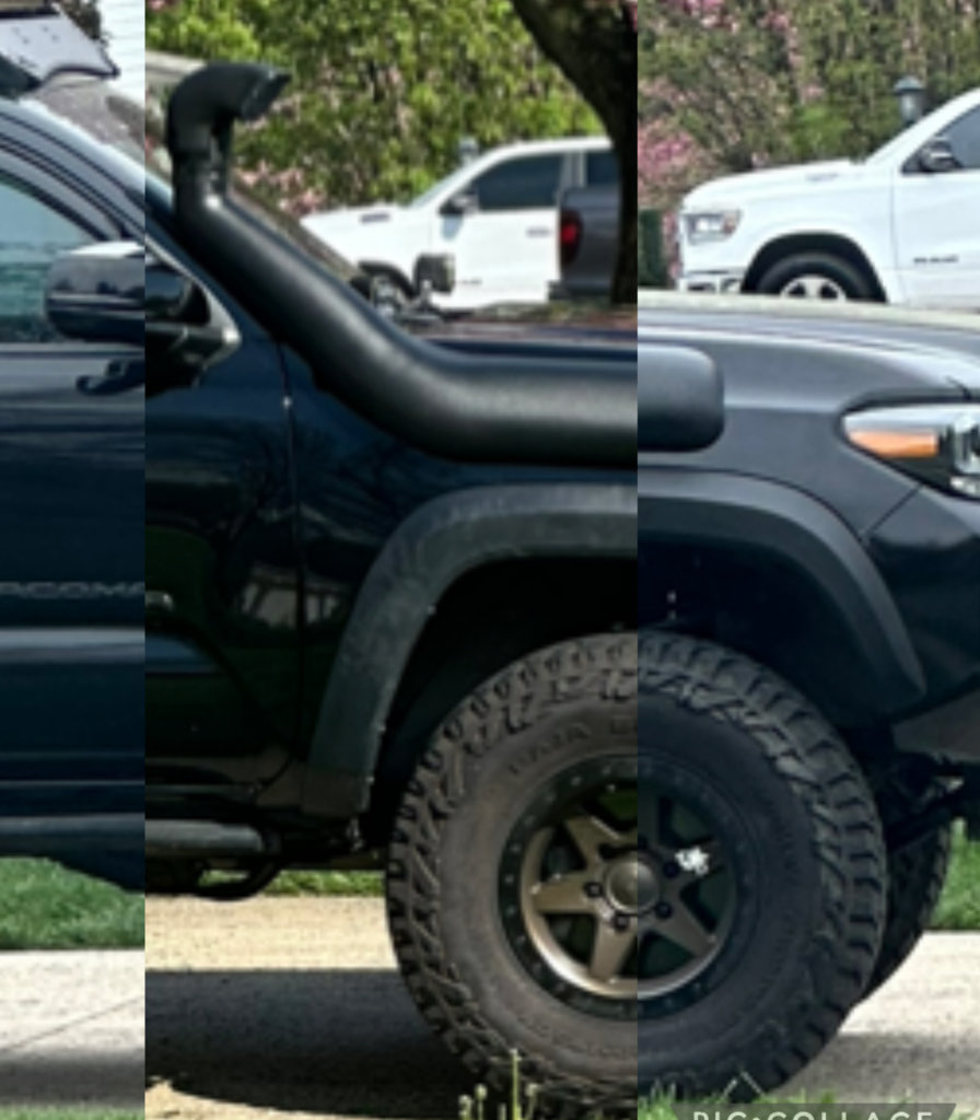

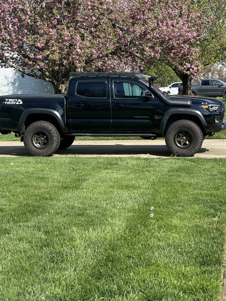

    After 4 hours of fighting earlier today, I was able to lower both sides about 1/2” for a total of 1” drop. I didn’t measure the truck on the ground when I got home since it’s parked on a slant and I’m not sure the reading would be fully accurate. I was still unable to get spring compressors to fit with them installed so I took as much pressure as I could without removing the top nut. I did unbolt the LCA to wheel up to let it drop more.
    There is some rubbing on the plastic and I must have missed an attach point on the passenger fender liner.
    I will say, I think the ride has improved a lot, and at this time, I think I’m happy with it! I need an alignment. I still have lifetime at Firestone so against better judgement, I’m going to bring it there but wait with it and have them bring me back to make sure they don’t touch things they don’t need to.
    unless I swap out the suspension I don’t plan on doing anything elsewith it. No more adjustments.
    Oh yea, I installed a high air intake last weekend!
