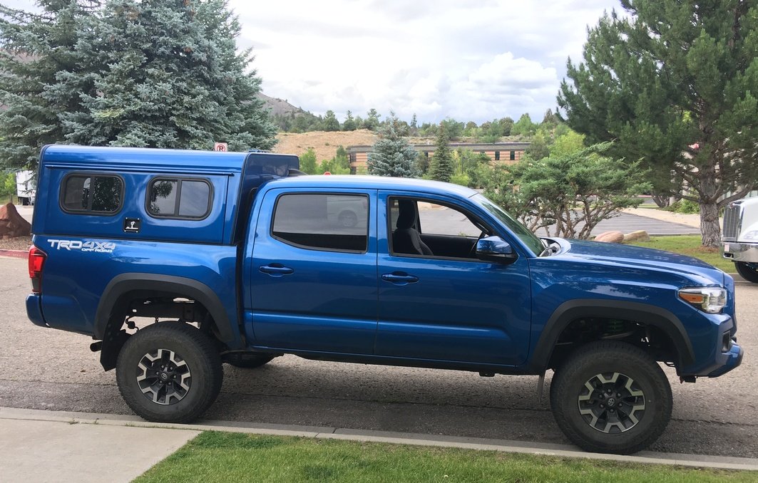

    Here’s the lift as it stands now. I just exchanged an email with Chris at Ironman, who says you can turn the Constant load pack into a Performance pack by removing the third leaf from the top.
    Debating whether I want to do that myself. After the initial install, I am about fed up with working on my truck with no shade in the dirt. I would kill for a garage.

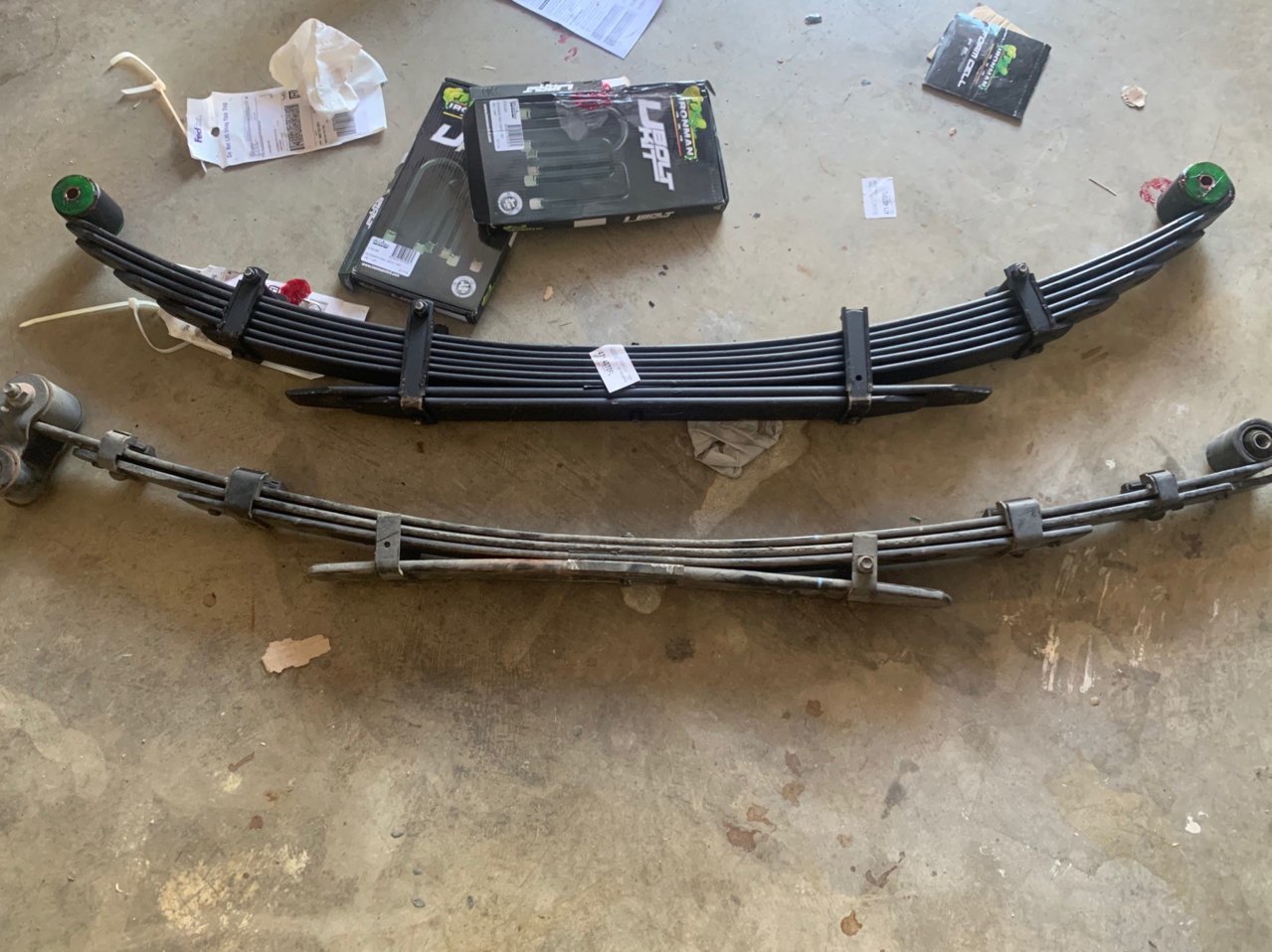

    The stage 2 comes with spacers that helps avoid driveline vibration. I ended up taking a leaf off (3rd leaf from the top) since it didn't need it to be that high so ended up with their Performance leaf in the rear. Unless you have a lot a lot of load, I'd recommend Performance. I have a Leer Camper shell, Prinsu rack, sliders and an additional 100 lbs in the bed (mostly a bunch of junk)
    Taking the leaf pack apart wasn't as bad i thought it would be. Just make sure you have pair of sick a$$ C clamps and you're good.
    Here's a reference for how many leaves you get for constant load. Performance is one less. I suggest you count the number of leaves and compare it to other brands and see their load rating and recommendation. Going from Constant to Performance it came down about 3/4". From the center of wheel to wheel well I currently measure about 25.5"

    Little update, the leaf springs showed up as well as the traction boards. I know I'm in a Nissan Frontier but I'll still post some measurements and pics after I get it installed.

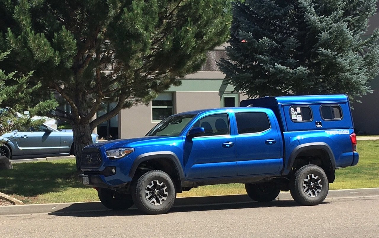

    Had the third from top leaf removed today. It's a night and day difference in ride quality: it went from unbearably stiff and skittering around on hard turns, to supple and incredibly grippy. The rear end feels more planted than it ever did, even when stock. Both the front and the rear ride is amazing. Went over some train tracks and the suspension just soaked it up.
    I'll get some measurements tomorrow. In the meantime, here's a pic of the final configuration.

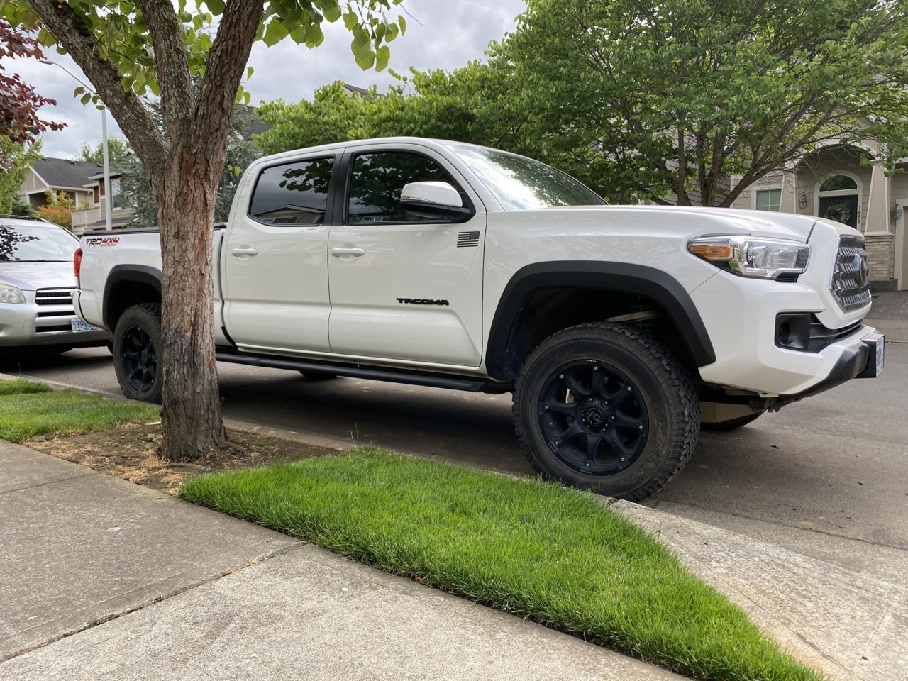

    I can never get a picture to do justice for the truck. But here is the final height.

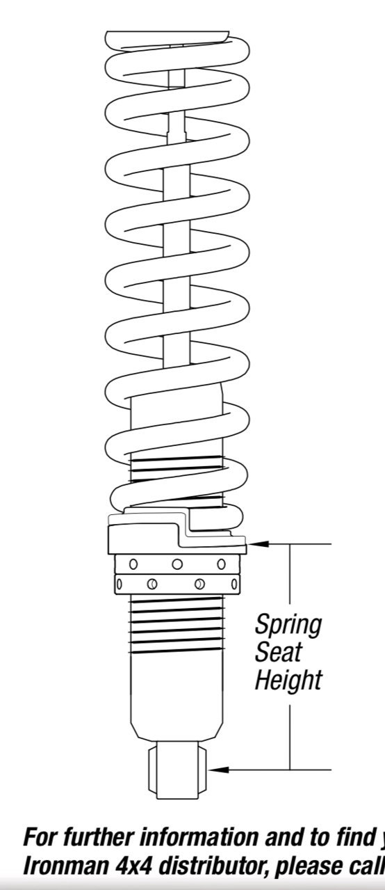

    What did people set their “Spring Seat Height” to ? 269A77DC-F094-4840-A1AF-748DD30C4EFD.jpg
