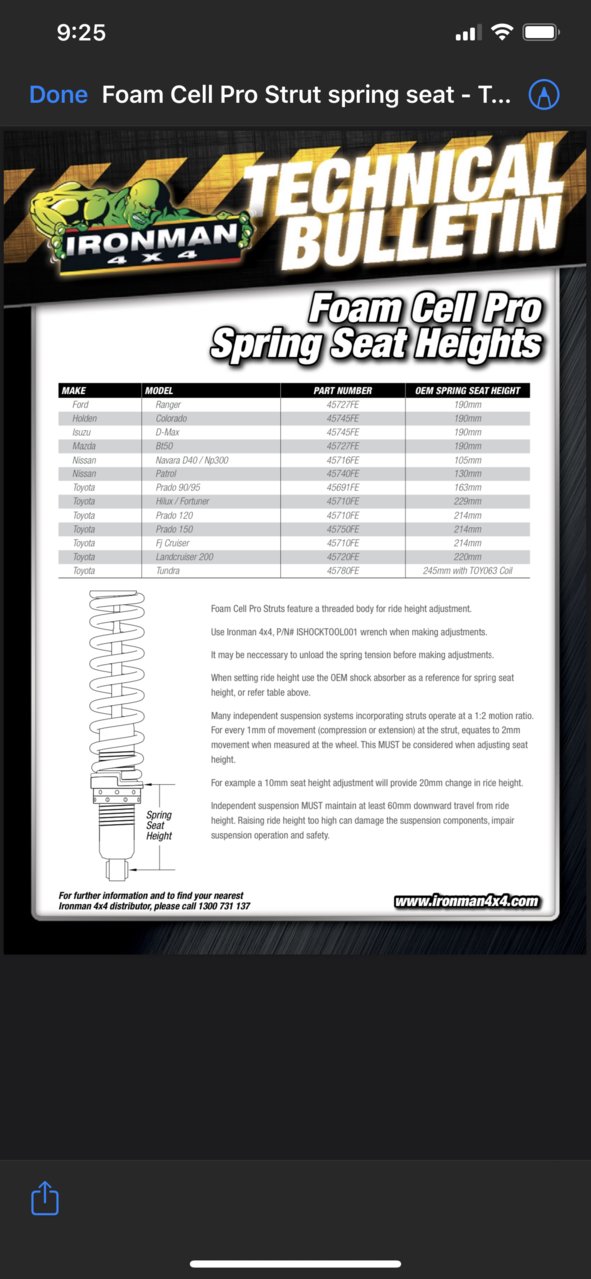

    That might not be a bad idea. Once for pics and info. Here is their flyer for OEM height setting.

    How to convert millimeters to inches
    1 millimeter is equal to 0.03937007874 inches:
    1mm = (1/25.4)″ = 0.03937007874″

    When I got that they said base it on the Hilux, but that may be obvious.
    Ordered the FCP stage 1 with unbuilt coils this morning! I’ll build them myself and plan on setting them at 260mm drivers side and 255 mm for the passenger side. Should give me about 2” of lift upfront and account for the taco lean.
