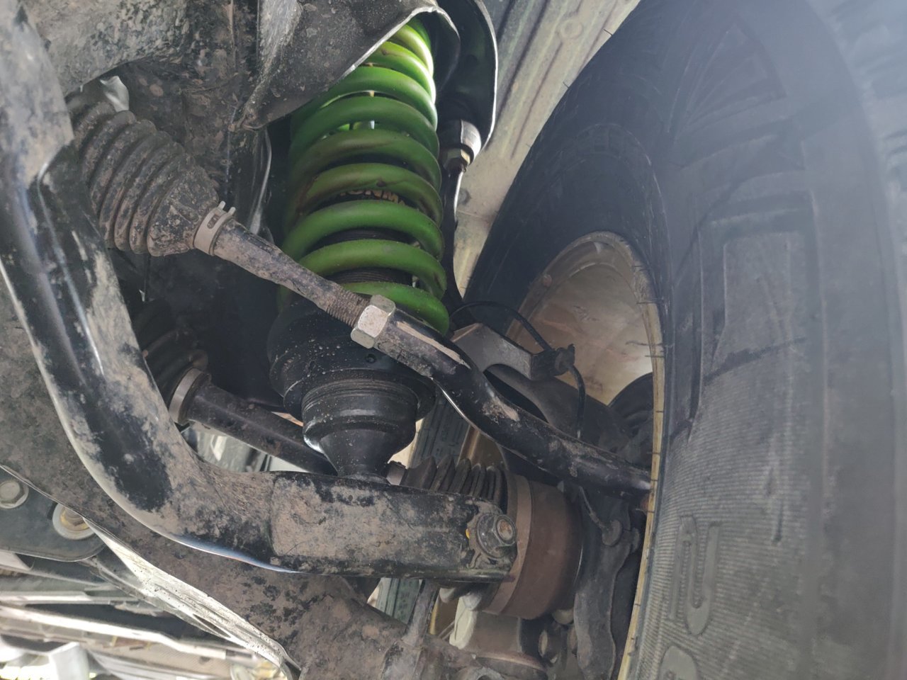

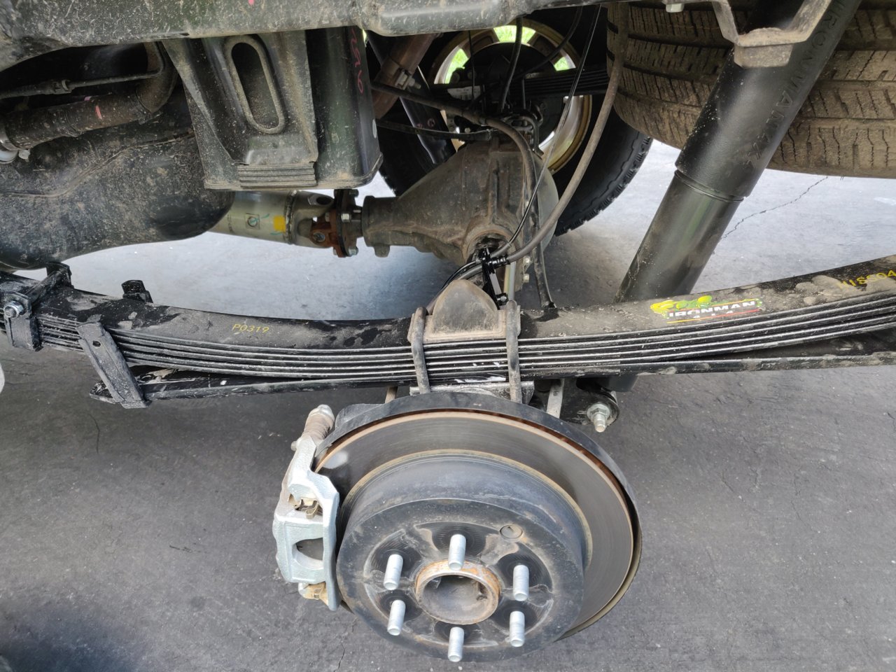

    You know, you would think I would have done that. But I didn't :anonymous: I do have a picture showing the coilover and then the rear suspension though. The foam cell pros are beefy stuff.

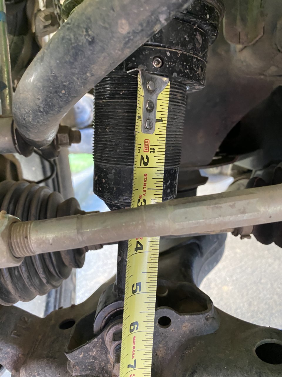

    Curious if any of you third gen guys took this measurement after install? 5683BFFF-1AFA-47AA-AD19-5A1953B34068.jpg

    Did you ever end up lowering yours some or are you still at 3.5 in high the front?

    I think I’m closer to an 1.5 up front. Although the shop told me I’m at 3” even.

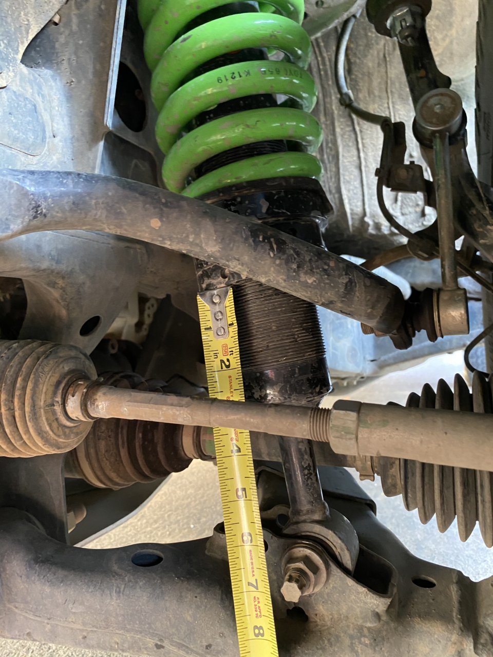

    7”+ 1 3/8” = 8 3/8” for spring seat height
    this should be closer to stock height

    I’ll add my numbers shortly. But I’m at a loss. Comparing you guys to mine. Numbers are all over the board. I have no clue how much above stock I truly am. Passenger rear was 23.5” passenger front was 21.75. Full tank with sliders and roughly 150lbs accessories.
    I have performance front and rear.
