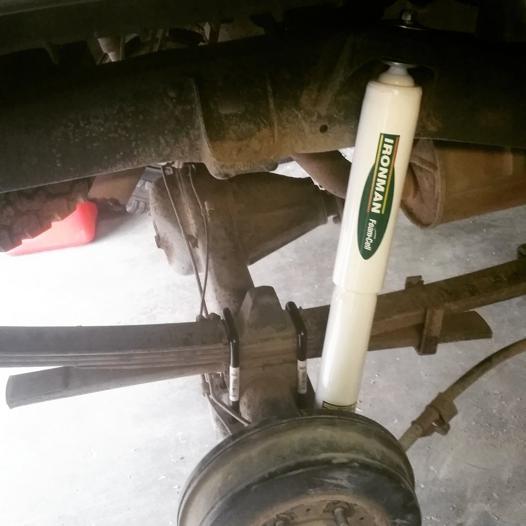

    09 Tacoma AC 2.7L 5spd 4x4
    I have foam cell shocks on the rear of my truck.. they're beefy AF.. and I've beat them hard since July last year, never skipped a beat. They've taken the 90kph Forrest road blasting, tough trails and daily driving I've thrown at them, the only thing I can complain about is my leafs suck

  14. Apr 22, 2016 at 3:47 PM
    #34
    Allstar780
    Allstar780 [OP] Well-Known Member
    Mar 5, 2015
    #150229
    867
    Colin
    Alberta, Canada
    15 TRD Trail Teams Sport
    3" Lift, 32" Goodyear Duratrac, XD Series Hoss Rims
    Ironman leafs?
    No toyota leafs with an aal something I need to change
