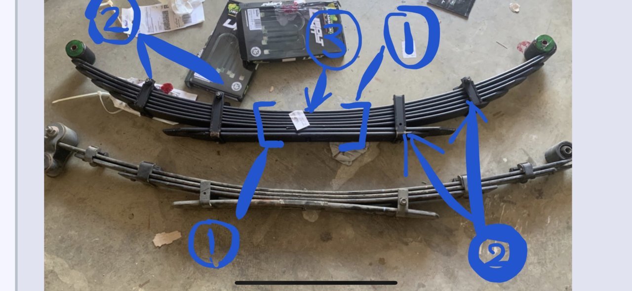

    oakcity
    oakcity Well-Known Member
    Jan 26, 2020
    #317343
    478
    Jesse
    Raleigh, North Carolina
    2009 Grey Tacoma AC 4x4
    Money Pit
    How do you remove the 3rd leaf? I see your explanation but is there a video somewhere of this?

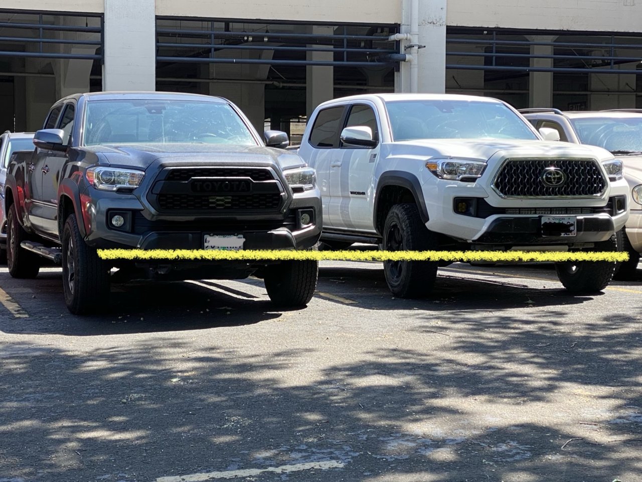

    Superhulk LB
    Superhulk LB Well-Known Member
    Mar 22, 2019
    #287595
    2,270
    Josh
    Oregon
    2019 superwhite DCLB off road
    Tonneau cover, Black exhaust tip, blacked out badges and tailgate lettering. Black rhino(glamis)18x9 wheels with +12 offset. LT265/70/18 Toyo Opencountry ATIII. Metaltech 4x4 rock sliders Cali Raised lower grill light bar/mounts TRD Pro Skid, DD Fogs(pro), Ironman 4x4 FC pro lift.
    Finally parked next to a stock Tacoma. Not the best comparison, but can clearly tell there is a difference between stock and what I am at. Not sure how many inches. But it was nice to see a side by side comparison. Didn’t see any indication the MG truck was lifted and tires are factory on it.

  6. Aug 11, 2020 at 1:30 PM
    #426
    hyrule_trd
    hyrule_trd It’s a Secret to Everybody
    Jan 26, 2020
    #317260
    10,016
    Eric
    Harford County, MD
    2020 Black TRD OR
    Ironman Stage 1 Foam Cell Pro lift kit, 255/85/16 Cooper ST Maxx, SCS BR6 Wheels, SPC UCA, Heated seats, MESO TRD start button, Meso Total Tail v1, Meso V5 mirror white DRL turns, bed decal, ditch and hidden bumper lights, screen protech, RAV4 radio knobs, steering wheel anytime camera kit, dash cam, ECGS bushing, Timbren Active Off Road bump stops with Wheelers flip kit. 35% Xpel CS Ceramic Tint, KD Max Tune, SumoSprings front bump stops, RRW Sliders ‌ ‌ ▲ ▲‌ ▲
    Looks good! I measured mine the other day, stock and from center caps got 20.5 drivers front, 20.75 passenger front and then 22 for rear both sides. I had a little over 3/4 tank of gas. Have and OR if that matters.

  7. Aug 11, 2020 at 1:34 PM
    #427
    Superhulk LB
    Mar 22, 2019
    #287595
    2,270
    Josh
    Oregon
    Thanks. I’ll double check mine. Seems if I was closer to those numbers up front, the the front is about 1” higher than stock.
    Assuming that for every inch of lift, the fenders move up an inch.
    hyrule_trd[QUOTED] likes this.
  8. Aug 11, 2020 at 1:39 PM
    #428
    hyrule_trd
    Jan 26, 2020
    #317260
    10,016
    Eric
    Harford County, MD
    2020 Black TRD OR
    I think I read for each mm of height above the oem seat height is 2mm of movement. I’d have to look at the sheet again. If that’s what your talking about.

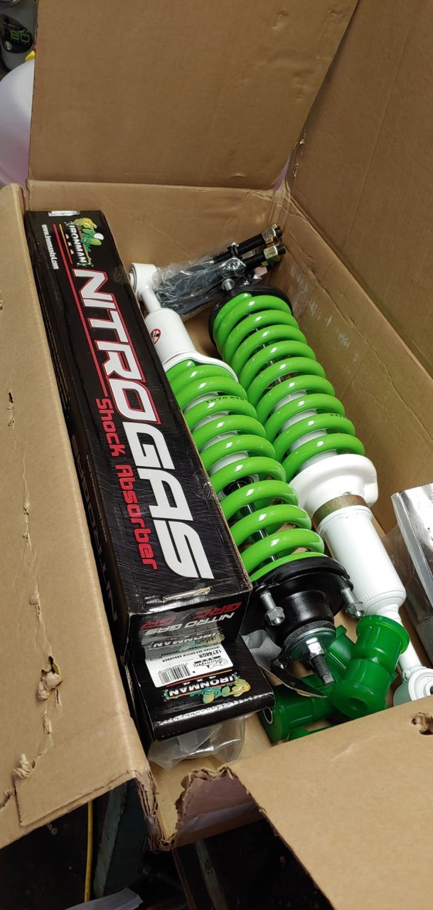

    DoVeR TaCo
    DoVeR TaCo Rather b lost in the woods then found in the city
    Jul 5, 2019
    #298340
    1,211
    Greg
    Dover Pa
    98 sunfire red SR5 extcab 4x4 MT, 99 4runner 4x4 now 09 SR Pyrite Mica 4x4 double cab
    0811201649.jpg 0811201649a.jpg not foam cell but took about 2 weeks to get to PA from OR. Now just gonna what for it to cool off to install

    Superhulk LB
    Mar 22, 2019
    #287595
    2,270
    Josh
    Oregon
    Sort of. I would assume that for every inch of lift at the coil, the fender should move up an inch too. So if it was a 3”lift the fender should be 3” higher than stock. Just not positive that is how it works. Seeing that the shop that installed my lift said it is set 3” above factory.

  18. Aug 11, 2020 at 8:52 PM
    #438
    roy326
    roy326 Well-Known Member
    Jan 18, 2017
    #207930
    324
    Roy
    Southern California
    2020 Tundra/V8 4Rnner/GX460. I do miss my tacoma
    1) clamp it so it doesn’t unroll on ya
    2) remove
    3) undue the nipple
    4) remove leaf 3 (counting from the top)
    Reverse 3-2-1 to put it back
    oakcity[QUOTED] likes this.
  19. Aug 12, 2020 at 2:47 AM
    #439
    oakcity
    Jan 26, 2020
    #317343
    478
    Jesse
    Money Pit
    Cool cool, forgive me but not trying to kill myself if I do this lol but you clamp it so it doesn’t unroll but you need to loosen the clamps a bit to pull the third one out? Is that correct?
  20. Aug 12, 2020 at 6:38 AM
    #440
    roy326
    Jan 18, 2017
    #207930
    324
    Roy
    Southern California
    Correct... you can remove the C clamp entirely when removing the 3rd leaf. Don’t worry the leaf aren’t like springs... they are to to assist in taking the nut off by reliving the stress on it.
