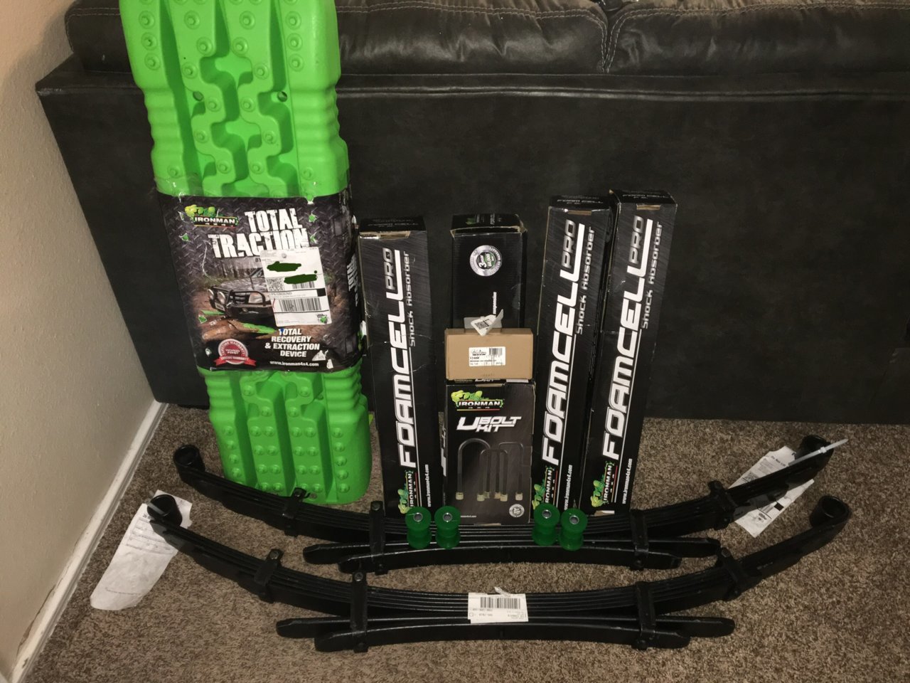

    Funny story....
    I had one of the customer service guys from Iron Man call me back today after a message that I left on Tuesday Asking if my order would be ready Wednesday... and I had to inform him that I had already picked up my order yesterday and then I informed them that their customer service sucks balls Again...
    he again said they they were growing so fast that they were short staffed because of the increase of business that they have gotten

    I JUST received everything tonight! Just a little salty my box didn’t come with any swag ): no stickers hat or kuzzi :annoyed:

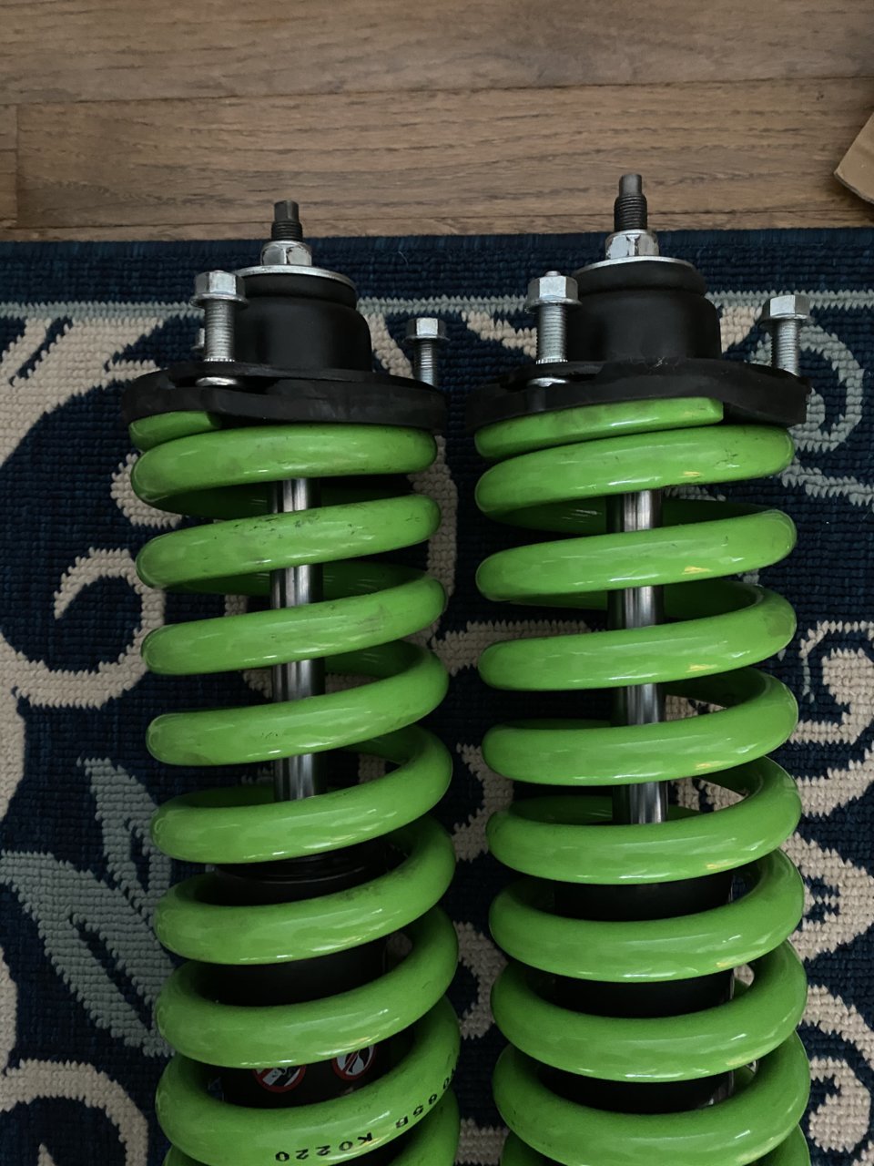

    Picked up my coils earlier. After getting them home I noticed the end of the spring it at the edge of the stud or right under it. I don’t think it’ll be an issue, it’s just not the way I would have done it. I’m debating on taking then back and asking nicely to compress and turn the spring some, try and unload it a little and spin while it’s on the truck or just live with it...

    That’s a tough call. I’d lean towards getting it turned while they’re still off the truck rather than dealing with it later.

    That is ironic considering in their video showing how to put together the coilovers he specifically says he likes to avoid that :bananadead:

    I’d be really annoyed if that was the case. I’m gonna grab the compressor from autozone that’s up the street, I might be able to get it compressed just enough to turn it without having to head back to the Toyota dealer. Rentals are free so that’s good.

    Also I’m trying get about a 3 inch lift in the front do y’all know how much thread i have to leave these at?

    I’m not sure we “really” know that yet, @roy326 started a spreadsheet that has some info. Measuring from center bolt hole to spring seat I was going to set mine at 8&7/8 for driver and 8&3/4 for passenger side. I’ll update once they are on and see what that gives me. I think my truck sits a little low compared to other truck, based on current height @ drivers 20&1/2 And passenger 20&3/4.
