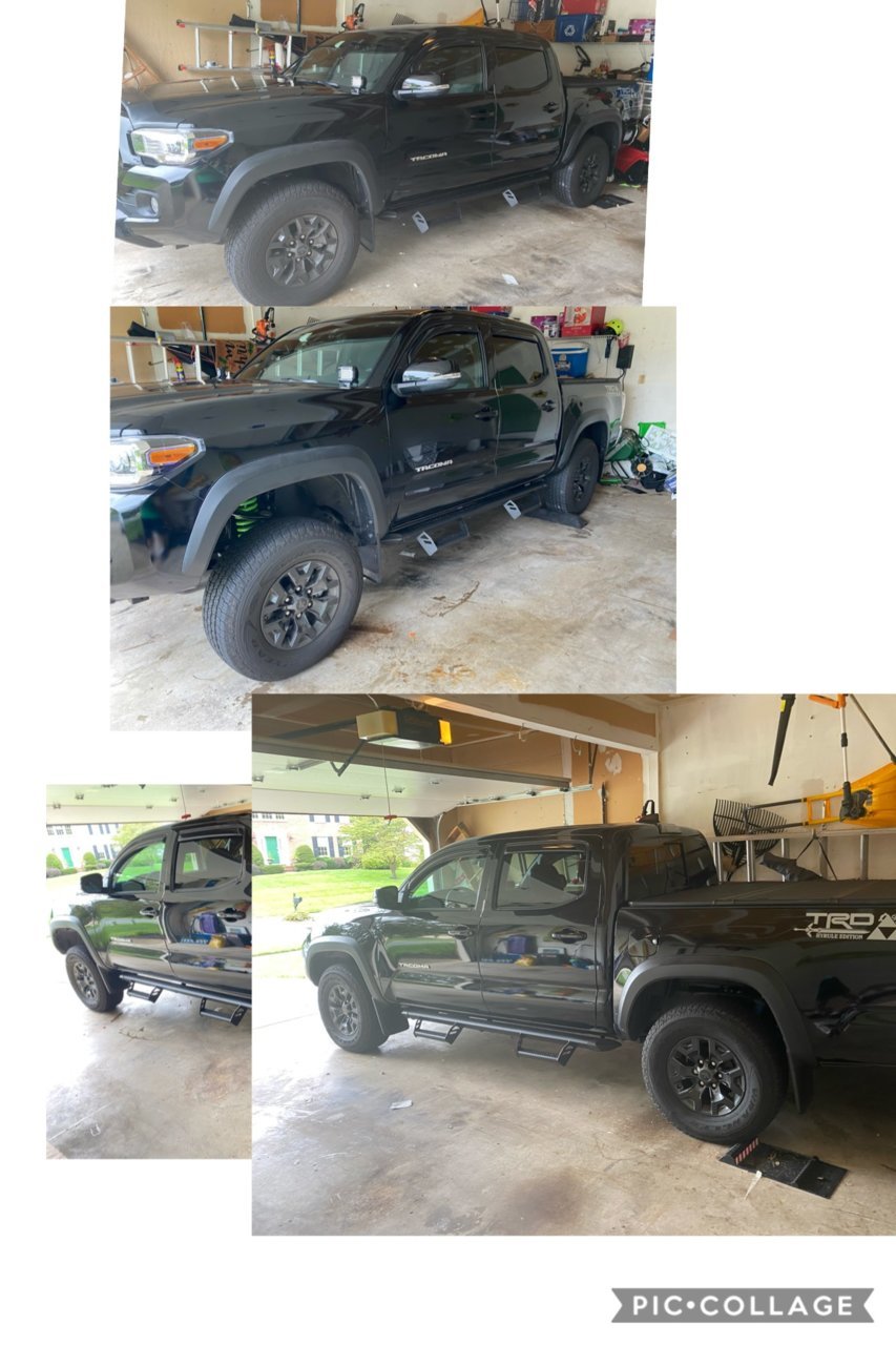

    Got the fronts on today, a little higher than I planned, I can’t math right, I’ll post some numbers after a bit of driving. There is a bit of squat but that’ll go away once I get the other leaf and it in. ECGS bushing also done today and now for a test drive.

    Went for a little drive, speed bumps and bumps, sudden stops and fast accelerations. The front feels good but the rear end takes away from it. The truck does not lurch forward/dip when I’m stopping unless it’s a sudden and even then it’s not much. After all of that my numbers are drivers side 23 1/2 and passengers side 23 3/4. I think it’s settle a little more once I get rid of the squat that’s going on now. Calling Ironman first thing when they open to get the new leafs on their way.
    ECGS install seems a success too, no weird sounds or grinding noises. No leaks noted yet either. Old needle bearing looked fine when I got it out.
