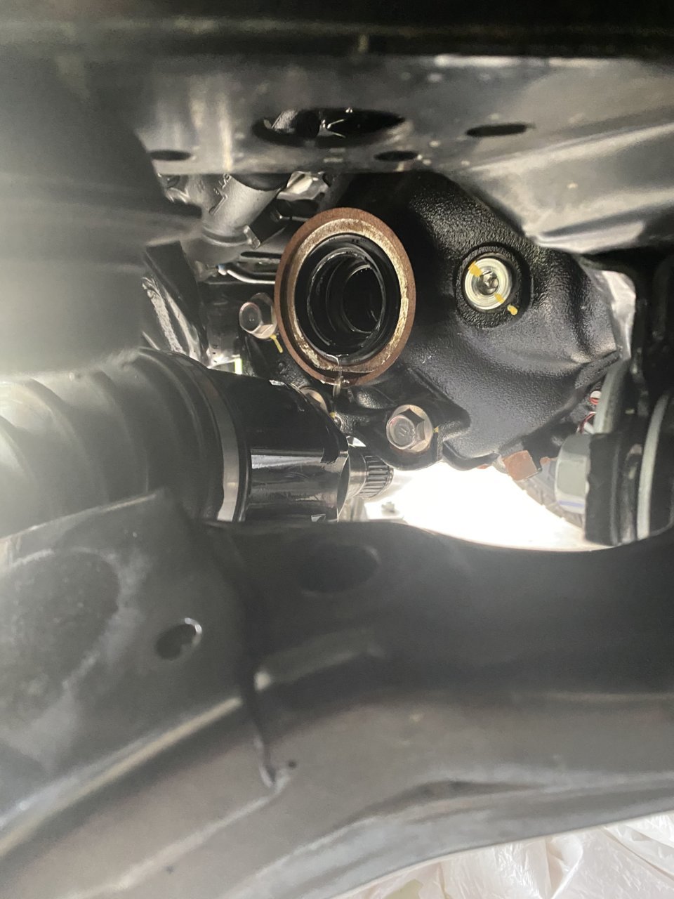

    Did you use a piece of pvc pipe or something to set the seal?

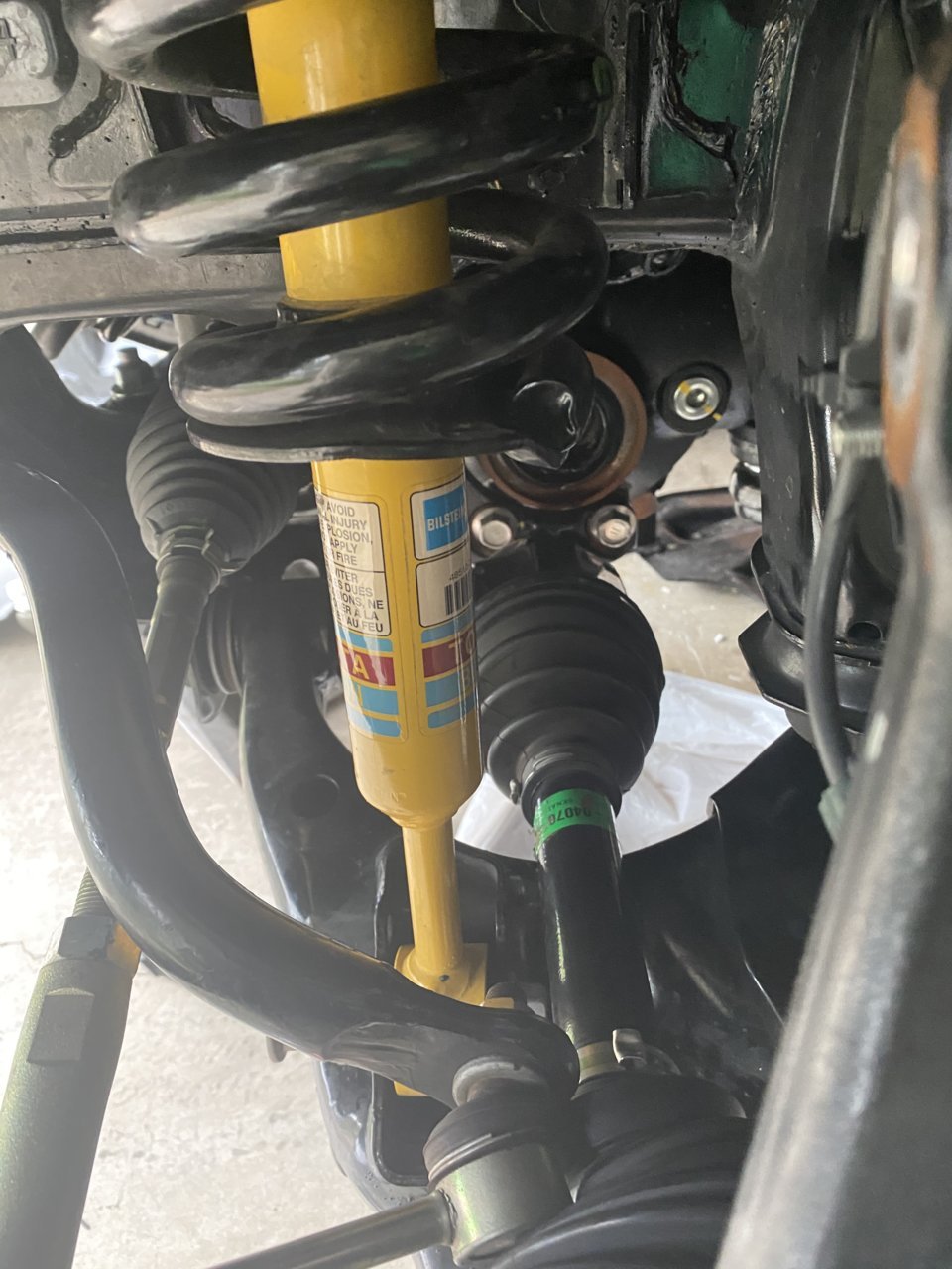

    I tried that at first and the piece I had just didn’t work. I ended up using a 27mm (I think) socket that came with a kit from Autozone that also had a 35mm socket, in case I needed to take off the hub nut.
    To remove the cv, and get the lift done, I only removed the wheel, the two bolt under on the knuckle on either side of the cotter pinned nut, and the swat bar. You don’t get a lot of room that way though. I lost about an oz or 2 of oil. There is a lot less room to work with though...

    Cool, yeah I am removing the hb and all, I have new wheel bearings and rotors and brakes, basically doing everything up front! I feel like I should order this clamshell bushing now :confused: since I'm doing all the other stuff, I only have 81k on my '09 so I doubt I really need to do the CVs
