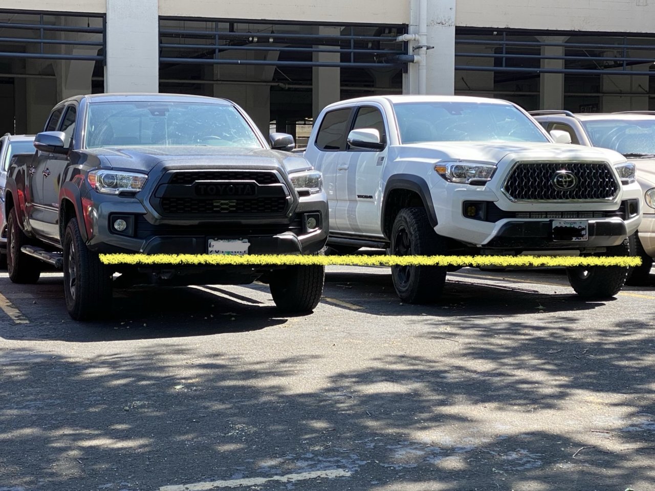

    21.75” front passenger and 23.5 rear passenger. The picture is next to a stock off road Tacoma.

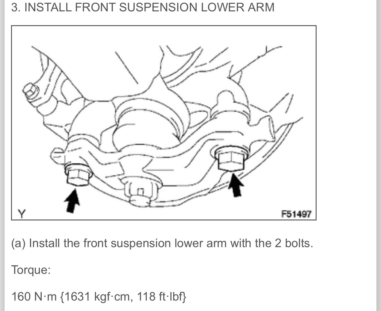

    Did you have to use a pickle fork or anything to separate stuff, I can’t think of the proper name haha or did you follow their video where they lessen stuff up and pop it with a dead blow hammer?

    Toyotas have spots you can hit to pop everything loose without damaging any of the tie rod ends or sway bar, balljoints unbolt. Shouldn't need a pickle fork unless its really seized up.

    Nope and for mine all I did was the sway bar connection that “could” have needed to be hit. I didn’t even need a hammer for that. I removed and added the sway bar spacers. You’ll see in these pics the only things I took out, besides the strut. I also marked and losened the LCA bolts so it could drop down enough to get the strut out. Didn't you get the stage 2? If you did you’ll have more to do up front then I did.
    Also, the IM struts with springs are much heavier than the oem stuff. I think he did a video showing the differences but actually handling them is crazy.
