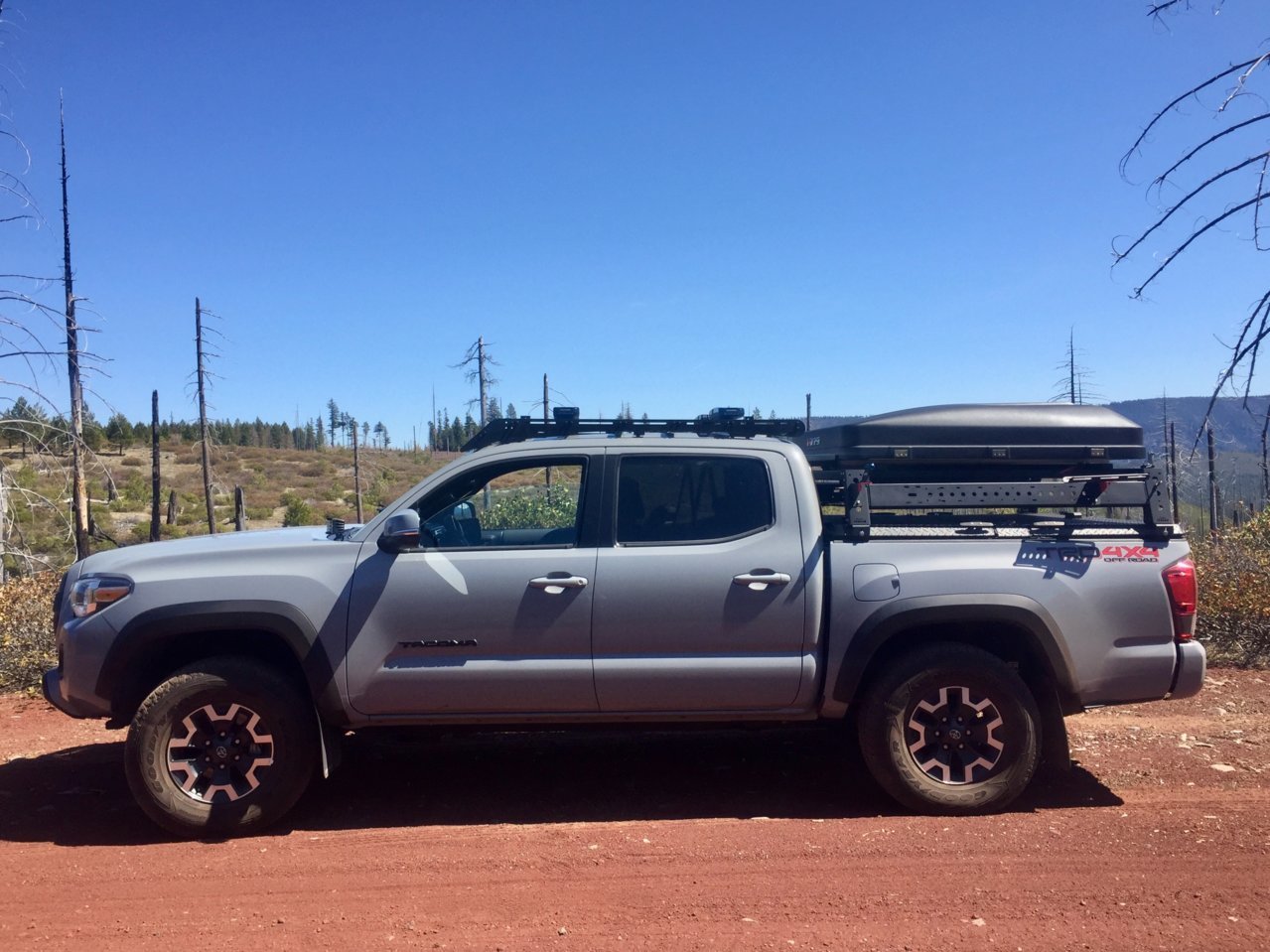

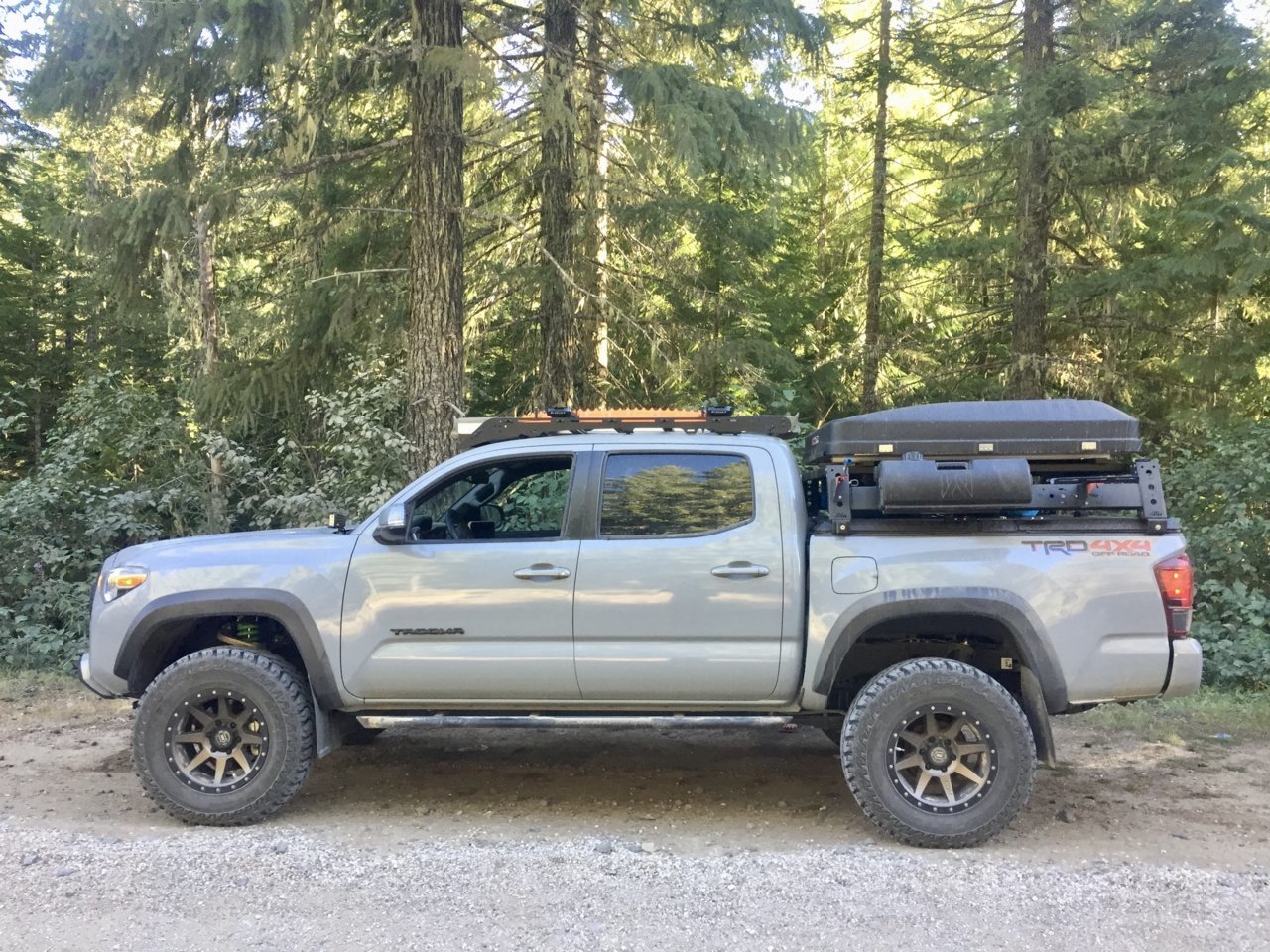

    Leaf spring comparison:
    1st pic: stock suspension and wheels
    2nd pic: IM FCP with Constant Load front and rear plus stock wheels
    3rd pic: IM FCP Constant Load front and rear with 3rd leaf removed on each side. Plus 17” wheels and 33” tires.
    Less rake and rear wheel gap. I think it drives & looks a bit more balanced than pic#2 set up.

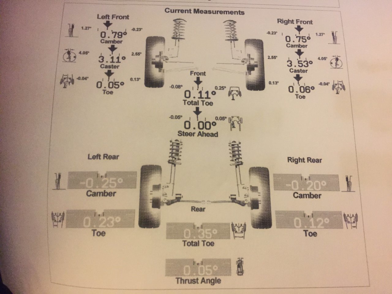

    Here’s the current alignment numbers:

    That 3rd pic looks real good!

    I took the extra leaf out of mine based on your experience and mine sits up a little not so bad like the 2nd pic. How ling did it take to settle? Should I go load some mulch in the back haha

    I forgot to measure before and after. Didn’t immediately notice a big cosmetic change after taking the 3rd leaf out. Maybe softened the rear a little more.
    It wasn’t until I loaded up for a camping trip that the visual difference was obvious. Rides a bit better loaded up. Haven’t hit bumpstops yet.
    If I hit a bit big bump or roll over a big pothole, it feels like the rear suspension rebounds a little to harshly and I get a big thunk. But I‘m typically going too fast when it happens.

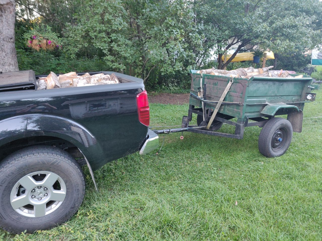

    Once again I know it's a frontier instead of a Tacoma but the foam cell pro suspension has been working good still. Towed a pop-up with bed loaded and now bed and trailer filled with wood.
