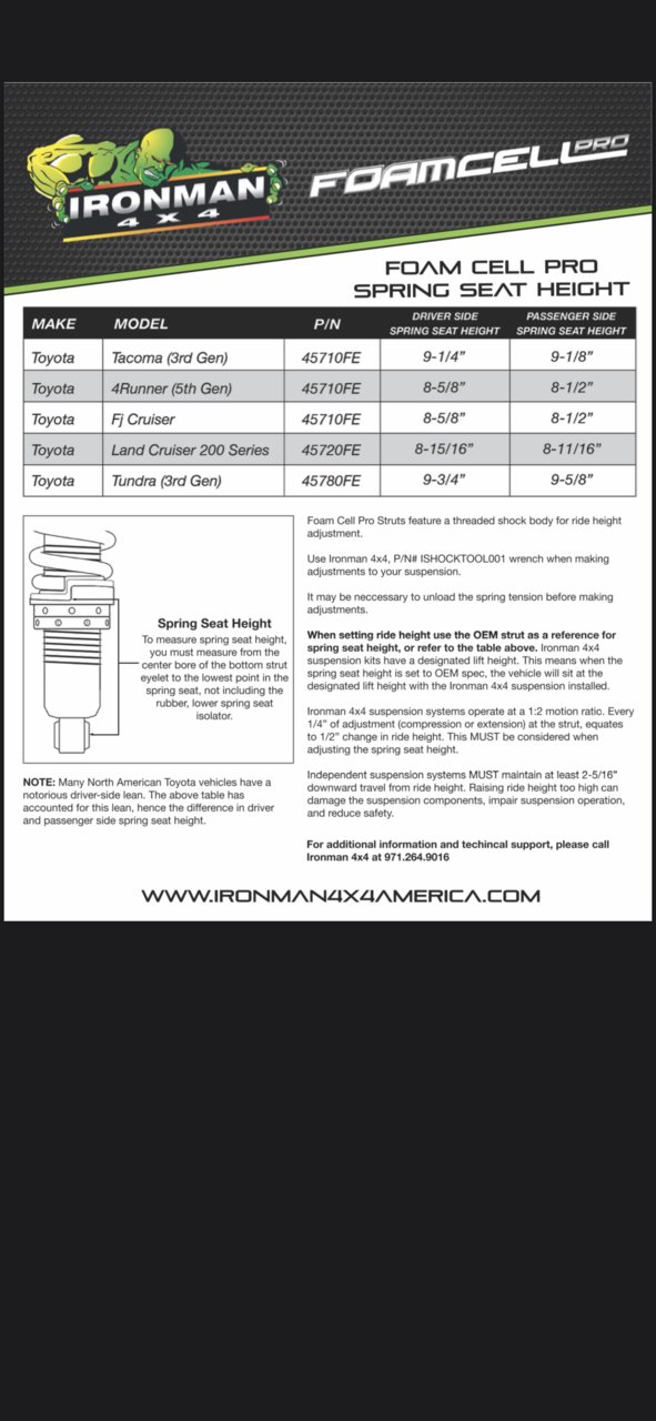

    Received this today. Helps save some math.

    i think that’s pretty close to what I set mine at. I need to jack up the front and double check the UCAs don’t hit the springs though.
    Edit- Jacked it up and UCAs don’t touch. Go to go!

    That confirmed I am far from being at a 2.5” lift. Mine is set at about 7.5”-8”. Now I need to convince the dealer.
