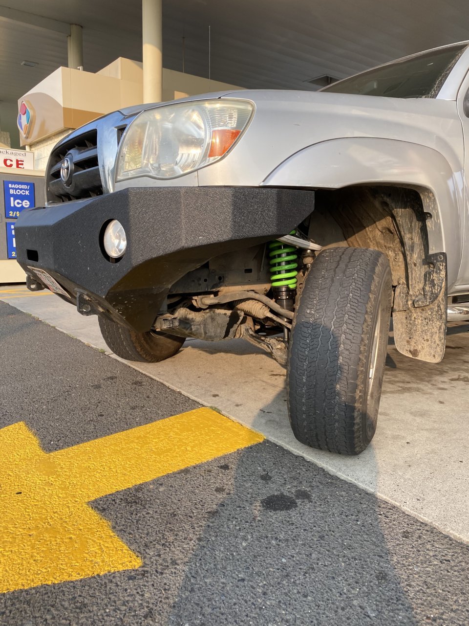

    Ok. Well here is an early early review after driving 250 miles over the weekend
    I’m really happy with the way my truck doesn’t dive anymore while hitting the brakes.
    It’s a smoother ride over bumps
    And it’s a nice ride heights.
    Something That is bothering me is I have a vibe I didn’t have before and I did the clamshell change at the same time so I’m gonna give it some more time before I say something... it’s not bad at all but I notice it after the install.
    I haven’t taken it off road yet so no insight on that yet. So far pretty pleased.

    Looks good. Like the bumper too. Definitely gives more room.

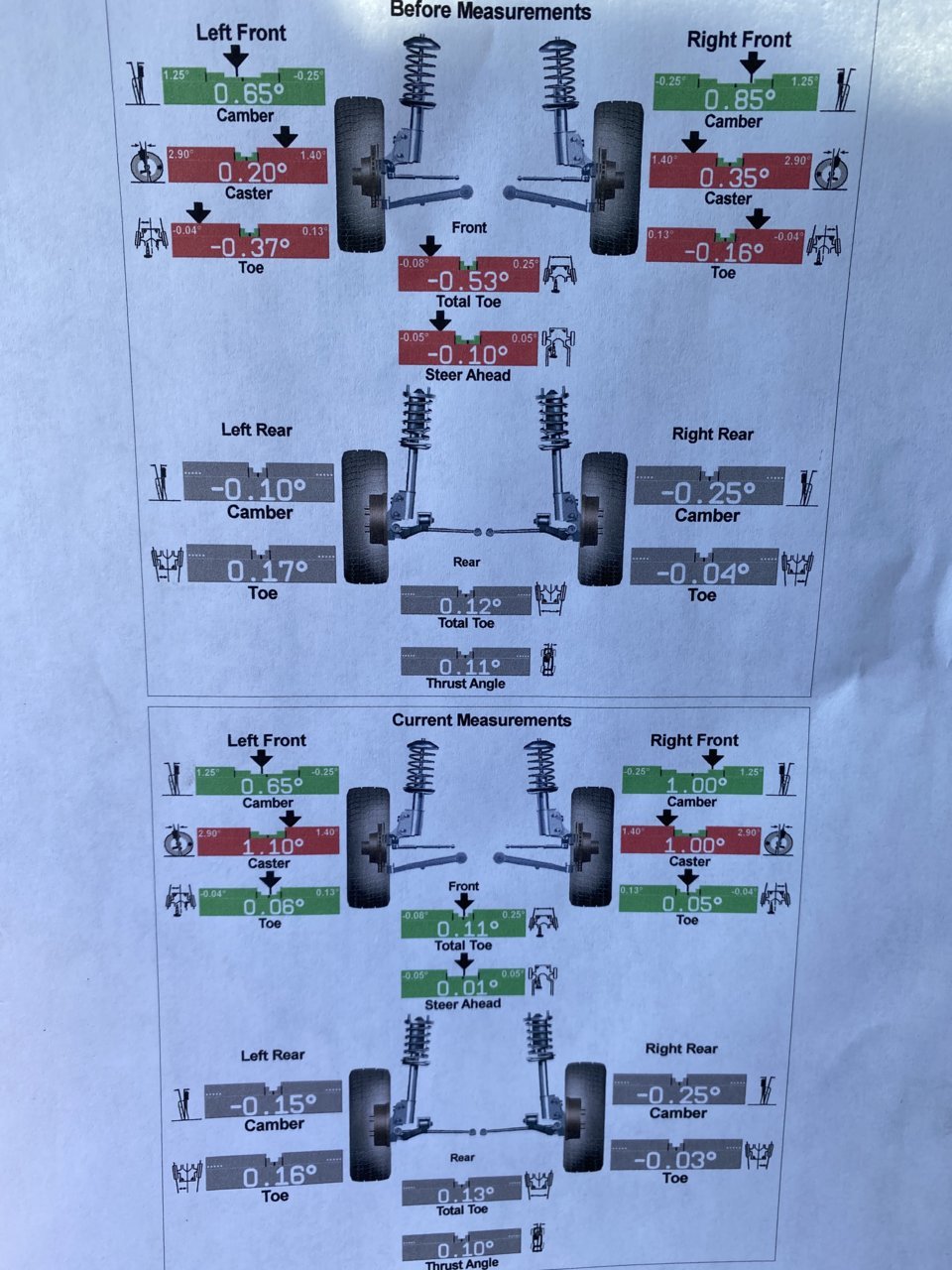

    So with that caster, is the assembly sitting further forward?

    Yea I think so.

    By looking at the UCA angle, you got like a 3.5" lift at least.......how much was it setup to??

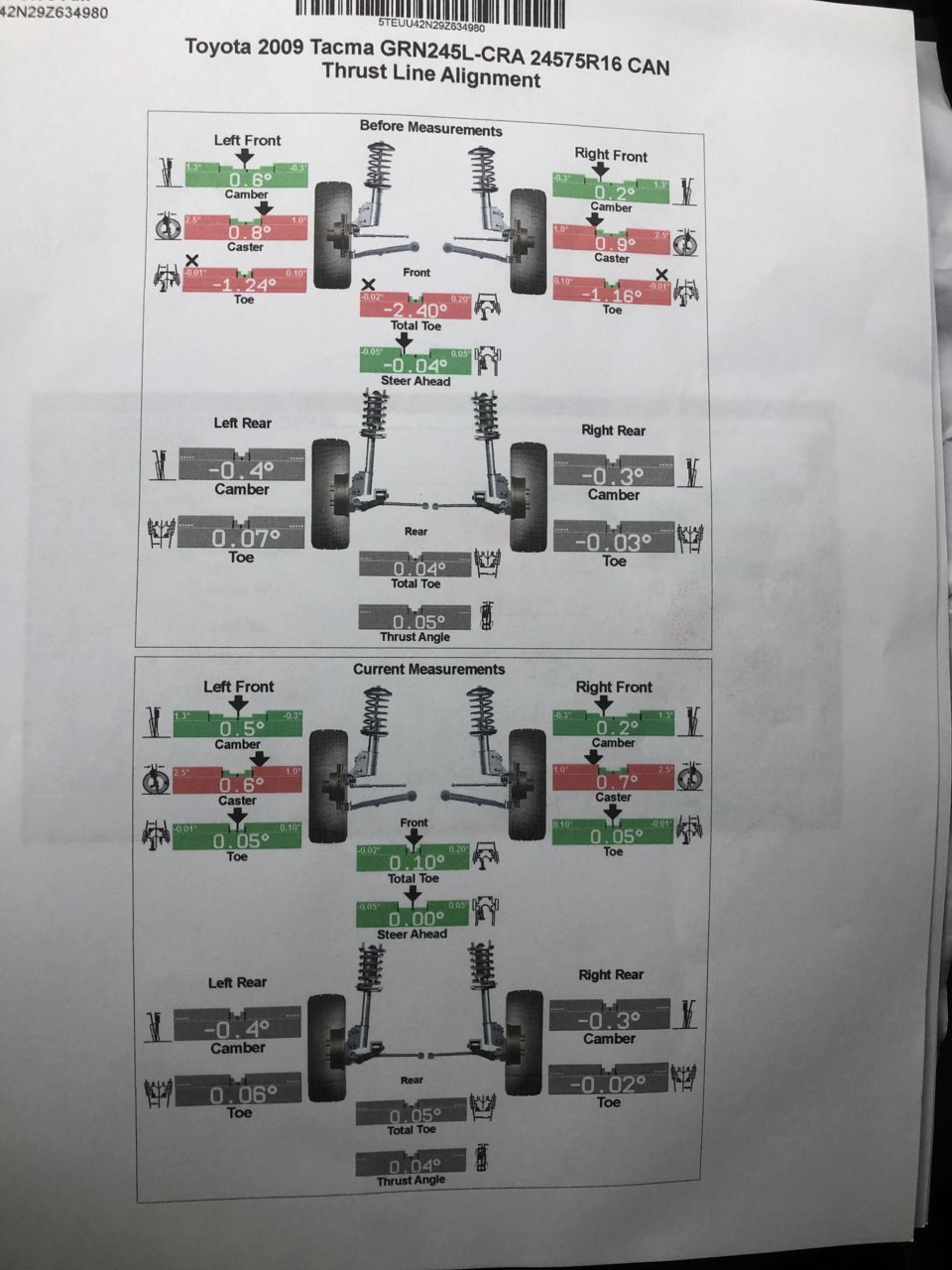

    I don’t know what all these numbers mean lol but I reckon they got it. I gave them the IM specs to go off so maybe I’ll drive it a bit and take it to another Firestone to double check? Or do y’all think these numbers are good?

    I’ll say it fells a lot tighter up front makes sense since toe was kicked out like it was broke

    It more green then it was, I guess that’s good. As long as the tires clear everything and it feels good that’s all that matters. Just need to keep an eye or tire wear. Nice that you were able to get it done this morning.
