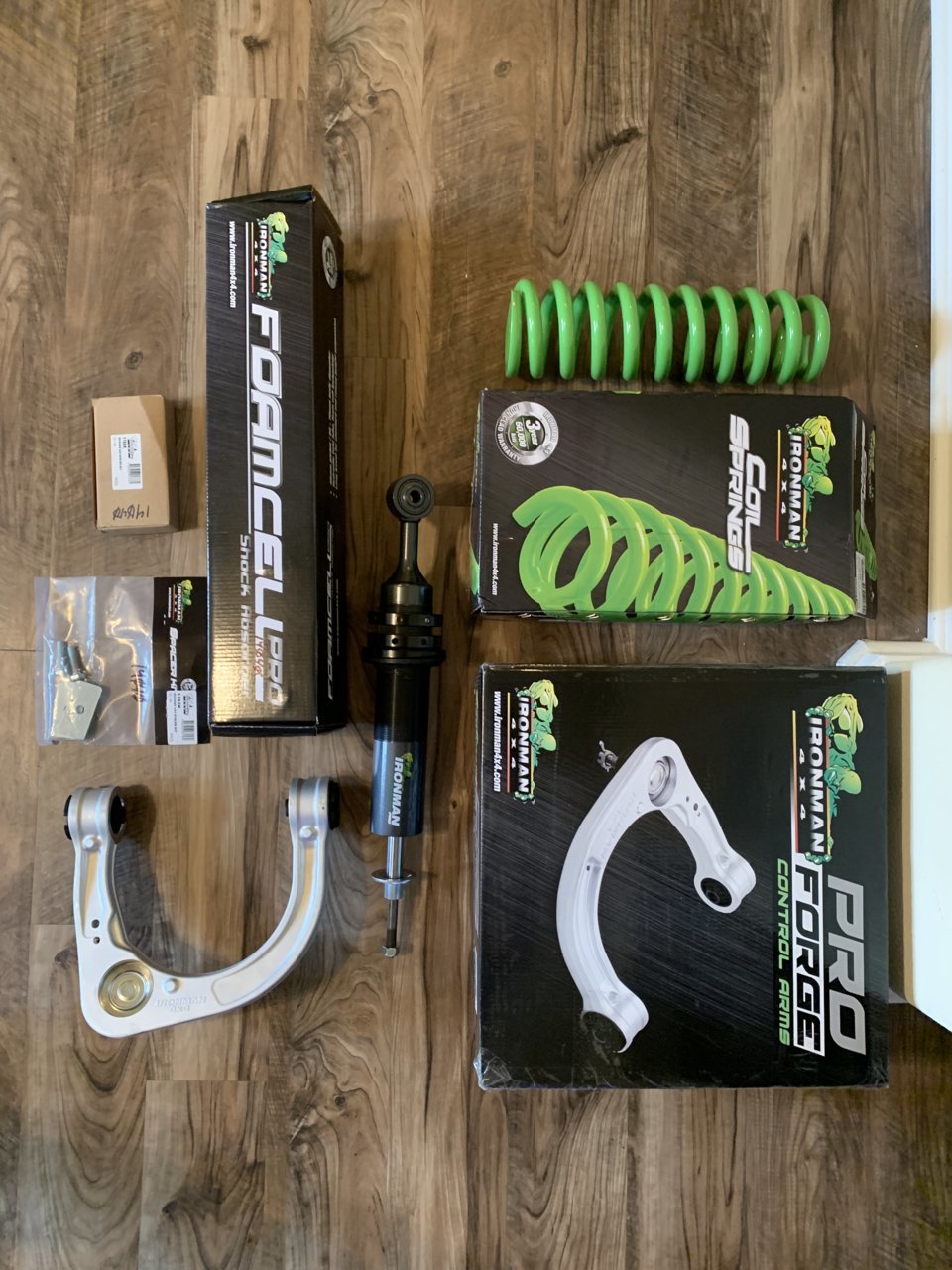

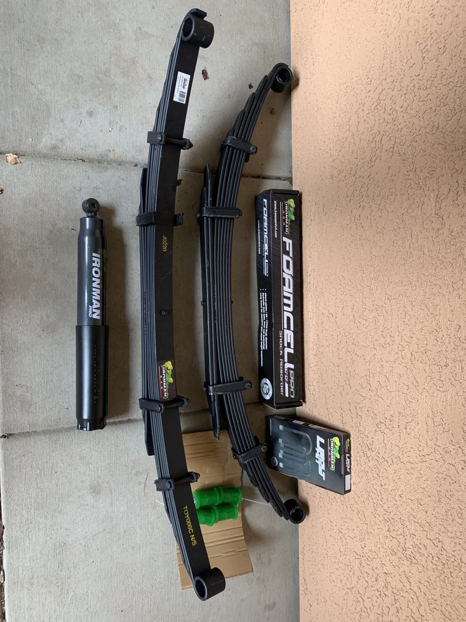

    Wow. The comments about the weight of these products is no joke!!! Just trying to get some eye candy and I worked up a sweat!
    Setup: FCP Stage 2
    Front: 2.5" Performance Load W/ Pro Forge UCA's
    Rear: 2.5" Constant Load (Will be removing 3rd leaf to make this the Performance Load Pack)
    Current Deal included Treds Recovery Boards. They are OOS with anticipated replen by EOM. I'm sure I'll forget about them by then and it'll be like another early present!

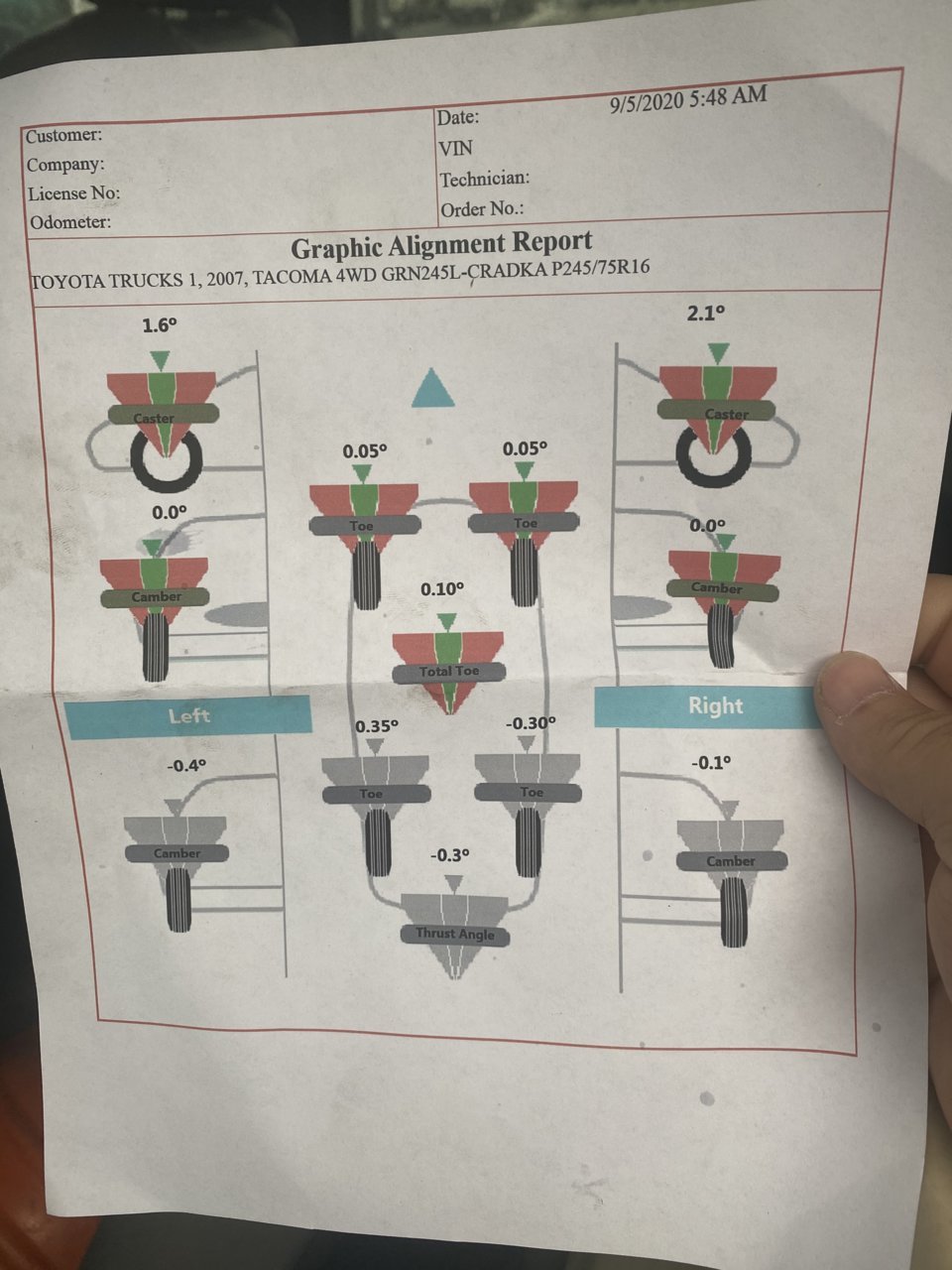

    I forgot to post this... this is what my alignment specs are
