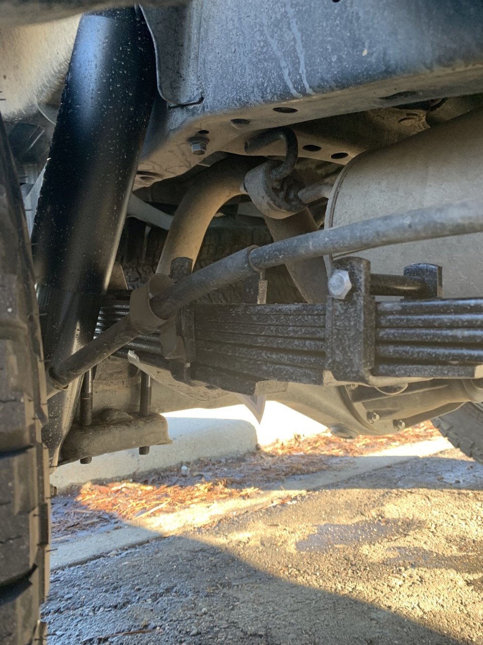

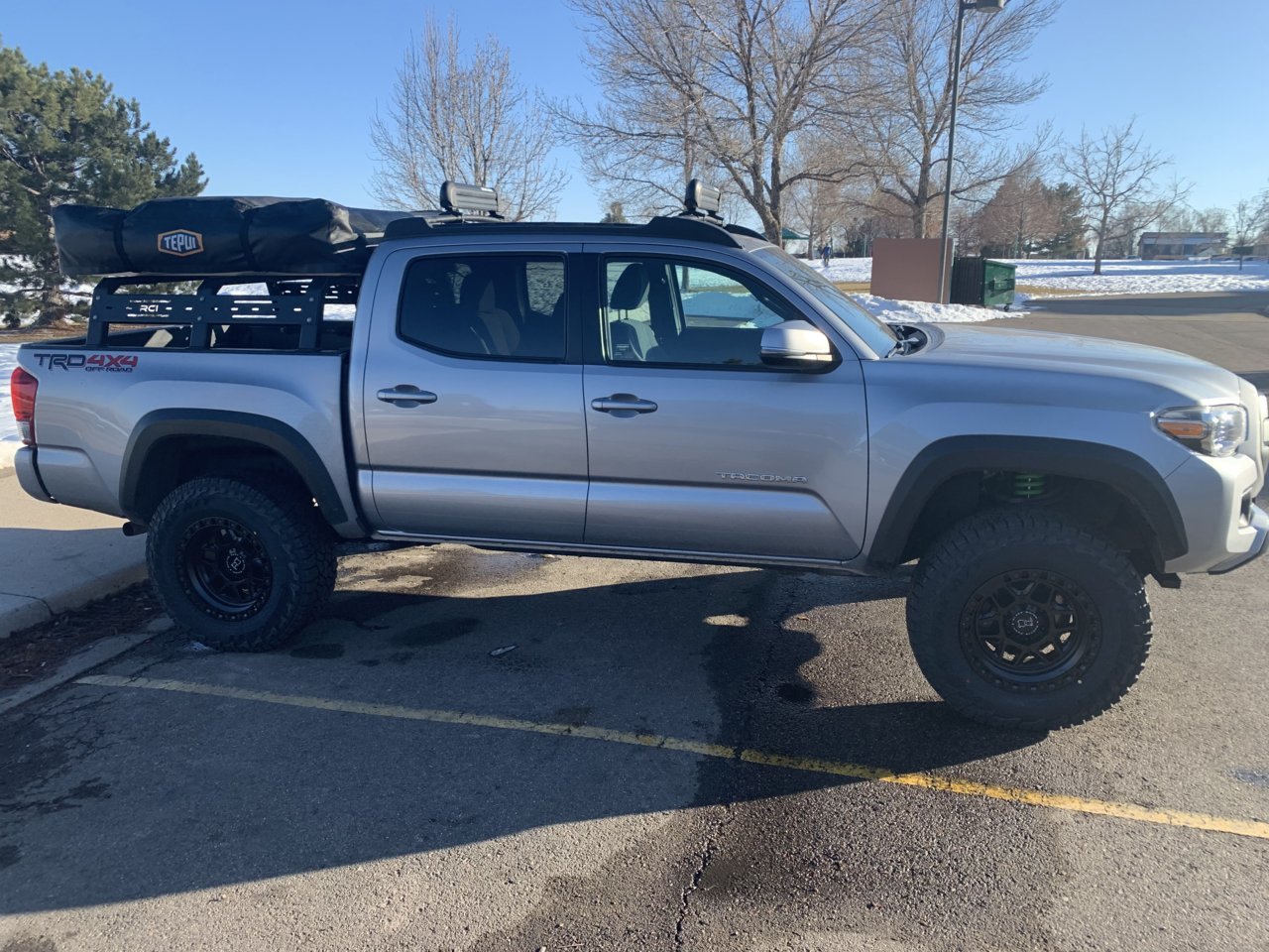

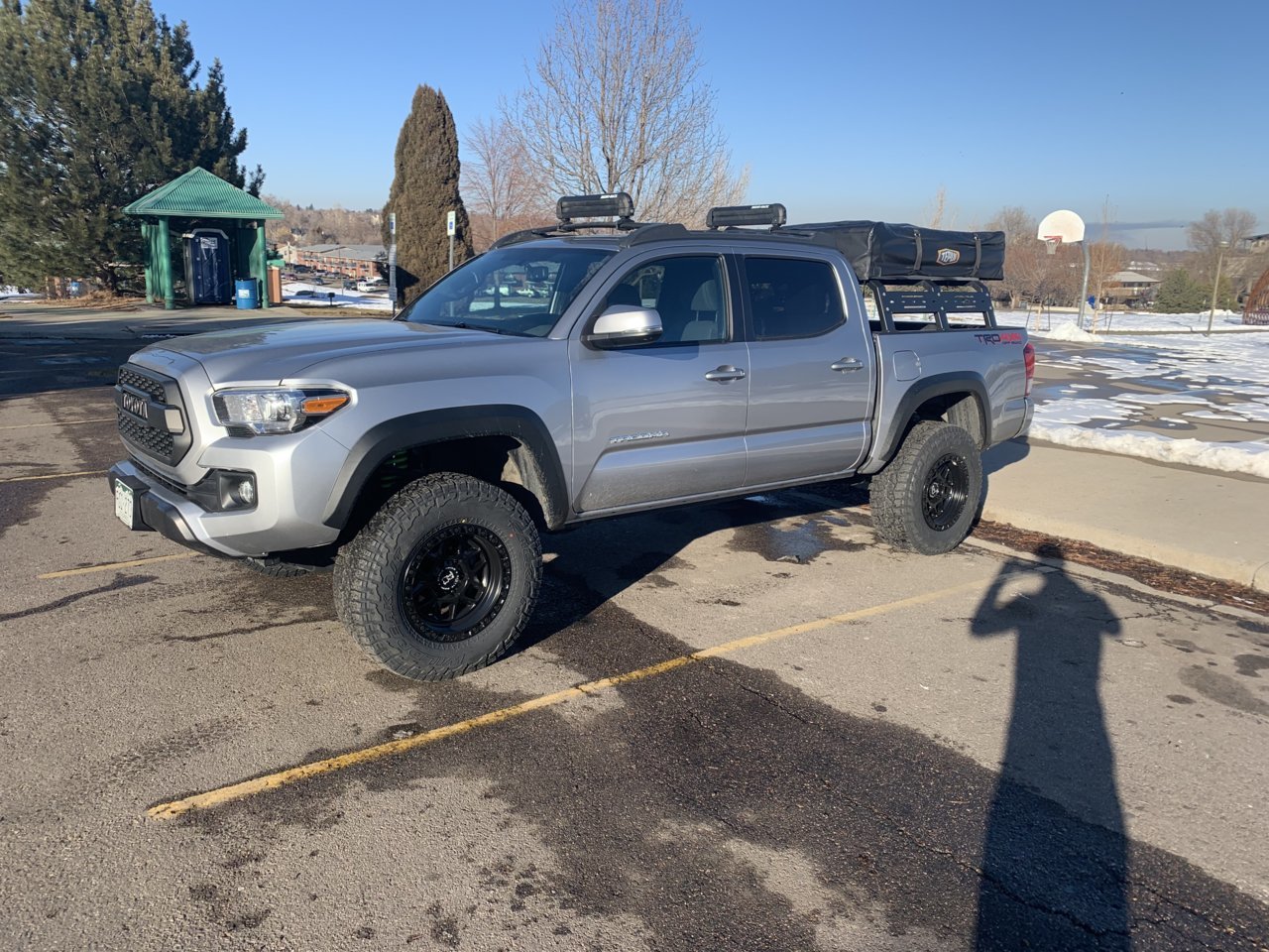

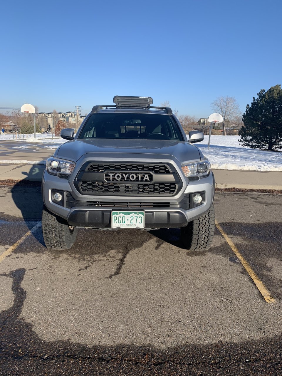

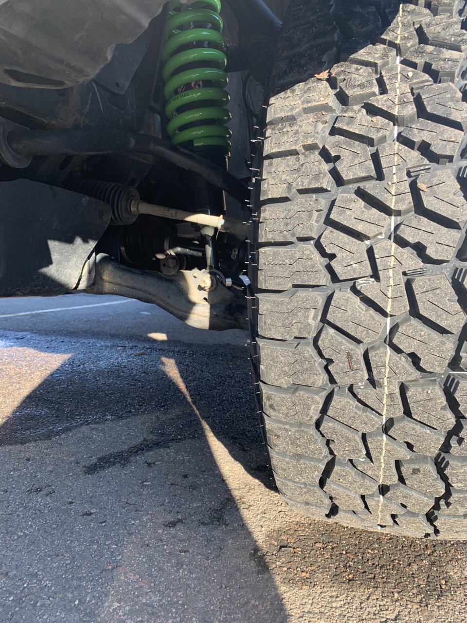

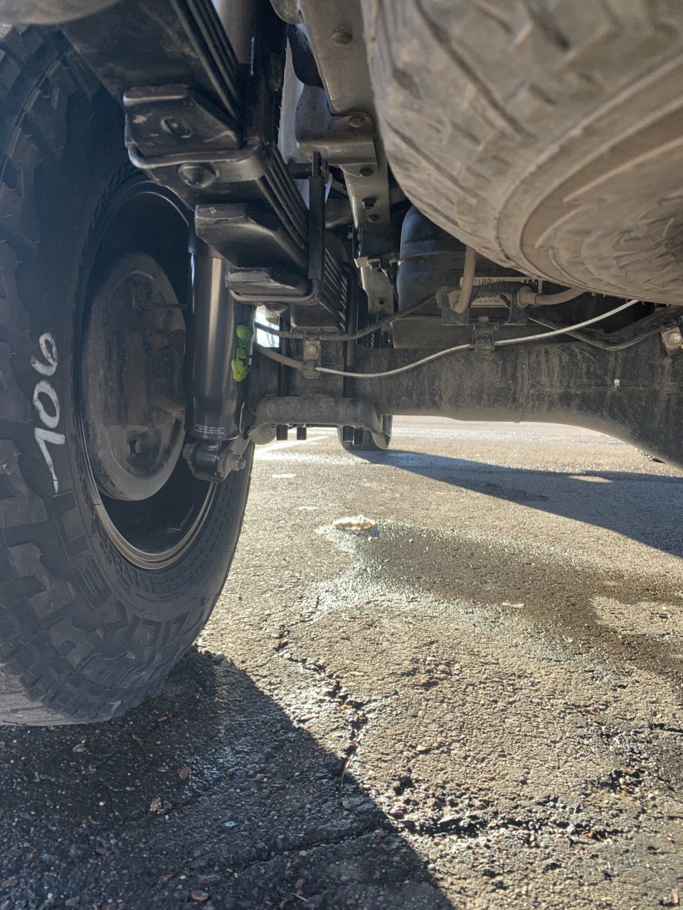

    Initial Feedback:
    • Ride quality is wayyyyyy better than expected. Granted, it's been 1 hour but I took it around town (West Denver) and a little bit on the highway. The handle is definitely firmer than stock but not so much that it's a huge difference. It's very comfortable as a daily driver.
    • Already going over some speed bumps, dips in the road, a curb, etc. the performance vs. stock is far beyond what I ever imagine. It's super soft and barely noticeable compared to stock. Already an absolutely huge upgrade for performance, I can't wait to get it on some light trails and washboards that I consistently encounter dispersed camping in the summertime in the mountains.
    • Falken tires are much more quiet than I expected, definitely a firmer ride and a little road noise but overall it's nominal compared to my worn down stock tires.
    • Alignment is much better, this was to be expected as I hadn't had my vehicle aligned after a summer full of camping.
    I've driven a taco with 5100's and the ride performance is far superior, I'm happy with the extra money spent on the Ironman's. So far I couldn't be more pleased, I'll continue to report back as I get into different types of terrain. I can't wait to get my running boards on next week (waiting for delivery to install with a buddy).
    Highly recommended to this point!
