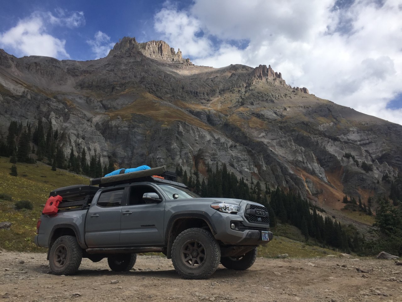

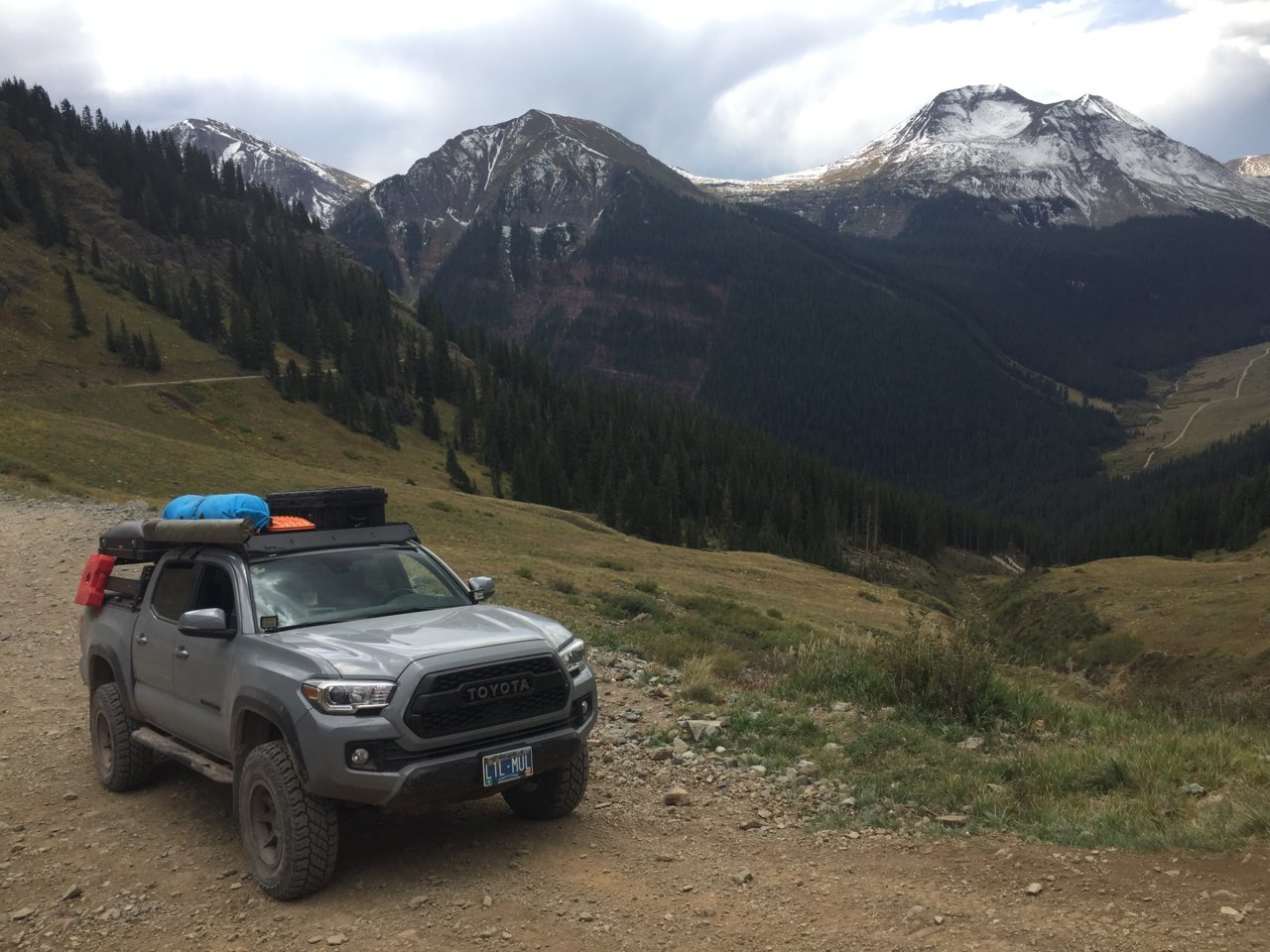

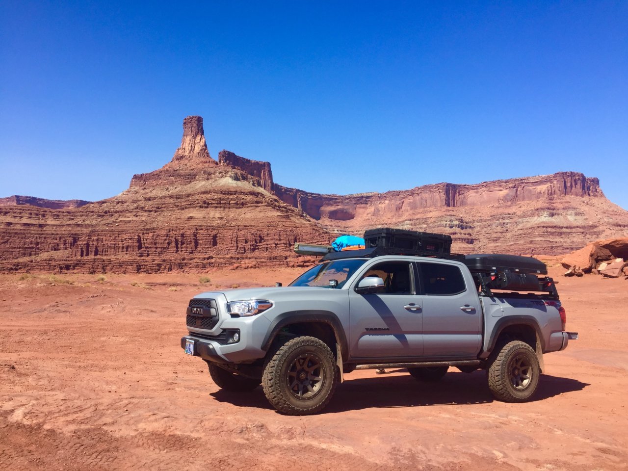

    Took the truck to Colorado and Utah to play. Suspension worked great.
    485ACAB8-50BC-46CD-8EDF-4BEC054B60C5.jpg 52957F41-96FB-4B5B-9EB5-1CF6F9218AF5.jpg 010548DB-6AEF-45D3-A92A-B90C428264A1.jpg F7778354-2E5C-401E-8A0B-7E22E74C4B7A.jpg
