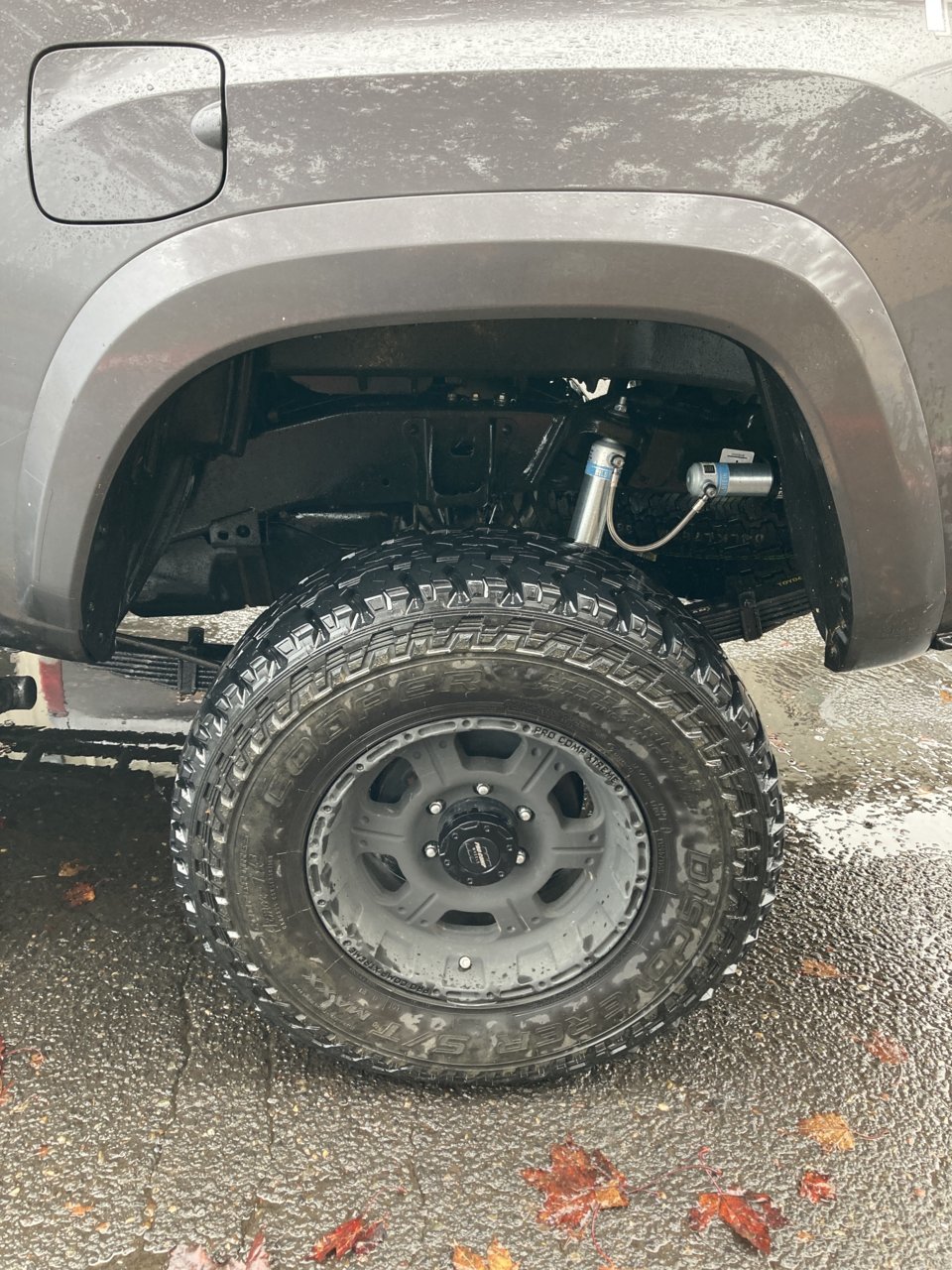

    Sooo...I had a Bilstein 6112/5160 with Ironman constant load leaf packs installed today thinking I’d get 2” front and 3-4” of lift in the rear to get my rake back...I got 6-7” of lift LMAO :bananadead:
    Went from 20” all around to 22” front and 26” and 27” rear. Stink bugging like a MF.
    Going to pull the 3rd leaf and probably the overload. Just a PSA for anyone on the fence between Performance and Constant like I was...

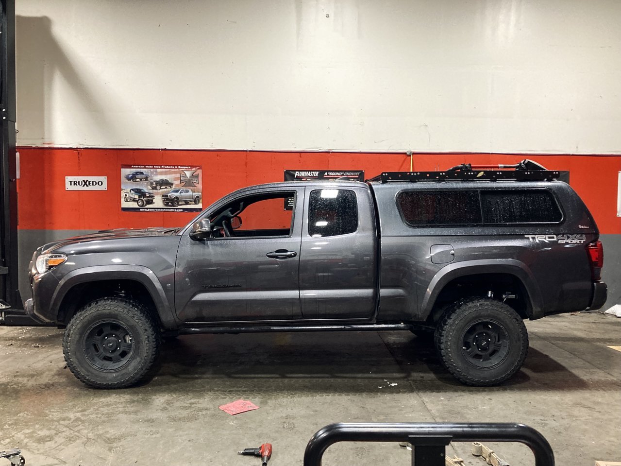

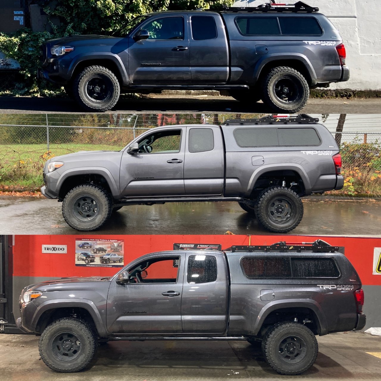

    Ended up pulling 2 leaves from each side of the constant loads. Net result afterwards is 4.5” in the back which still seems tall for removing 2 leaves. Might contact Ironman to see what’s going on - happy with the end stance though and for getting some down travel back. Before, middle, end:
    For reference, this is the crazy lift I got in the back with the constants before pulling anything - sitting on pavement and almost topped out:

    Lookin good there
    FashTaco[QUOTED] likes this.

    I was only expecting an inch, maybe 2, more than the Performance springs and was blown away when I got 6-7” total. Ironman recommended pulling the 3rd leaf and 4th if needed. I told my mechanic that but also said I trust his judgement - would have to check. After pulling 2 leaves we realized the bolt provided wasn’t fully threaded either, so he had to add some thread to make it work - just FYI.
    I’ve still got 2” of rake (was shooting for 1”). The last photo in that collage I posted earlier auto straightened - here’s how she actually stands now:
    Part numbers were correct, so not sure if I just got a freak pack or what. Will let you know if I’m able to sort it out with Ironman - visiting their office this week.

    So I stopped by Ironman to have them look at my rear (phrasing), they said that my height was normal even with 2 leaves pulled. Live and learn I guess. If you're running the same weight or less than I do, I would exchange it for the Performance springs if it's not too late and do an AAL later if needed. If not, my guy pulled the 5th and 6th leaves from the top for reference (above the overload). Ironman said that was fine after taking a look.
    I'll let you know if I think of selling - will hang on to at least one leaf in case I go crazy with my build.
    @oakcity
    "I’m not sure it was a different pack, I also got the constant front and rear and someone here at the beginning of this thread posted how theirs looked with constant and it was funny too. They pulled the 3rd leaf and it settled down. Based on that I pulled mine before I installed it and the end result is like yours. I don’t have all the things yet for my truck that would justify constant in the rear. I believe the IM springs and leafs have a higher load rating than OME too"
    ^Yeah, they're rated 440lbs-GVM for an estimated 2" of lift - I've read this whole thread and knew I'd be a little under 440lbs and was expecting more than 2" based on what I've seen and after calling a few dealers, but not 7". They're really nice guys, but I just have a hard time believing that if I threw an extra 50-100lbs in my bed to hit that 440lb mark that I would be anywhere near 2" lol. Pulling 2 leaves still netted me 4.5". I recommended they reach out to their dealers and let them know to not provide estimates of 3" but 6"-7" for the Constants for people at/close to the lower end of that range.
