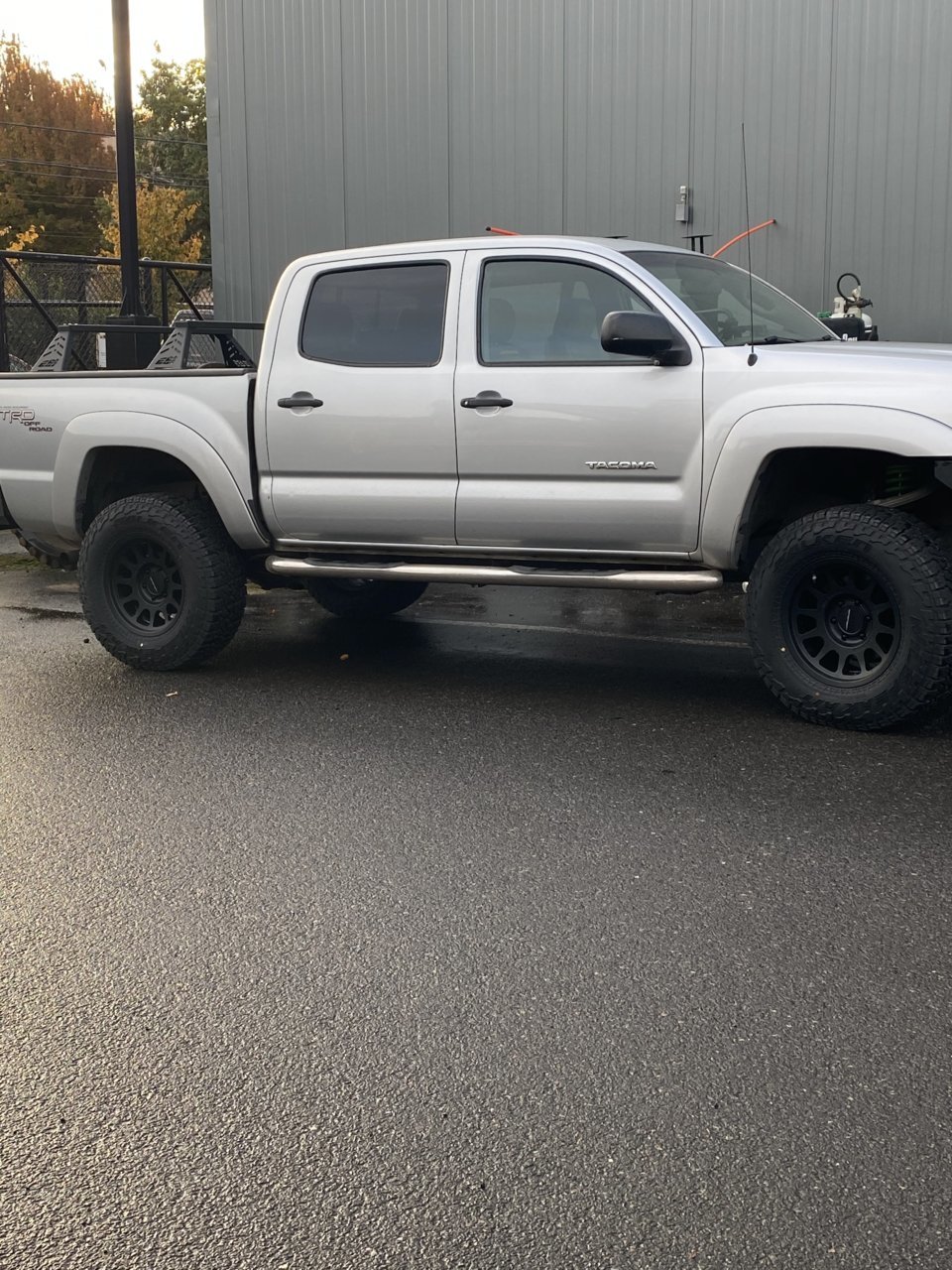

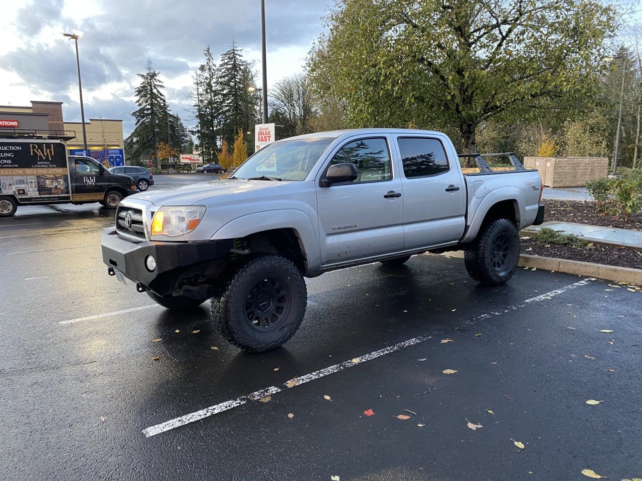

    Here’s one pre nerf bar take off.
    Stage 2 FCP kit. The day after I put tires and wheels on...

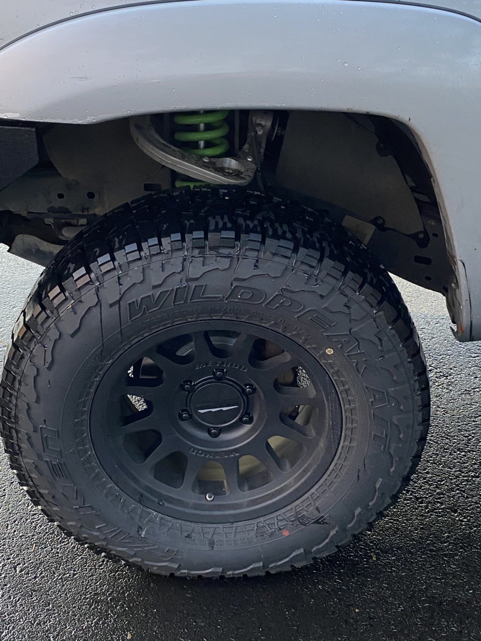

    i took this picture just now for you. Not hitting any mudflaps anymore.... because I don’t have any lol
