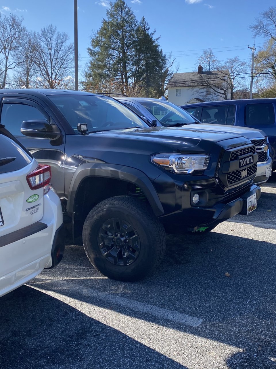

    Depending on your truck it can look good. Definitely worth a look too.
    Just a little green peek :spy:

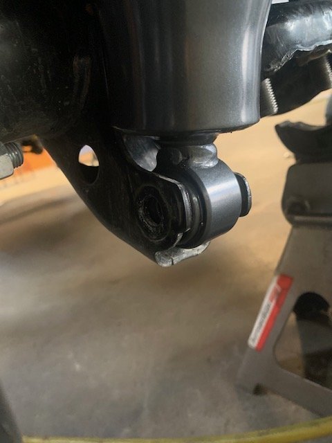

    Hey guys, trying to see if anyone else had issues with installing rear shocks. they seem to be too fat the shock itself gets held up on the knuckle. images below were the best visual i could show it pushed the bolt holes too far forwards IMG_2290.jpg IMG_2291.jpg

    @stuffedtaco gotta turn them 180 to fit. I think the stickers were put on the wrong side. Don’t know why but that’s what I did for mine.
    I’m pretty sure they’re the same part numbers so not difference for sides. I think I tried both and got the same results, didn’t fit with stickers facing out.

    Im not sure why that worked for me, the looked identical both ways but something must be just slightly off center that it worked.

    THere is an offset in the mount because of its bigger diameter than stock, try flip the other side

    Just looked at the rear shocks and you are correct they are slightly off center I’ll take a picture and post for future

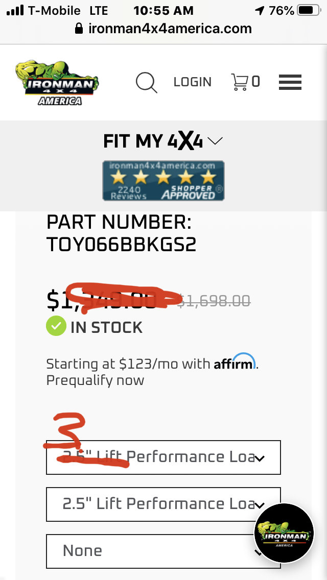

    ordered stage 2 nitro but requested for 3 inch front set up Coz I have 285/70/17 from previous truck 2.5 at the back paid hundred dollar more

    You did an AAL to the performance pack for 2.5” in the back?

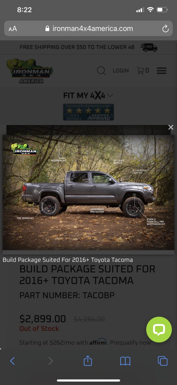

    Interested to see what this underbody protection is gonna look like-

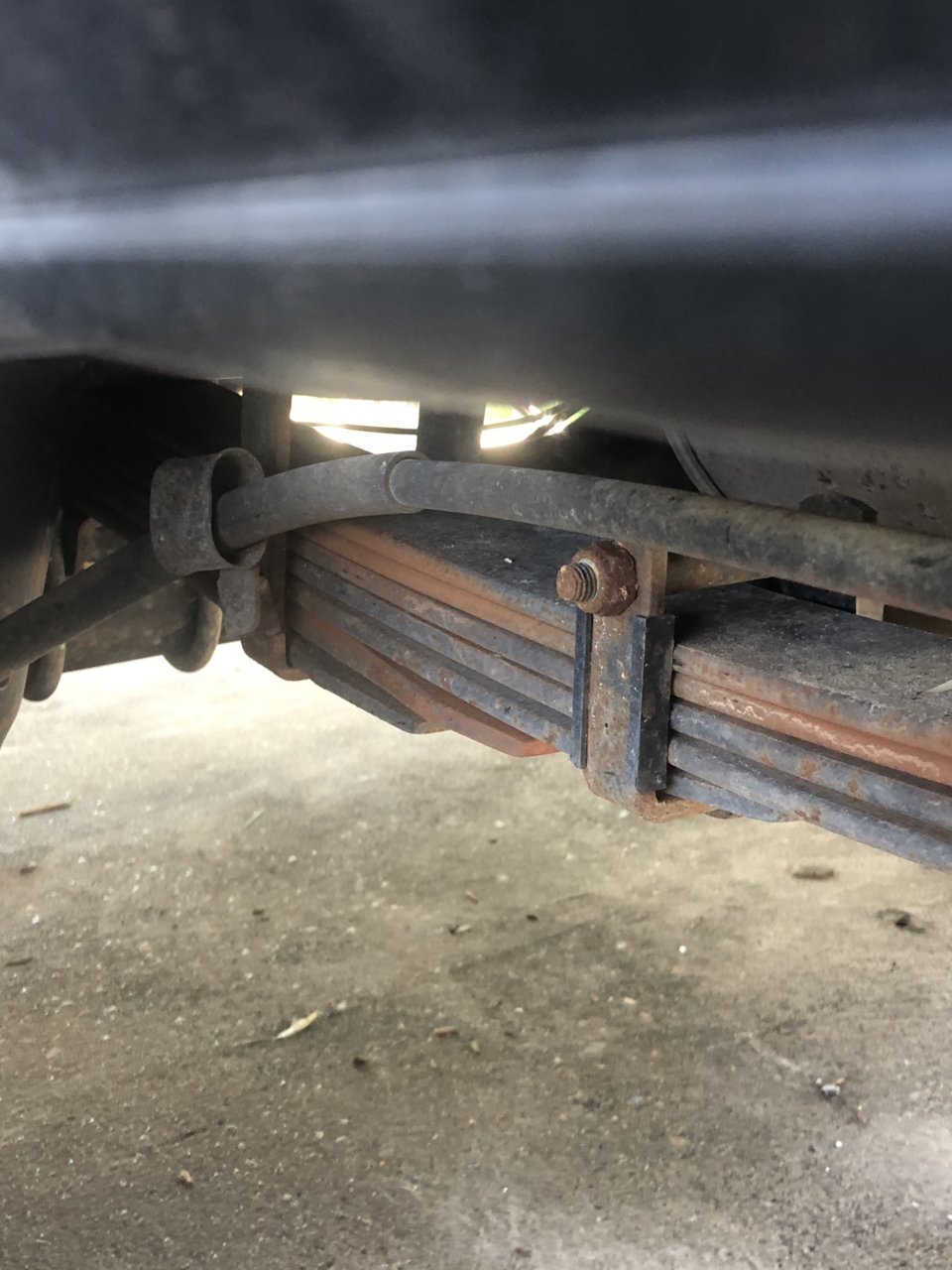

    Not sure if anyone else has had issues yet but the powder coat on the leaf springs has already worn off and started to rust between the leafs. Only 6 months old. Something to look out for.A3DBFE6C-811D-4627-954C-9EEC2FF06EB2.jpg

    Not something I’d really expect after 6 months. Might want to give them a call or take a wire brush, knock anything you can off, spray with a rust inhibitor the coat them with Fluid Film or Woolwax.
    I did my frame with the black Wool wax, including the leafs so i won’t be able to tell anything till it’s all cleaned off in spring.
    Either way you go, good luck.

    That’s a bummer! And you’re not in a salt environment either... I wasn’t particularly impressed with the level of coating on the springs. When I took apart the bundle I could see they had given each leaf a coat of primer, but they weren’t individually coated all the way around.
    Something else.. in your photo, that E-brake line (I think its the e-brake), it doesn’t rub against that bolt end does it? I haven’t returned my axle to the upright position yet, but as it sits now, looks like it could be an issue. Do the springs travel up and down any, where maybe it could rub while you’re bouncing?
