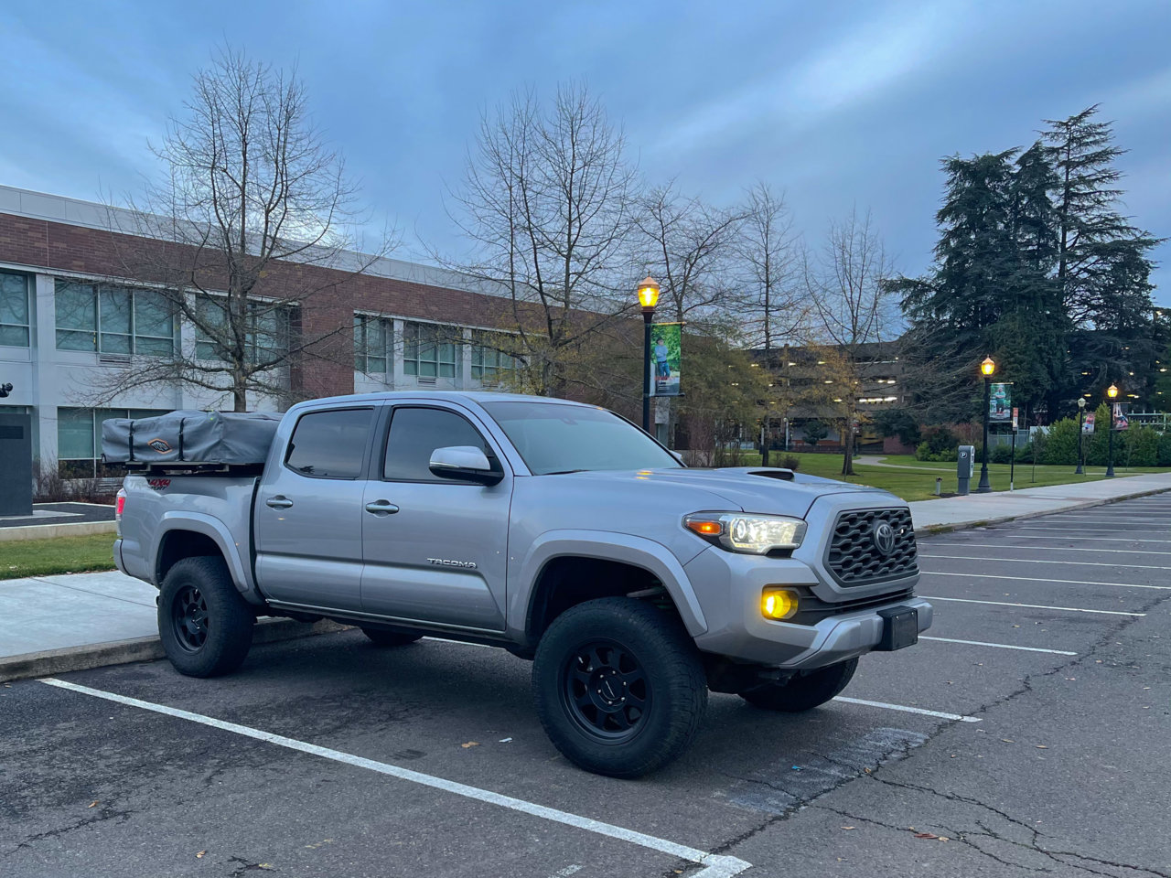

    Thanks man, I appreciate that. I just purchased some Method 701s in 17 with 0 offset that are going on Saturday. I’ll update with pics, maybe I’ll debadge this weekend too.

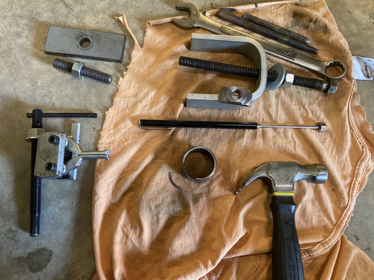

    Hoooo-baby! East coast got the puller to me in less than a day and even with a quick/slight shave to the nut, had the old bearing out in less than 30min from time of unboxing.
    Although, just tapping softly against the nut to get it in place caused a large sliver to break off from the backside of the bearing. I’m glad to hear folks who left it in aren’t having any issues, but yikes, this is one sensitive piece!
    In the image you can see the piece that broke off and also where I had shaved some off the puller nut. I lucked out in being able to utilize my other two failed attempts in conjunction with the ECGS tool. The longer bolt I tried to use happened to be the right size and also the u-brace from autozone’s pilot tool allowed me to stay off the shaft seal.
    super stoked to have caught a break here and currently have the new bearing on ‘chill’ mode in the freezer :thumbsup:

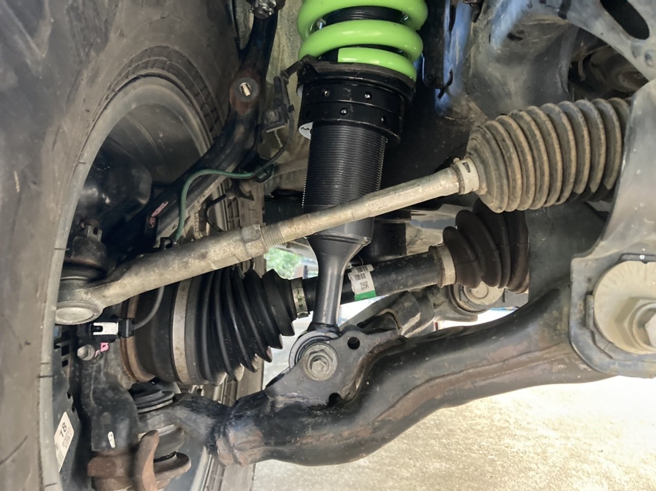

    We’re all done! Bushing in and final strut / uca assembly installed.
    Can’t drop the truck until I finish up the diff fluid.. and shaft relocation. This was some hard work, but I really enjoyed getting to turn some wrenches and learn a lot about the vehicle I’m in! :transformer:
    Will post final lift height in relation to the installed parts when she’s back on the hard.

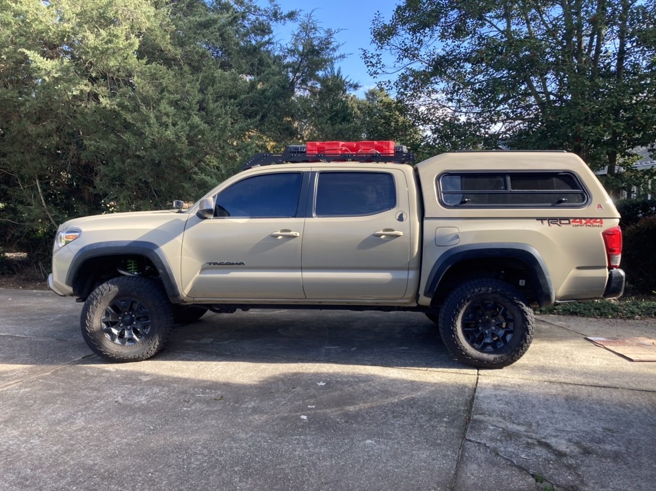

    I’m kinda confused right now, I show 4” of lift in the front. I think I need to add a leaf back in now hahah. I’m gonna marry this metal one day...

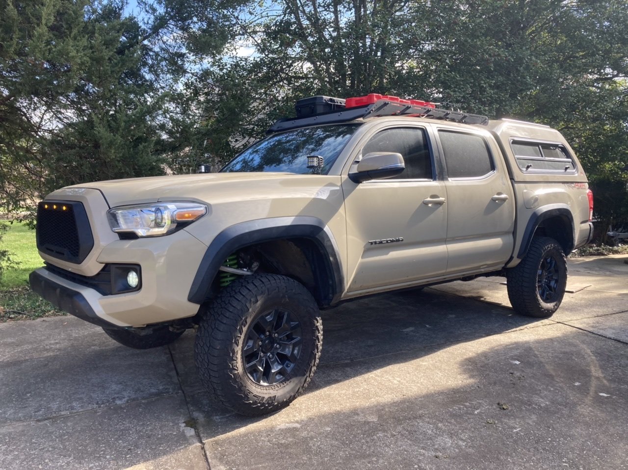

    So, as I said earlier, I goofed and forgot to record the initial measurements for the rear. I feel safe in using what’s all over the forums as an approximate guess of CENTER HUB to FENDER. Gas tank is full and tires are set to 31 psi in case it matters.
    STAGE 2 FOAM CELL PRO, TACOMA 2005+
    * PRE-ASSEMBLED FRONT FITTED TO 2.5” LIFT
    * CONSTANT LOAD REAR MINUS THE 5th AND 3rd LEAF
    FRONT lift: 4.5” driver, 4.25” passenger
    Before — driver: 19.75 // passenger: 20
    After — driver: 24.25 // passenger: 24.25
    REAR lift: 2” driver, 2.25” passenger
    Before — driver: 22 // passenger: 22
    After — driver: 24 // passenger: 24.25
    Roughly speaking, the after measurements are 24” all the way around, yet it most certainly looks higher in the front. If I do a ground to fender measurement (which I feel is a little more accurate), I see a 0.5” difference in front to rear. If stick a level on top, it shows higher forward.
    So what do you guys think, leave it as is or go back in and add the 5th leaf?
    I’m a madman when it comes to stuff like this (should see me setting dock lines!) and dont mind the extra work since I’ll be taking off the u-bolts to get paint on the rear axle anyways.
    I’m also curious how much the leafs will settle and might just run the trip to New Mexico as is and see how things look when I’m back to NC in March and can re-do the leaf bundles then.
    LongDistanceTaco and hyrule_trd like this.

    Thanks devir. Skids n sliders are probably next in the installment list, if not upgraded headlamps. I’m in a moral dilemma for which is more important, lol. Looks or function. :D But yes, gonna drive it awhile, and I’m fairly certain I’d have at least one set of extra leafs I’d be willing to offload.
    Looks like Ironman’s AAL is a comparable option to most the others out there, but it honestly seems like the concurrent theme here is only leaf removal :rofl:

    Speaking from experience, I would leave the back alone and lower the front. I think Ironman needs to get a better handle on where to set the front perches as everyone who follows their recommendation ends up front high.
    Generally speaking, these trucks don’t do well lifting above 3”. If you leave it at 4”, you’ll want extended cv boots or the fins will rub on each other until they fail. Additionally, with that kind of preload the ride is very stiff.
    To each their own but for me I think it looks much better, performs much better, and puts the axles a better angle. My $.02.

    Stand by, gonna do a bit of pressure washing and will post some pics of the CV’s. But at quick glance, I think you’re right and hopefully a quick diff drop will bring things back to par. Thanks for the input though..

    @nwmorrow
    passenger side, looking in from front
