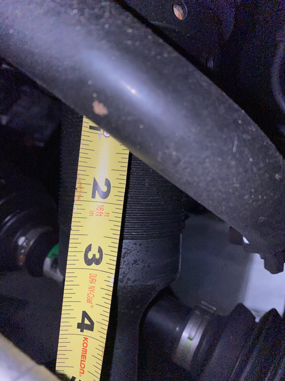

    Alright, looking into getting the front coils compressed. The shop I talked to was very concerned about putting extra load onto those springs by compressing them even further.
    Could anyone with a performance and/or adjusted front strut do me a solid and measure the amount of threads you have at the bottom, beneath the 2nd collar? I just want to confirm I’m somewhere in the ballpark of what others have..
    I show 2 3/4 driver, 2 5/8 passenger
    Also, ironman offered to give a partial refund to cover this cost. Good on them. :thumbsup:

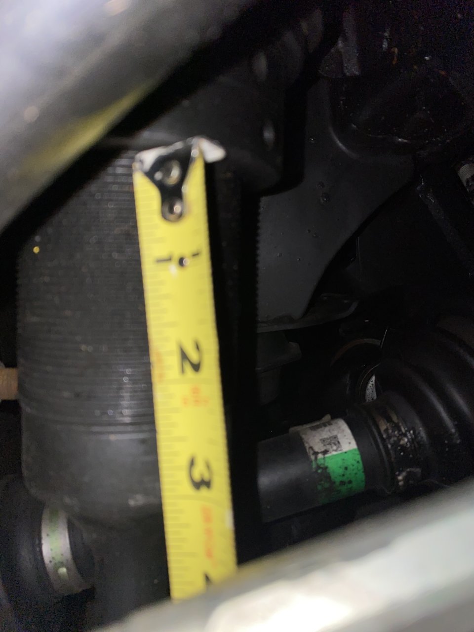

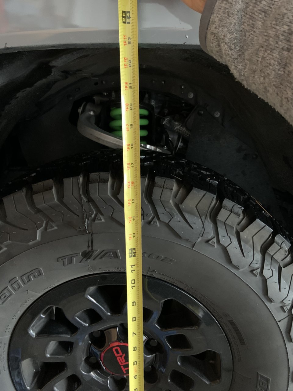

    First pic is the driver side, second is passenger. Then a bad pic showing hub to fender of 23”. At least you can get an idea for angle of the UCA.

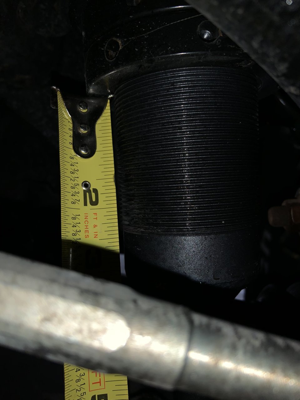

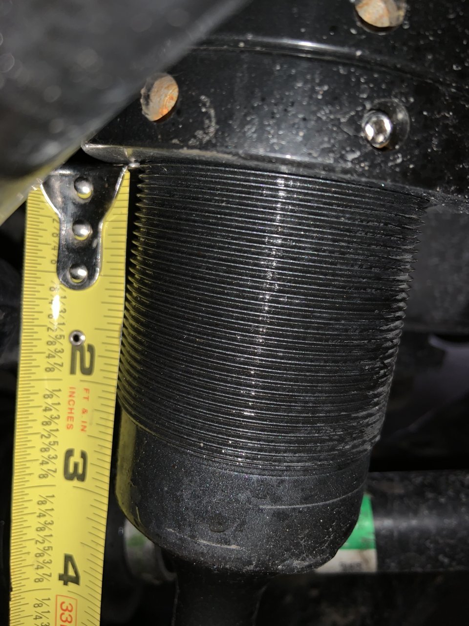

    Heres what I got-
    passengers side blurry 2 and about 3/8
    Drivers 2.5
