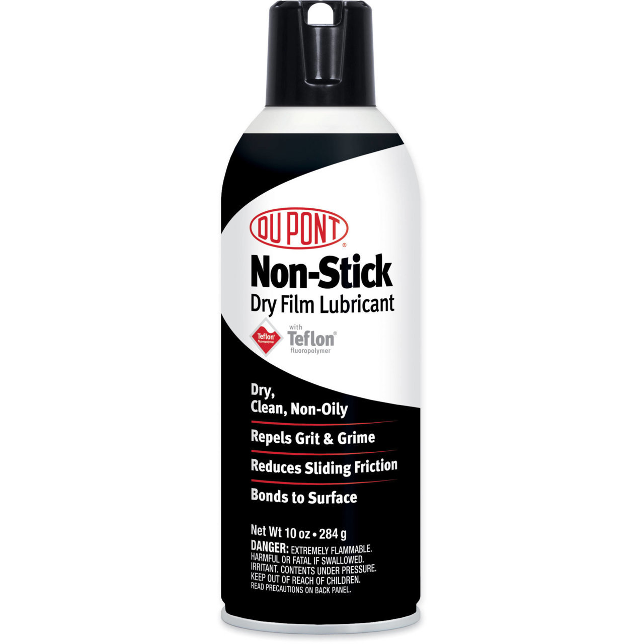

    is there anything you can grease or spray dry lube on that UCA? Maybe the angle changed it a bit from where it would not squeak to where it will.

    Tonneau cover, Black exhaust tip, blacked out badges and tailgate lettering. Black rhino(glamis)18x9 wheels with +12 offset. LT265/70/18 Toyo Opencountry ATIII. Metaltech 4x4 rock sliders Cali Raised lower grill light bar/mounts TRD Pro Skid, DD Fogs(pro), Ironman 4x4 FC pro lift.
    Someone recommended a lubricant, I have to see if I can pick it up at a automotive parts store. Otherwise I’ll be ordering it on Amazon. It’s a Du Pont product.
    Just maybe that will solve the issue....
    hyrule_trd[QUOTED] likes this.

    Hope that fixes it for you!
