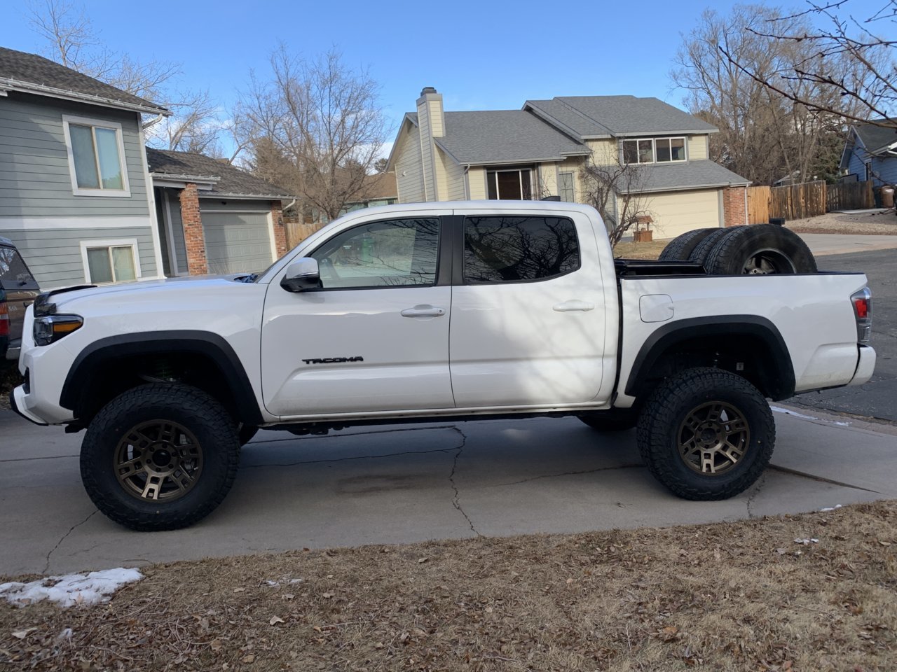

    Ironman FCP Stg 2 FN f(x) AT3W 285/70/17 RSI SmartCap
    Well tires and wheels are installed. Loving the look. Still need to lower the fronts a smidge and get an alignment. No rubbing at all as it sits right now :santa2:
    Cliff Notes Version-
    • Ironman FCP Stage 2
    • Constant Leaf Pack with 3rd and 5th leaf removed.
    • 285/70/17 Falken AT3W (SL)
    • 17x8 FN F(x) Pro Wheels

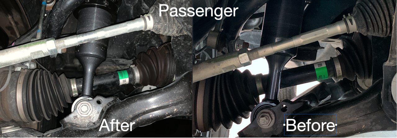

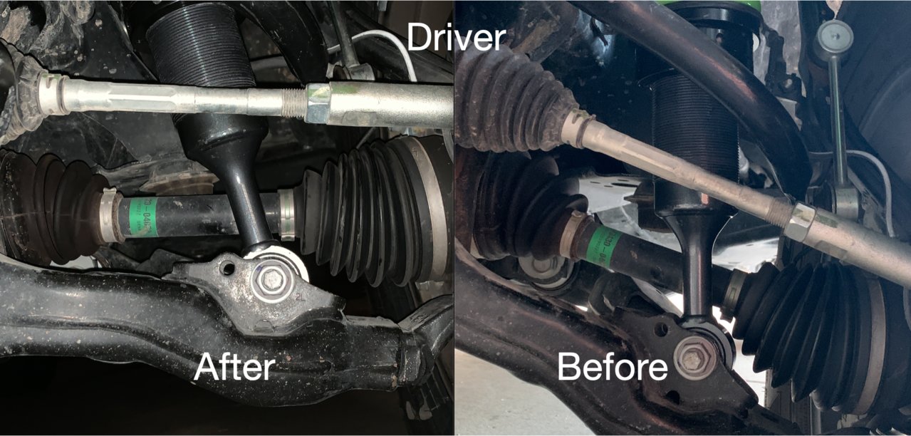

    Had another good day. Got Kings coils installed on my buddies truck. So much easier the 2nd time around! Also had a chance to pull the front of mine down a bit. Not sure if it was enough, but again, I feel like these coilovers defy all basic math and consistency. Pulled the fronts down about 3/8" which, I recall seeing adjustments are a 1 to 2 ratio. Shouldn't that have dropped me 3/4"? Measurements are harder now with the larger tires on and getting some poke out of them, but I'm still not sure I see the 3/4" drop. I will say, the outer(?) CVs look better! Not much impact on the inners :confused:
    Will probably run it like this and try to get an alignment either tomorrow or Monday and see how she goes. Thanks again to everyone for the activity in this thread, super helpful and I hope every had a Merry Christmas and cheers to a safe new year!
    *Camera angles aren't the same, I'll try to mirror the before images tomorrow and update.

    Ironman Stage 1 Foam Cell Pro lift kit, 255/85/16 Cooper ST Maxx, SCS BR6 Wheels, SPC UCA, Heated seats, MESO TRD start button, Meso Total Tail v1, Meso V5 mirror white DRL turns, bed decal, ditch and hidden bumper lights, screen protech, RAV4 radio knobs, steering wheel anytime camera kit, dash cam, ECGS bushing, Timbren Active Off Road bump stops with Wheelers flip kit. 35% Xpel CS Ceramic Tint, KD Max Tune, SumoSprings front bump stops, RRW Sliders ‌ ‌ ▲ ▲‌ ▲
    Good to hear. Those angles look much better. I’m sure it feels a little better driving too.

    Ironman Pro Foam Cell Stage 2 Lift Diode Dyanmics SS3 Pro Fog Lights Diode Dynamics Sl1 Low Beams Yakima Bedrock Rear Towers with 78” HD Bars Kuat Skinny Mini Rack Tepui Kukenam 3 Person Tent
    I would still opt for a diff drop or a cv boot slide mod myself. Also don’t forget to realign it after you lower it. My alignment wasn’t terrible but it still needed realignment after lowering 5/8. Other guys have mentioned the lifetime Firestone alignment. I personally haven’t gone that route but it would’ve paid for itself by now.
