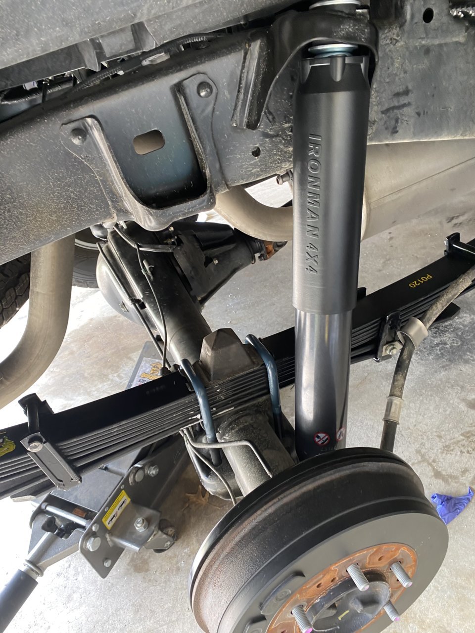

    stuck on rear leafs. Got the driver side and passenger sides sorted, but which direction should leafs be installed. Military wrap in front or back?
    EDIT: Gonna go with military wrap in front, seems to be internet consensus, but haven't found anything ironman specific about direction of the leaf packs.

    IIRC, each on will have a hole for a bolt on the outside portion of a piece of metal. I can’t remember what screws into it though. Maybe a hose or wire clamp.
    Edit- Unless I screwed up my install, here’s a pic from mine-
    Each side I think has that extra part on the forward side of the leaf for a clamp.

    Military wrap toward front. That's right. Good Luck!

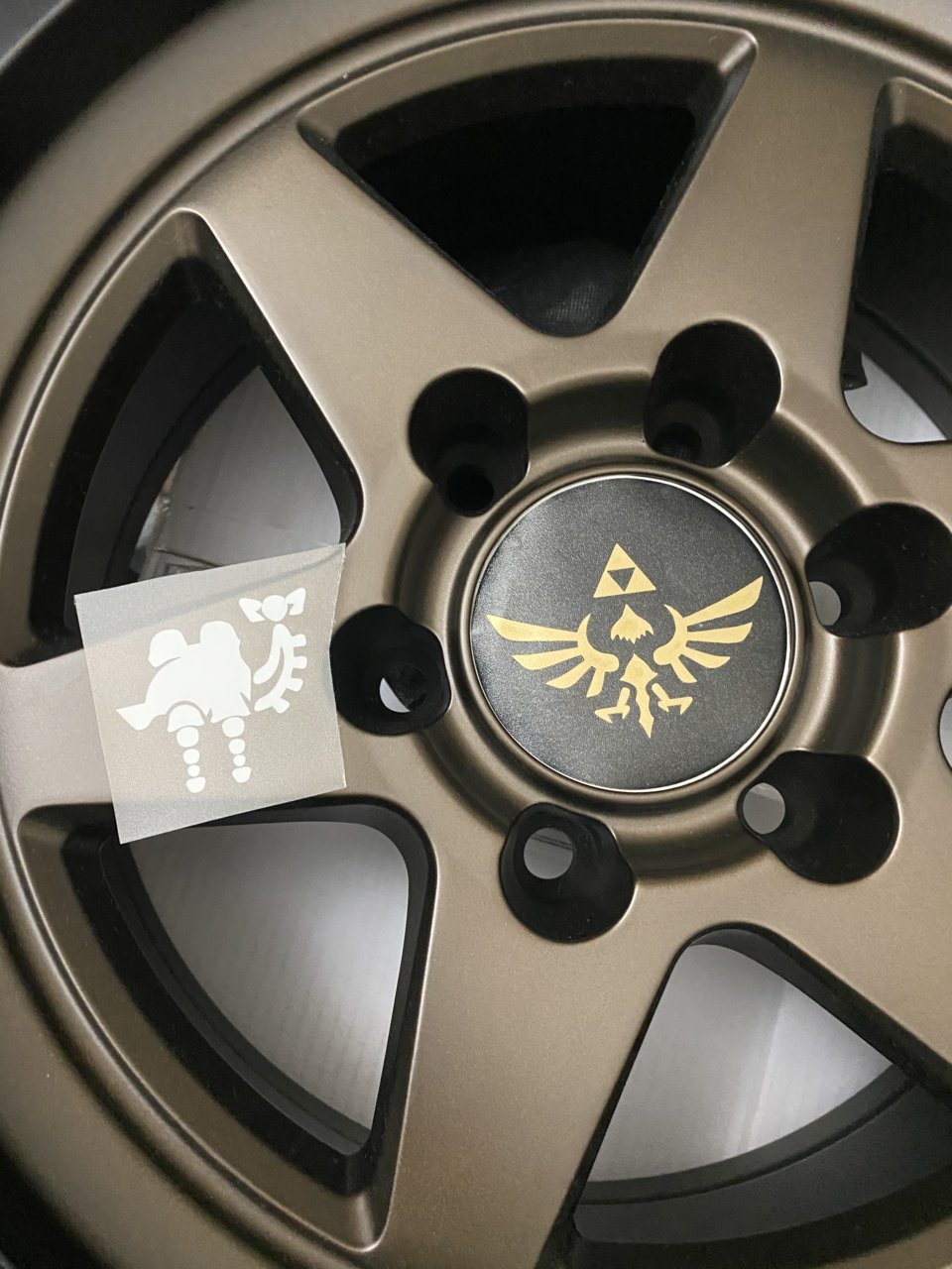

    Lol, I had found something that would work for center caps and gotten vinyl decals similar to the other set but can’t find the decals. Would have looked like-

    i really like how you have the crest in the center i was going to order a set like that from that gal you told me about but never got around to it lol

    Really wish I knew where I put those things lol. I’ll have to order another set if I want to try it again but we’ll see. I might also ask for the same color as the divine beast decal.

    those are silver right? i think it would look nice tbh have a bit more color clash on the truck
    also are you running cooper stmaxx? they look like it lol

    That I am. I think the decals are more of a white. I’ll need to ask the seller from Etsy just to make sure before I decide to get a new set.
