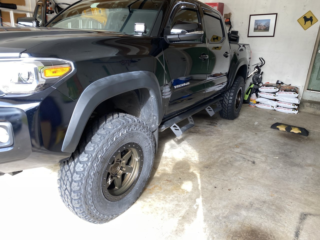

    Lol, sounds like you do need a new set. I really would have liked to have the crest match the wheel color but my only option for that would be to make a stencil and find a spray paint that matches. The vinyls are not close enough.

    new tires yes but i prob wont go with a stmaxx again the tires were great but i want a full on mud tire not a hybrid so im gonna swap to yokohoma mts

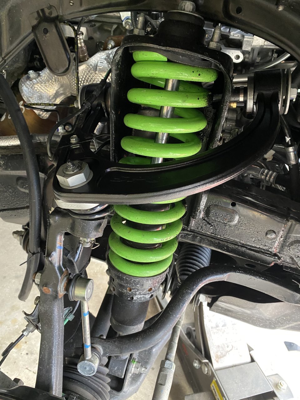

    Yeah I lowered mine while installing it. I didn't have a spring compressor, or a good way to keep the shock in place while lowering, so I did it after mounting it.
    It was a bit of a PIA, even spraying a little lube in there. If your shocks are dirty, or the set screws have messed with the threads, I'll bet it will suck.
    I have the Ironman spanner tool if you want to borrow it.

    I lowered them while still on the truck. They were a bitch, but it's possible. I used the Amazon 80-90 spanner wrench mentioned earlier in this thread, required a breaker bar on the end, also scraped up the lock nuts, so if you're all about appearance, be conscious of that. I have since purchased the Ironman spanner, haven't used it yet though.
    Wheel wells literally let it turn maybe 20% at a time. Pretty time consuming but lets you get a decent workout in! It is possible.

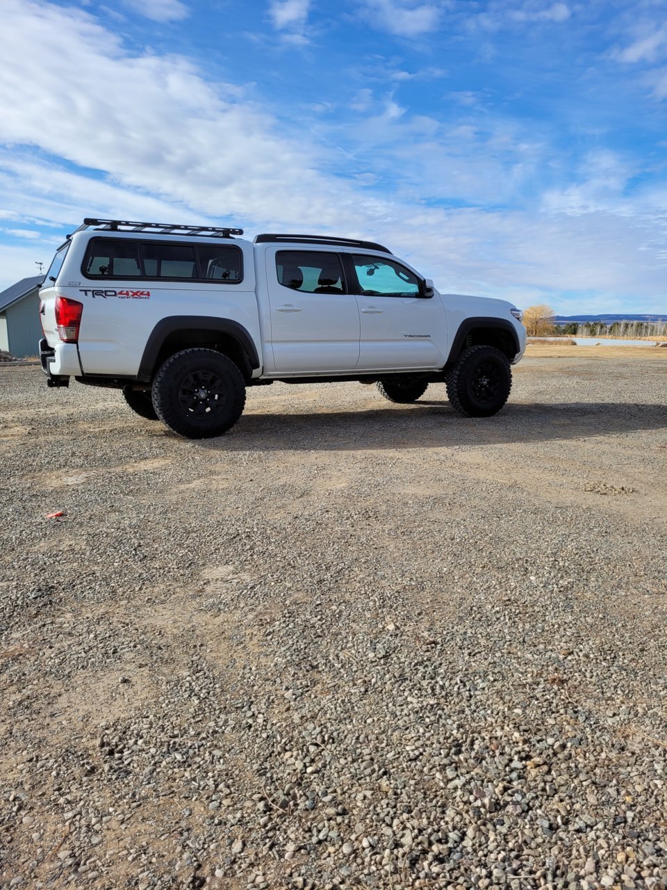

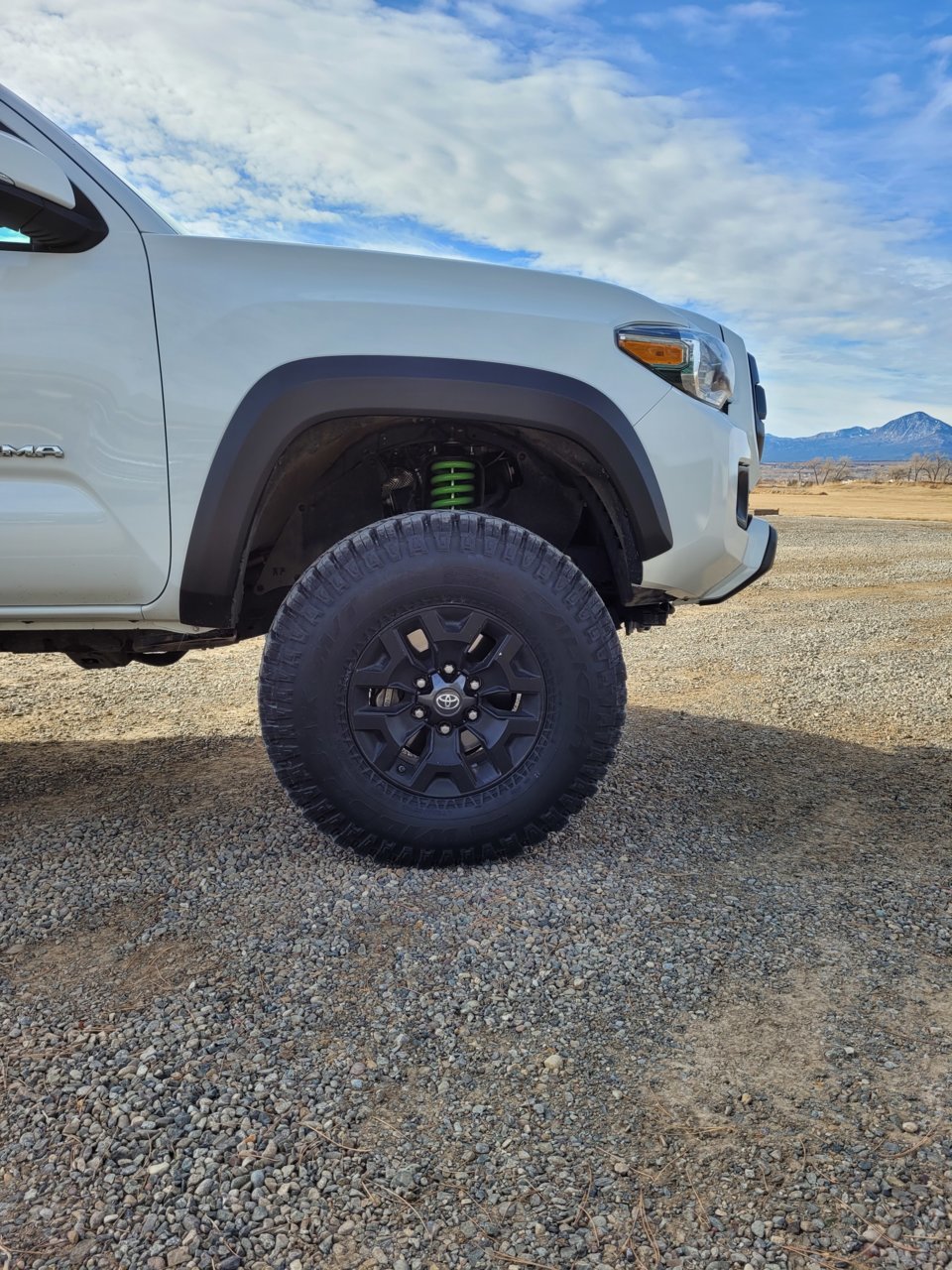

    An update on my install and performance so far. I installed the Stage 1 Nitro Kit and have about 800 miles on it. I have performance springs and leak pack. I have found the front springs to be a little stiff. The front of my truck is all stock. The rear leaf pack has been a massive improvement. I have an ARE topper and a Prinsu rack. I usually have a mtn bike or two in the bed or on a hitch rack. No sag and ride is great. I am running 255/85/16 Falken MT's. No rubbing anywhere. The ride has been a real improvement. I crawled underneath this week to check the torque on bolts (spindle, top hat, sway bar, lower shock mount, all leaf shackles, u-bolts and lower rear shock mount). Surprisingly I found many of them needed to be re-torqued. And some not just a little bit. I am not sure if any of you have checked, but you might want to.

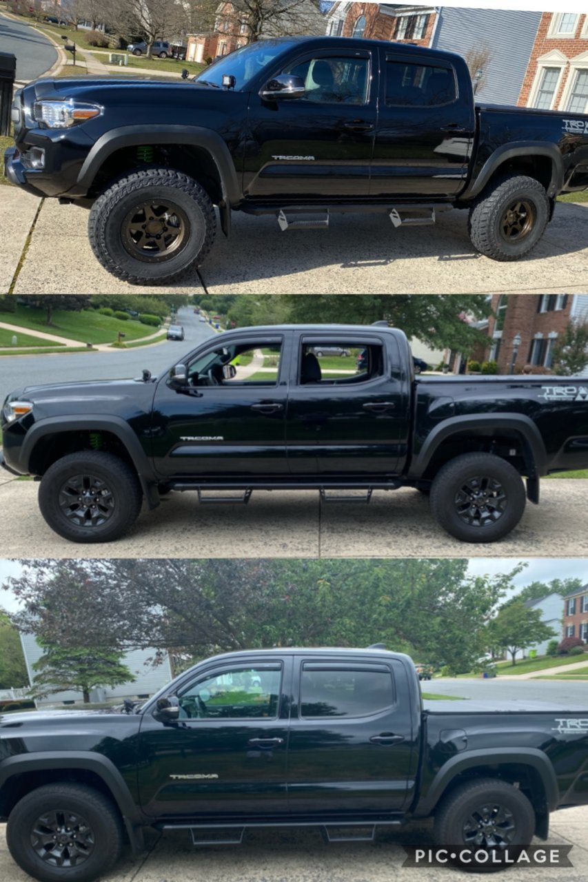

    Finished the last part of my lift yesterday with the SPC uppers and threw it the carrier bearing drop kit today to see if it helps a possible vibration at 55-60mph. Now for another alignment and should be good to go.
