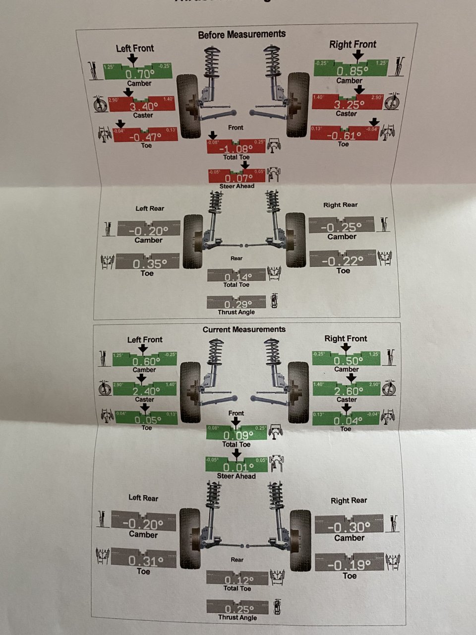

    Got an alignment done thins morning before everything started to freeze. While not the numbers I wanted, they’re better than what they were. I’ll be taking it to another one in a few weeks since I have the lifetime alignment. I could not drive it more than just home due to everything starting to freeze but it seemed to drive fine. I’ll do more testing later. Didn’t feel as bouncy either.

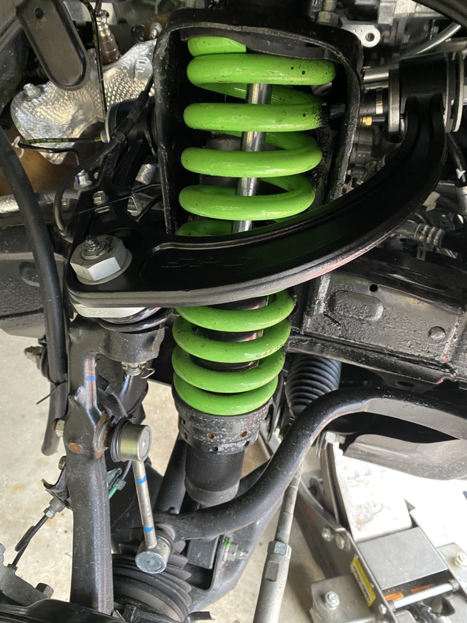

    So far a little surface oxidation on the coils or shocks and I will be hitting them up with Woolwax starting next fall. I’ve got no armor on so I can’t help with that question. So far I really like the lift though it is a little on the stiff side. @2013XSPX might be able to get you a better deal than through the IM site but with the 25% off I’m not sure. Good luck.
    Edit- You can see the oxidation on the bottom plate a lock plate nuts-
