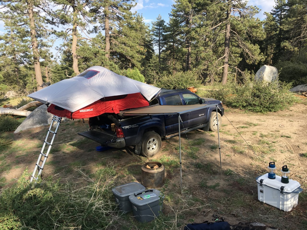

    On the Ironman stage 2 suspensions, what load rating did everyone get performance or the heavyweight constant load? Also what are you running on your rigs?
    I have a pretty stock 2014 trd Off Road, double cab with a front runner bed rack and Yakima rtt. I just got the Ironman skids and I’m still debating about switching out the front and rear bumpers, but it may wait a bit before I add that. So any advise on the load level you choose and if your happy with the ride? Thx

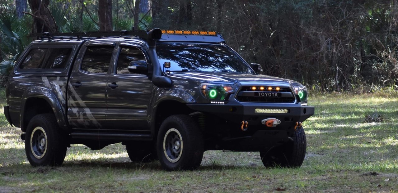

    My truck has
    Front bumper, skid plate, winch, sliders, camper shell, gear, rear bumper and roof racks. I have the Constant Load front and Performance Leafs.

    Here’s what mine looks like so far.
