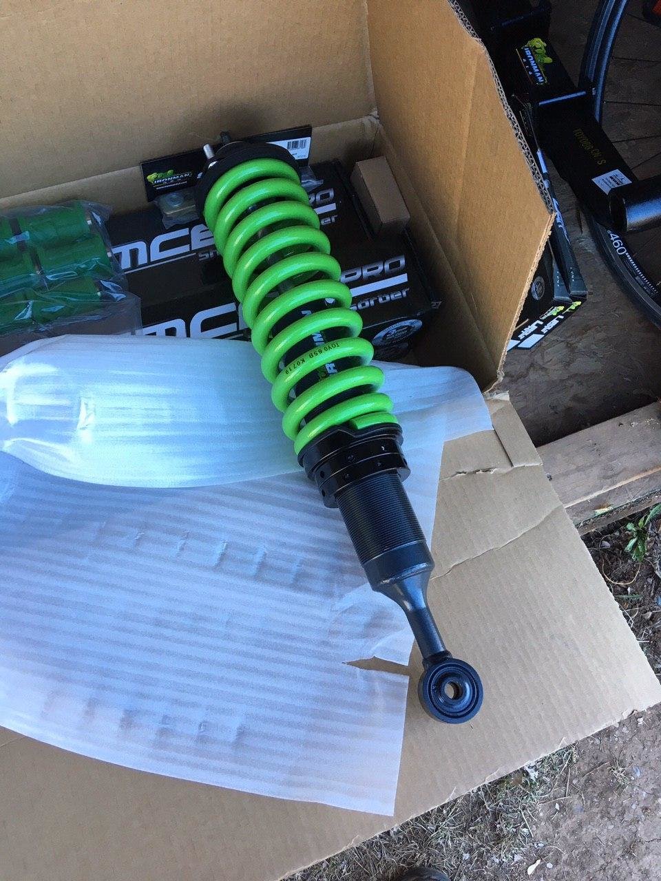

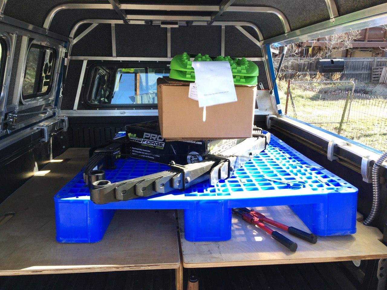

    Picked up the pallet from the depot today!

    Looks nice, hope the install goes well. That Stage 1 Foam Cell Pro looks like a very complete kit.

    Looks like Amazon special traction boards. Hopefully you didnt pay more than $60 for them

    The traction boards were a free bonus included with every order. Appreciate your enthusiasm!

    I thought I heard the were Treds?

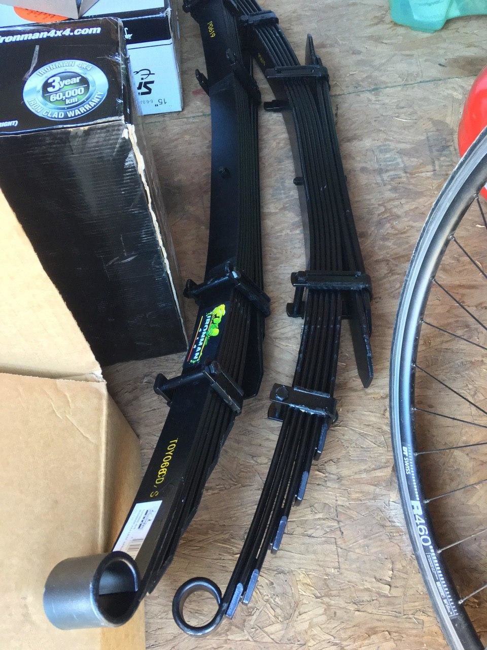

    Update: picked up my stage 2 kit.
    Front suspension went in okay. Biggest issue was dealing with the long UCA bolt as there was a metal panel in way that required bending. Got past that. One of the swaybar relocation mounting blocks was for some reason slightly off by a millimeter. One bolt couldn’t thread in so I ground away a bit of the bolt hole opening and got it sorted. Made no sense. Prolly slight differences in the tolerances of the truck bolts holes and relo kit parts. The other side went in easy.
    Two issues with rear install—-
    1. No grease supplied with leaf spring bushings. I had no silicon-PTFE grease. Just bearing grease and lithium. I used the bearing stuff.
    2. Ubolts— I ordered the heavy duty leaf pack. It’s super fat and weighs a ton. The supplied u-bolts are too short (same length as the stock u-bolts 175mm inner length). So once you wrangle the heavy leaf pack in place, the u-bolts are too short to thread on the bolts. So my truck will be on jack stands for while more until I can source longer ubolts. Just an FYI to make sure you got the right parts. Their website only shows 1 ubolt option so not sure how they haven’t run into this problem before unless they don’t sell their heavy duty leaf packs often.

    —-I was a little confused by the leaf pack labels: DS and NS. DS = driver’s side. Is it Aussie driver side or American? I sent them a message— Bubba wrote back to say that DS is in fact LHD American driver side. Couldn’t tell which leaf pack was taller. Hopefully no lean once all is settled.
