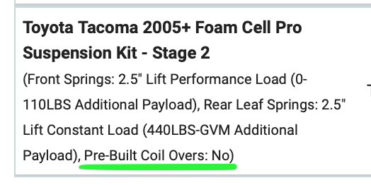

    Maybe they've removed that option since I ordered? With them being adjustable, there's really no reason not to get them assembled.

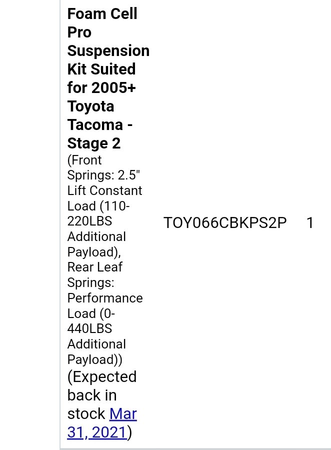

    Screenshot_20210315-225334_Email.jpg :notsure: that doesn't show up on mine, and it's not an option when ordering. And they're out of stock on spanners. I assume others will work, it can't be proprietary can it? The ones in the product links below should be fine I would think.
