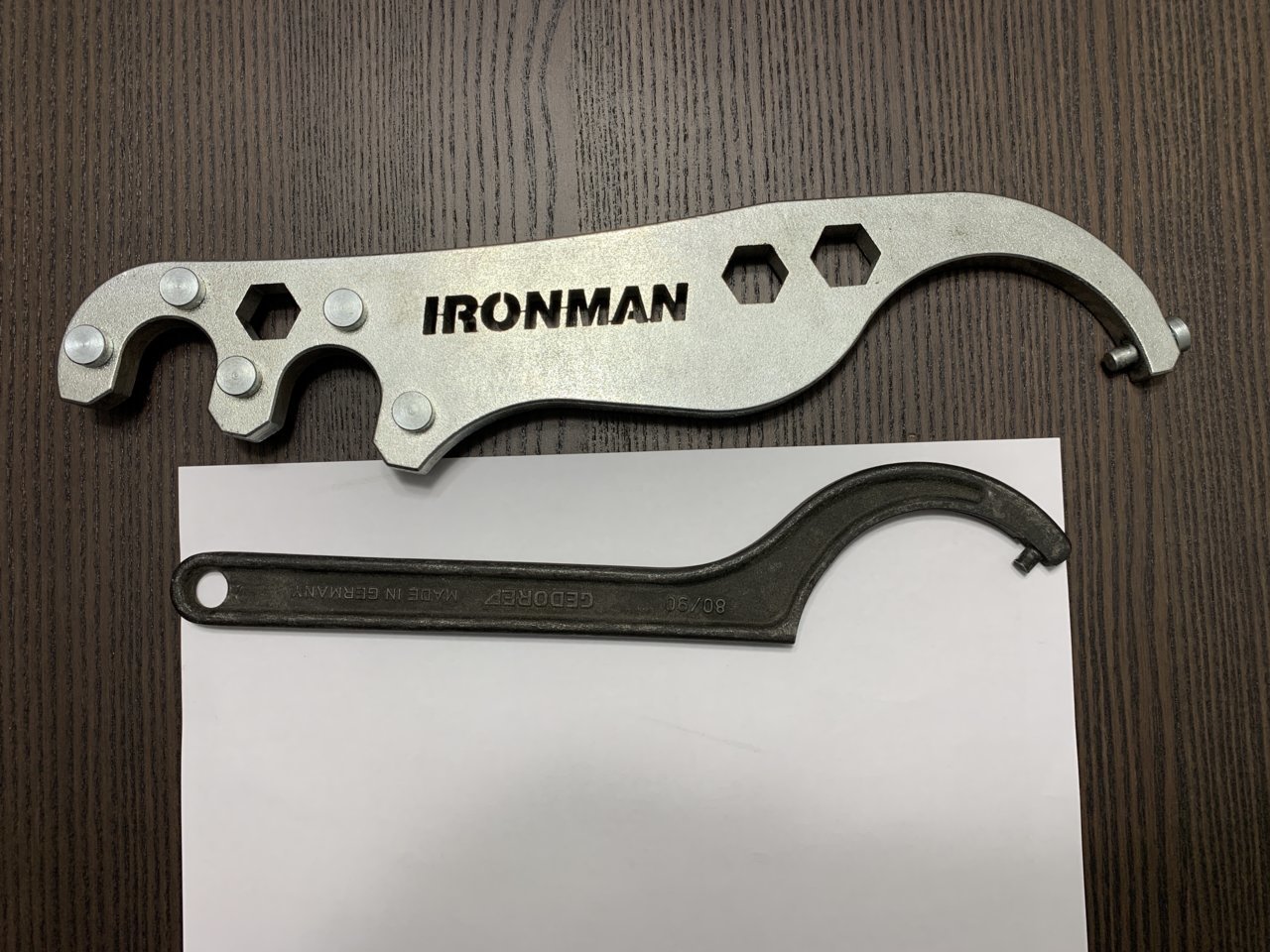

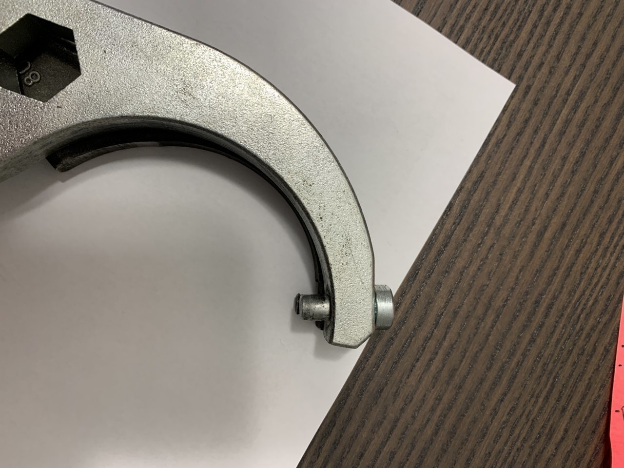

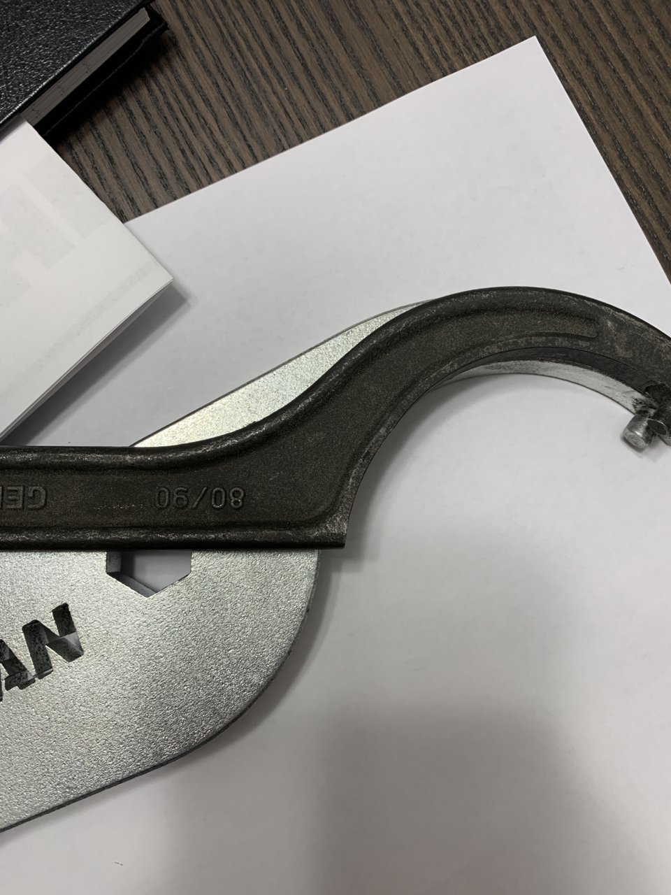

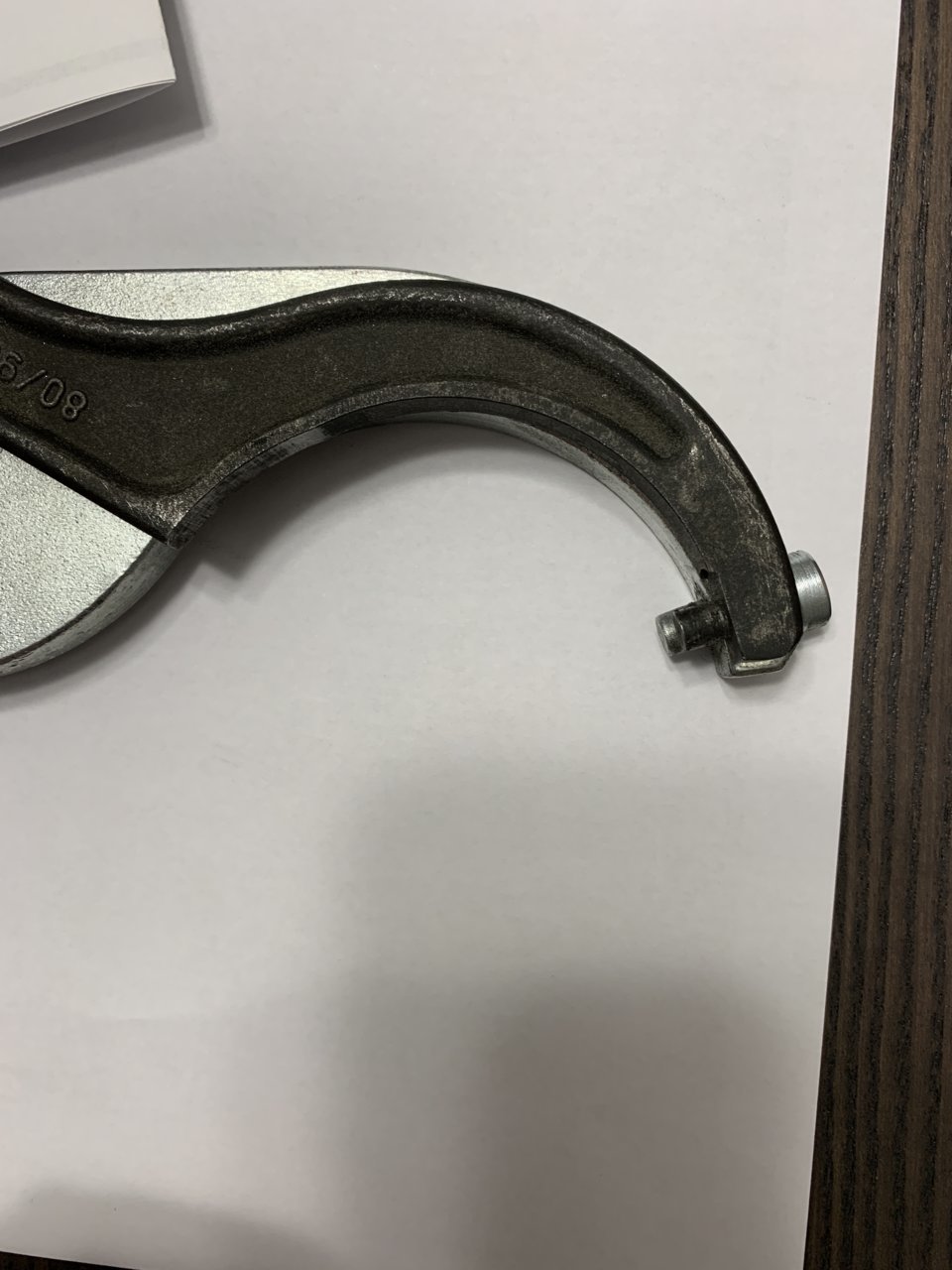

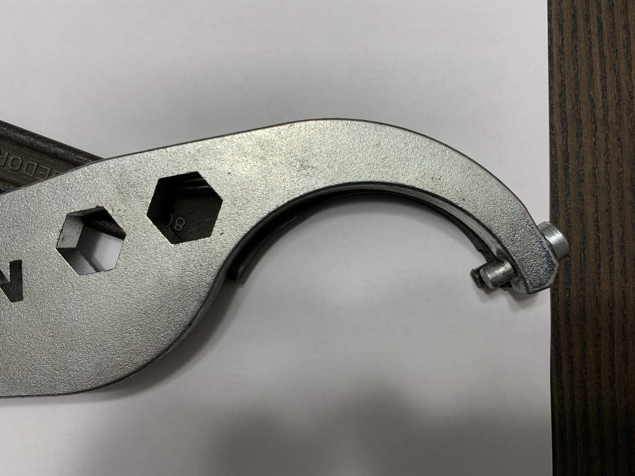

    @Jojee117 & followers,
    Here are some pictures of the Ironman tool vs the Amazon 80-90 Hook Wrench for comparison.
    For starters, I WAS able to lower the suspension while on the truck with the wheel removed using the Amazon 80-90 hook. It required a breaker bar and more sweat/effort than I expected, but it is possible!
    It was not a perfect fit on the circumference of the adjustable strut spring seat which caused some scratches and wear marks on the finish. Not the end of the world and probably not a deal breaker for me, but worth mentioning.
    First pic is intended to show the slight difference in the "circumference" of the two tools.
    Pic 2 is just a different angle of pic 1
    Pic 3 is the same, but has the IM tool on top of the 80-90 to show the difference better
    Pic 4 is just a different angle of pic 4
    Pic 5 is a side by side in size/build/design.
    Obviously these tools were each designed for different uses, but after buying both, if I could go back, I would buy the IM tool at the same time as my suspension.
    That being said, as mentioned, with a breaker bar and wheels removed, the 80-90 WILL adjust the suspension while on the truck!
    The Ironman tool is designed to be an all in one tool, and is capable of tearing apart the struts for rebuilding whenever you get to that need. And in true Ironman fashion, it's heavy as shit!
    Wish I could get a pic of each on the spring seat, but pics don't do justice trying to work around the tires.

    Great write up! I have that one from Amazon and tried it about a month ago. I didn’t have a breaker bar that fit so I only got a few small turns before I stopped and agree with what you say. I may by the right tool one day but think I’ve not seen it in stock too often. I do want to lower mine 1/4-1/2 inch at some point but I don’t wanna screw up the alignment right now.

    I've been working with the same shop to get everything dialed in after I self installed (lowered spring strut further, rotate tires & alignment) I've now got an appt to get the ECGS bearing installed, they're waiving the post alignment fee since they had the first ideas to work through the vibrations. I've definitely seen improvement, but its still a work in progress. Maybe something to be said about finding a shop that "gets it" and will work with you to get everything dialed in.
    As mentioned, I haven't personally used the IM tool for adjustment, but I know the shop did and they didn't gripe like I would have with the Amazon tool! haha

    I do wonder how you could get a cheater bar on that ironman wrench being that it's shaped awkwardly. I guess you could try a breaker bar with a large male hex socket in the end of the wrench. I don't know if I'd trust that much torque on of those bits though. Maybe lie a bar in-between the bosses on the wrench? Do you know if the shop removed the shocks to adjust, or did they do it while they were still on the truck? Otherwise if it gets tough I guess you can always whale on it with a deadblow lol.

    Sorry if I wasn't clear. I used the breaker bar with the 80-90 hook, not the IM tool.
    When I dropped it off at the shop, I left the IM tool on the seat for them to see/use. They used the IM tool to adjust while still mounted on the truck, I assume no breaker bar. As you mentioned, IM tool is an awkward size and shape to get a breaker on.
    Jojee117 likes this.

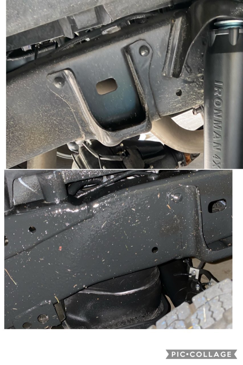

    You can spray it with Woolwax or Fluid film. I liked Woolwax, it was black, didn’t smell as bad, a little thicker and claims not to mess up rubber/plastic like FF can. Based on the claims on WW site.

    I'm so hands on with my vehicle, I'm curious... is that stuff not uber tacky all the time? Like, what about collecting little rocks and bits of dust? Does it not pick that stuff up while its active? I was cautious about using it for this reason and so externally hit some of the gear with some Por-15

    It does stay tacky and will easily get on your hands/arms/head while working. It does collect something like dirt and grass but it usually falls off. It’s kinda like a grease. Here is a before and after. I have too many pictures of my truck on my phone but I always find a use for them lol.

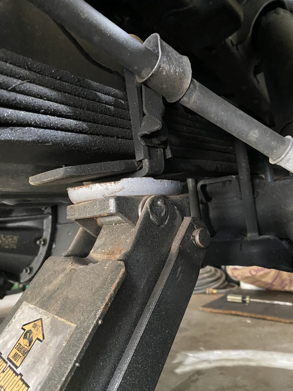

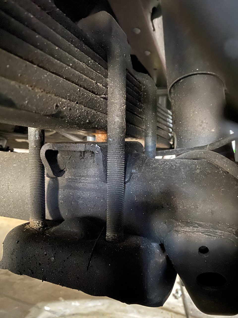

    How did you go about your axle shim install? Did you need a longer center pin? Any concerns about the length of the center pin and the axle not locking into place?
  16. Mar 17, 2021 at 5:46 PM
    #1416
    hyrule_trd
    hyrule_trd It’s a Secret to Everybody
    Jan 26, 2020
    #317260
    9,773
    Eric
    Harford County, MD
    2020 Black TRD OR
    Ironman Stage 1 Foam Cell Pro lift kit, 255/85/16 Cooper ST Maxx, SCS BR6 Wheels, SPC UCA, Heated seats, MESO TRD start button, Meso Total Tail v1, Meso V5 mirror white DRL turns, bed decal, ditch and hidden bumper lights, screen protech, RAV4 radio knobs, steering wheel anytime camera kit, dash cam, ECGS bushing, Timbren Active Off Road bump stops with Wheelers flip kit. 35% Xpel CS Ceramic Tint, KD Max Tune, SumoSprings front bump stops, RRW Sliders ‌ ‌ ▲ ▲‌ ▲
    Using part of my write up from another thread. I also use the slotted shims from Headstrong Off-road.
    Depending on your shims and comfort level will change what you to. I ended up removing the front u bolts and jacking up the leaf spring from the front. The shims are just a little too wide to fit between the u bolts. Which is good, now I’m pretty much not concerned about them sliding out.
    I jacked up the front of the leaf just enough to fit the shim in there. If yours is not slotted and only has the hole you’ll need to go up higher. I also removed the brake line bracket on the leaf spring just to be sure it didn’t stretch. It looked like there was still a few mm of the center bolt going into the axle.
    The vibrations are mostly gone. You may end up needing new u bolts, or buying the smaller shim. There was only .5-1.0 thread on each end. Since then, I’ve bought the Wheelers ubolt flip kit with Timbrens active off road bump stops. Hoping their here Friday. I’ll take another look when I put the flip kit on and let you know.
