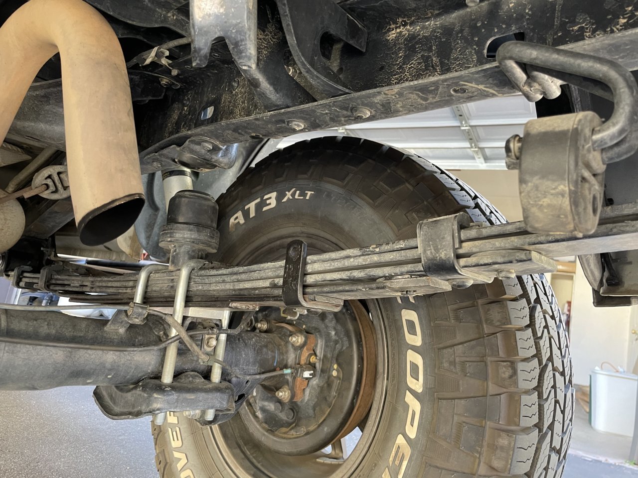

    Read through the entire thread and I'm still having trouble deciding if I should remove 1 or 2 leaves from my constant pack.
    DCSB w/:
    sliders (150lbs or so)
    full skids (one aluminum, 2 steel 100lbs)
    DIY GFC (300+lbs)
    I want to be brave and only pull the 5th leaf and leave the third in since I easily carry another 100+ lbs when I'm loaded up. I'm also eyeing a new rear bumper. It seems like @FashTaco, @mandog, and @dabbinuguay all have similar loads to me, but have all pulled the 3rd and 5th leaf.
    Hit me with some sage advice. Otherwise I'm going to probably only pull the 5th leaf and I can be another data point.
    Here's my current setup with a semi-custom 3 leaf AAL that is getting pretty flat...

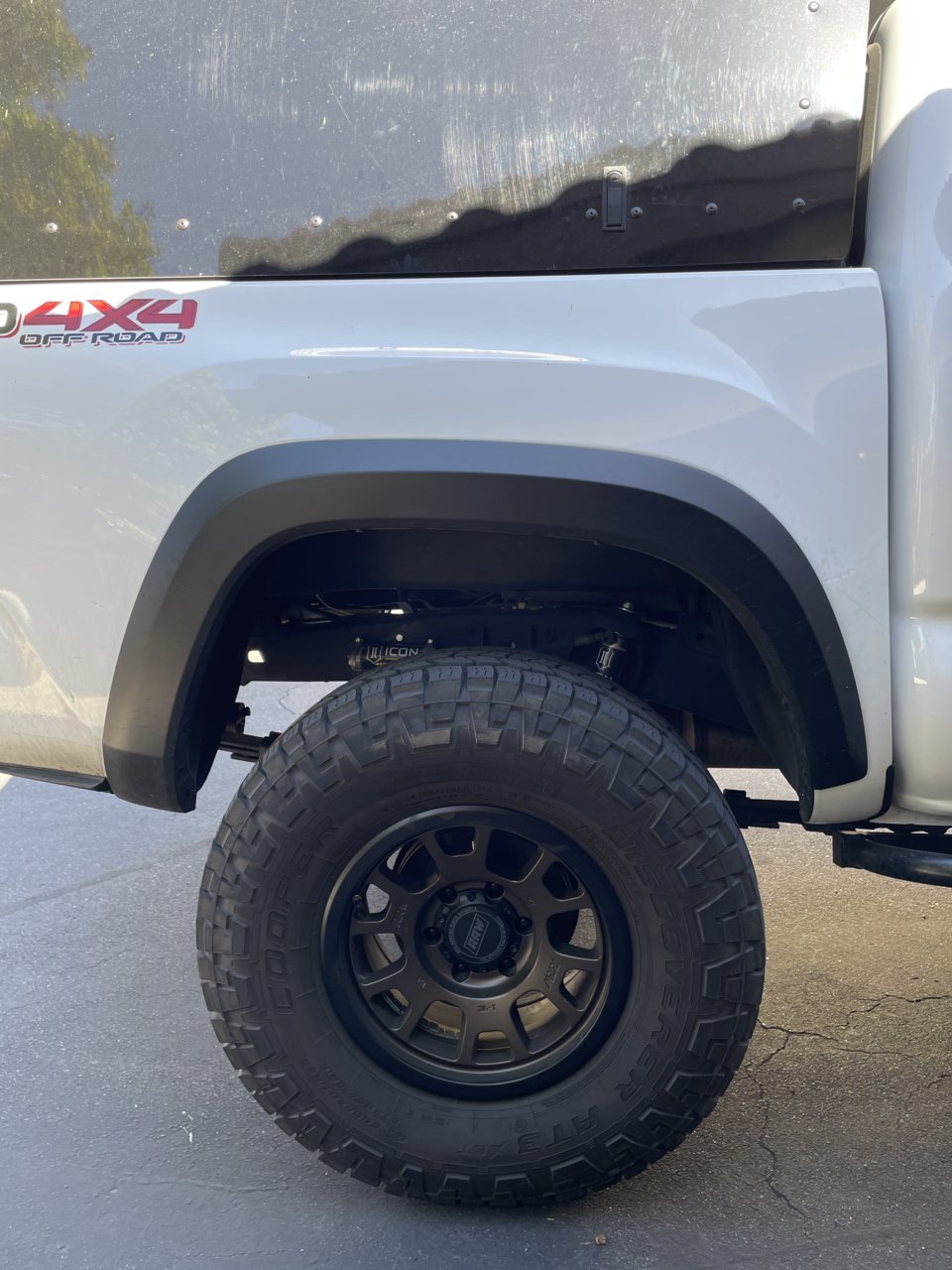

    Got my camper installed a few weeks ago, and this is where I'm sitting with 3rd and 5th removed from constant load leaf pack.
    Before the camper, I was carrying around 400lb of rock in the bed, to simulate camper and help the suspension settle in a bit.
    Coilovers in front were dialed back a bit at install, so its not the full IM lift in front.
    Have a minor driveline vibration I still need to dial out in the back. Have the IM carrier bearing spacer installed, but still have a little at 20-15mph when slowing down.
    Pretty bad groan/creaking sound coming from passenger front coilover, haven't figured out what's going on there yet.
    Still need to install the IM UCA's, hope that sorts it out.
    Tires shown are 265/70/17 Grabber ATX, i'd say maybe 35% tread left.
    I'm going with skinny 33's in the fall, and build out the back a bit more this summer, and reevaluate suspension height then.
    So far I'm still happy with 3rd and 5th leaves removed.
    If I ever add a bumper and swingout, then may need them back.
    Sliders, 3piece skids (alu), Camper (~350lb), and bed is empty:
    Maybe another 250lb added. (Group31 battery, 3 Yakima bars, Gas, Water, camp gear, etc...)

    thanks for the detailed response. It seems like with 2 leaves removed the pack still handles extra weight extremely well. Do you have your spare under the bed still?

    Yeah, i keep full spare underneath.
    The IM leafs are super beefy, they definitely handle weight well. I'm glad I went the route i did, even though I'm not sure if I'll ever use those extra leafs.

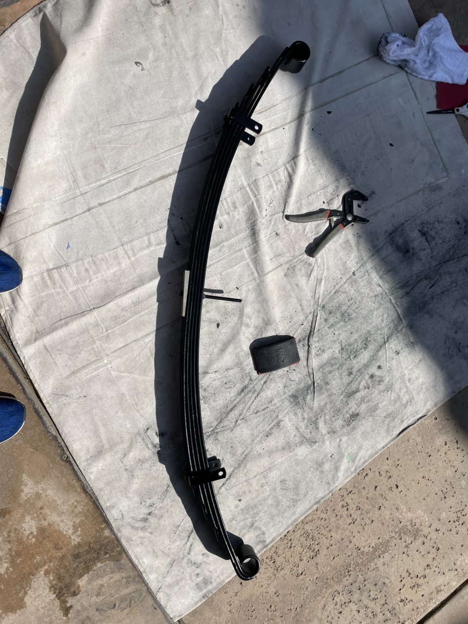

    Got my leafs today and man... that paint really is awful. It’s thin, fragile, and flaky. I’ve split one pack and sanded, prepped and painted them with some automotive enamel.
    I was also considering instead of removing leaves 3 and 5, doing leaf 5 and one of the overloads. I think this would provide slightly more lift, while also allowing for a bit more suspension flex. I think 2 overloads might be overkill for what I do 95% of the time. Will update with what I do.

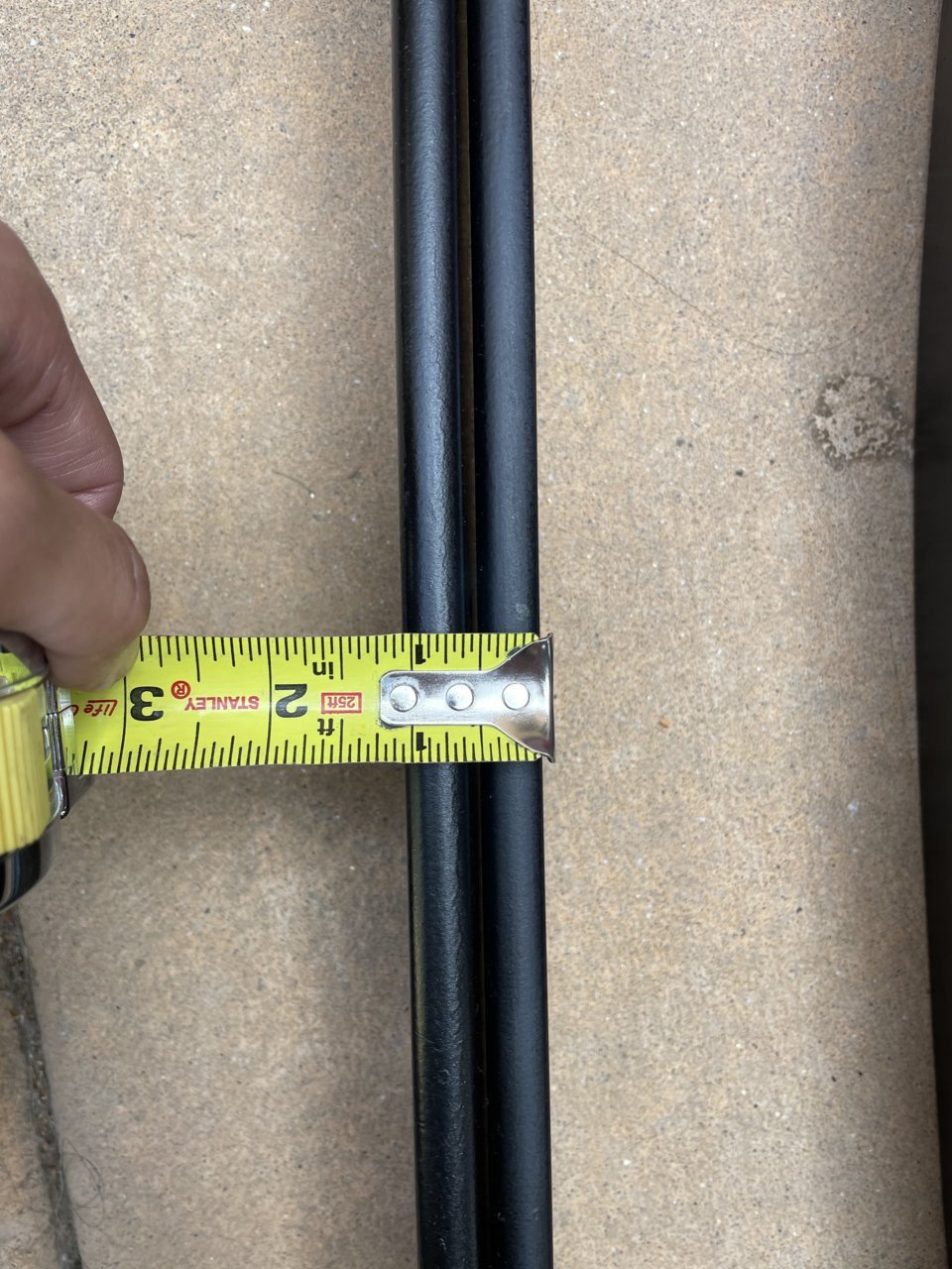

    So I’ve decided to experiment and remove 2 overloads and the 3rd from the top leaf. I’m not a huge fan of overloads and I’m going to be moving to a mid travel shock setup so they could potentially impede some of the flex I could get from the leaves. It’s entirely possible I’ll still be over spring so we shall see.
    The two overloads measure 1in thick so removing those should already drop me from the max lift of 5-7 down to 4-6 and removing the 3rd leaf is about a 1/3 of an in thick which should bring me down ever more.
    I have a 3000 mile road trip that starts on Wednesday so plenty of road time to get some seat time.
