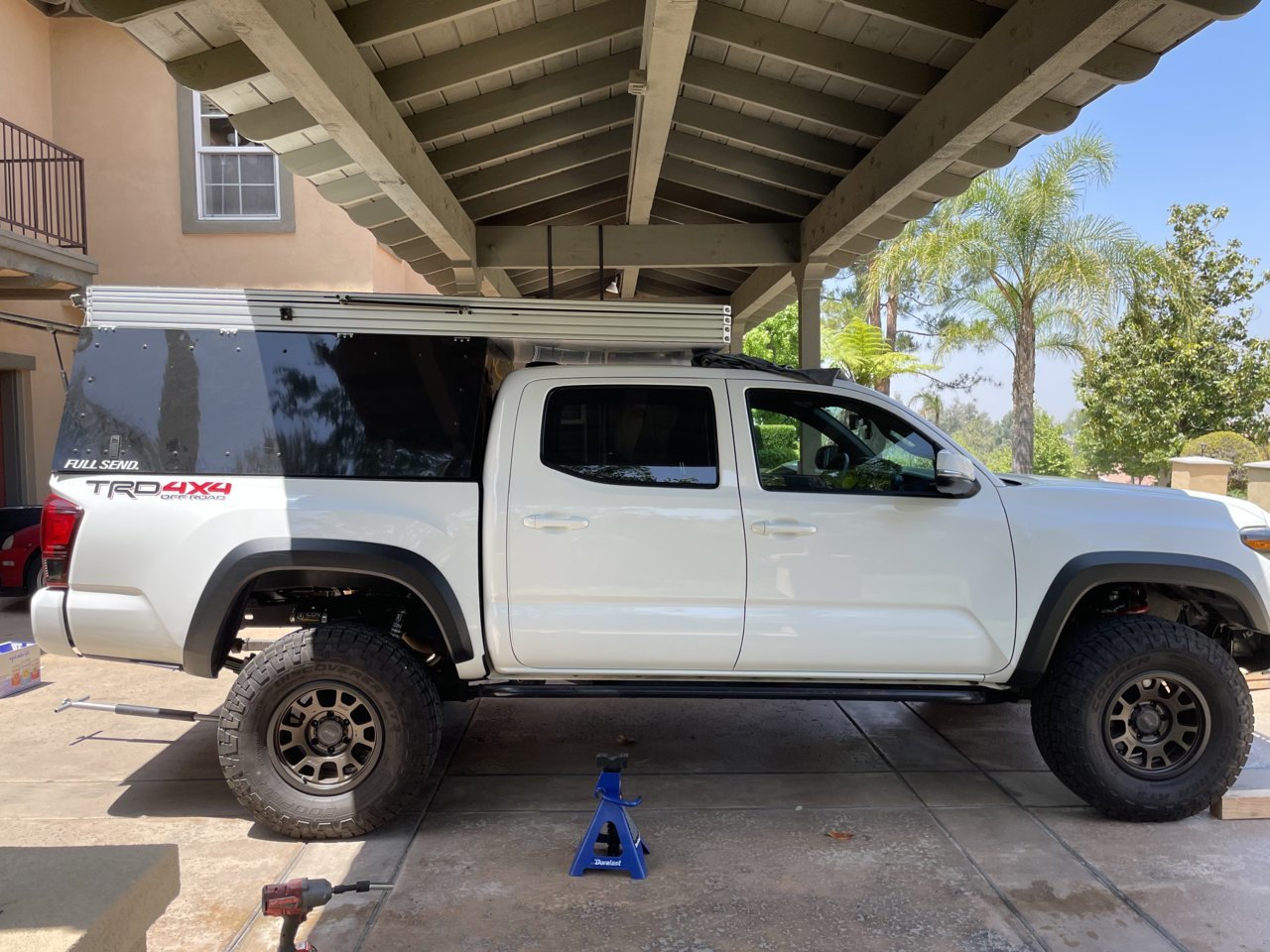

    Haven’t driven it yet, but here’s how she sits. About an inch and a quarter to a half higher on each side. My fronts only have like a inch of preload so I’ve got a pretty serious rake going on.
    Measurements:
    Passenger rear 24 3/4in
    Driver rear 23 3/4s
    Passenger rear after 26
    Driver after 25 1/4
