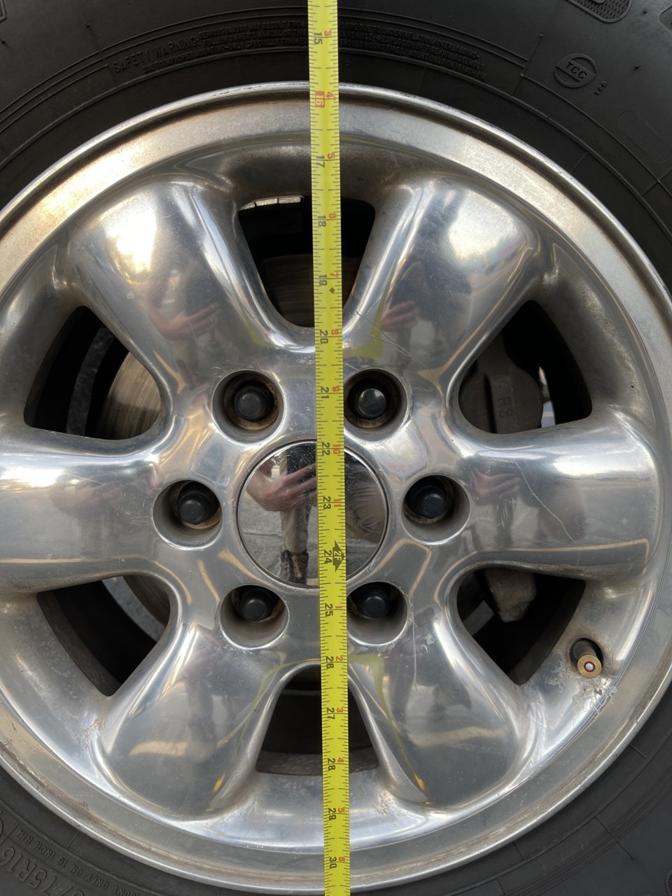

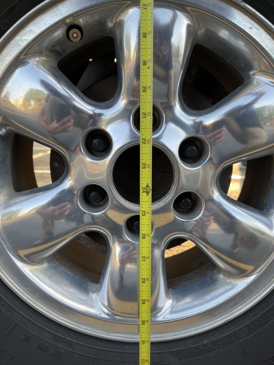

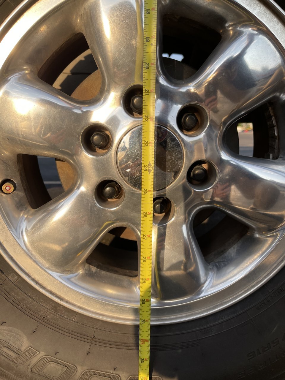

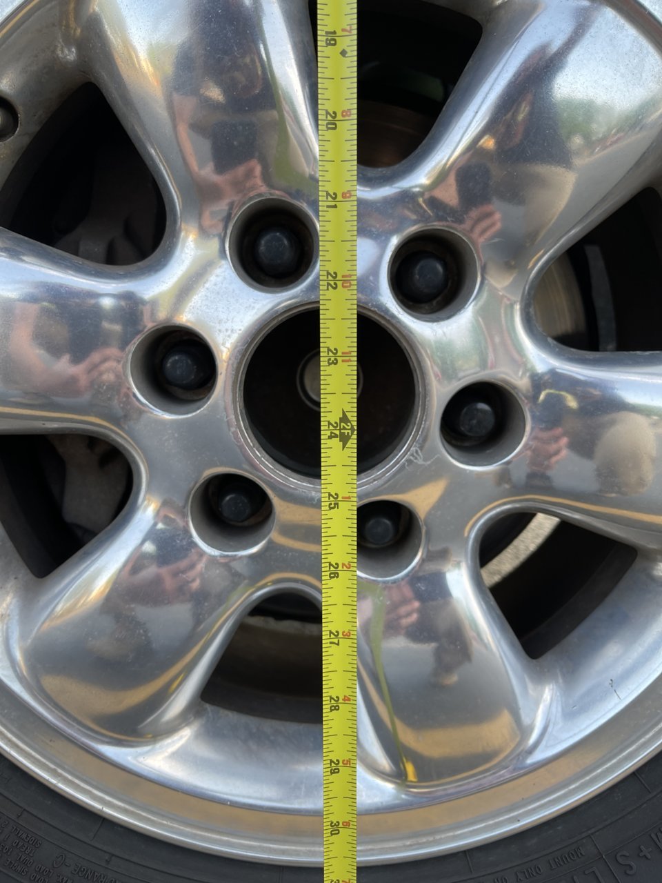

    I did not have the cap at the time of install, that came a couple of weeks later.
    I just measured them again, I’m in a fairly level parking lot.
    Rear Driver
    Rear Passenger
    Front Passenger
    Front Driver
    Looks like they’ve all settled around 23.5”.
    Why the front still looks higher, I have no idea.
    Theeangelow[QUOTED] likes this.
