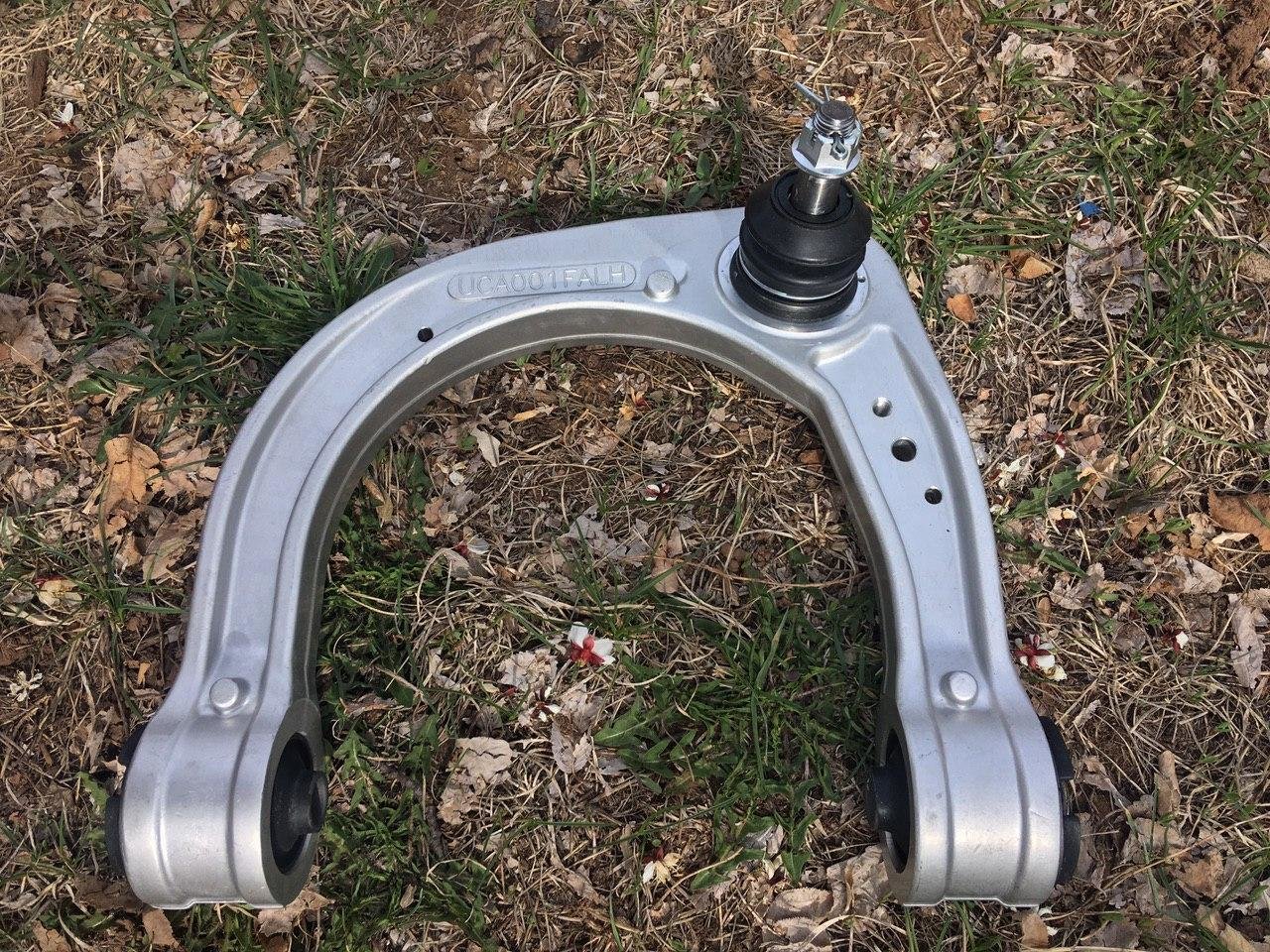

    The Ironman website describes their UCAs as "forged, with hardened zinc coating" which was surprising given they appear to be aluminum and not steel. I'm pretty sure they are aluminum as they're non-magnetic and very light, despite their visual bulk. I hadn't heard of zinc cladding being an alternative to anodizing for aluminum.

    Yeah they called it drop forged aluminum. I recall it from one of their videos on their ucas.

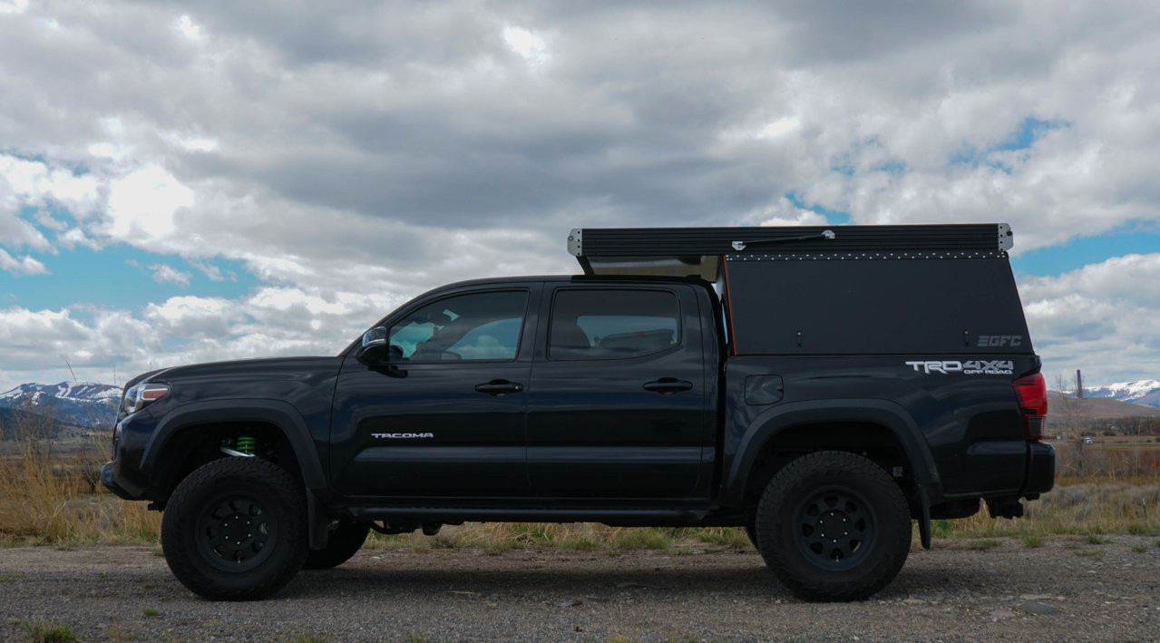

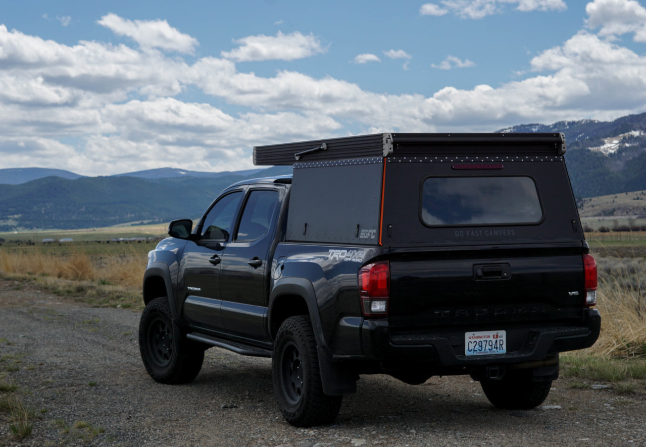

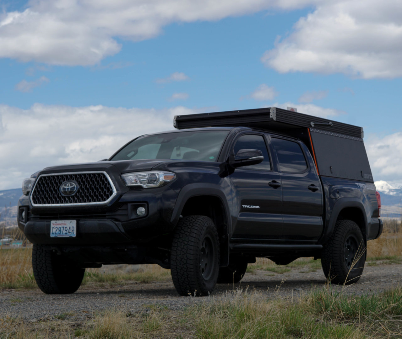

    Just to add some light on the Ironman 4x4 Foam Cell pros + UCA. I have been running them for about 9 months and have loved them so far. I think that everyones reservations of them being such a new company are reasonable as they don't have a TON of review in America (they are gaining traction). However, they are a giant in Australia and have been historically used in military vehicles given their capable/reliant nature.
    For me it was rather difficult to sift through suspension reviews, as its always king, fox, old man emu, bilstein and icons. As per all reviews, some were positive, some were negative and most of them were beyond the scope of what I wanted to accomplish. My point here is don't let the lack of review turn you away from a quality product. I had the opportunity to speak to a couple individuals in the PNW running these and have been more than pleased, who also had the same reservations and looking at similar setups as I was. A lot of the reviews initially came from the aforementioned land cruiser users, rovers, etc.
    Anyways, if you're looking to have weekend fun, take on obstacles that normal clearance isn't capable of or looking for greater performance than the TRD OR offers these are the perfect quality/price point. My issue was performance with accumulated weight from, sliders, tires, drawer system, mountain bikes, bike rack, pivot arm swing, Go Fast Camper etc. and these fit the bill to a T. My conclusion is, if you're looking for a high performance, reliable, cost efficient and very capable suspension system, this is it. I too was a victim of looking into higher end suspension with resi kits etc. however it wasn't reasonable for what I was doing. In fact, I probably would of left a ton of performance on the table that was never needed, but paired with the tuning and maintenance those kits come with. However, if you have the money to to spend on those set-ups than thats an understandable preference, but I don't think your missing out on any performance with the foam cells. At the end of the day, suspension is a game of what you're looking to accomplish and whats going to allow you to hit your goal.
    For me, its carrying a higher weight capacity for rock climbing gear/bikes/camping/dogs etc. Being able to have confidence in getting to remote areas (while always carrying recovery equipment), having a good experience on and off road and not breaking the bank and low maintenance costs. The Ironman 4x4 has crossed all these boxes for me and I couldn't be more pleased with money spent and outcome of my trips.
    Im using their Foam Cell Pros, Coil overs, rear shocks, leave kit and UCA's.
    Pics20200501-DSC01475.jpg 20200501-DSC01469.jpg 20200501-DSC00215.jpg for attention.
    Shaggs, mandog, hyrule_trd and 4 others like this.

    Sorry but I need to ask, what size wheels, BS/offset and tire size do you have on there? Tough to tell tire size in that pic.
