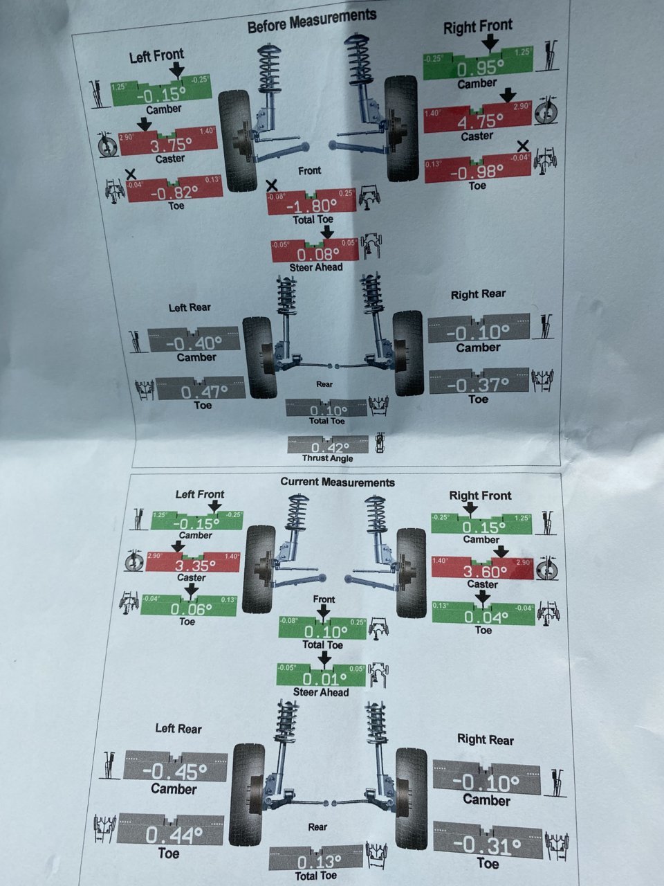

    Got another alignment done, was just a little out… so far, I’ve not gotten it to rub.

    Sounds good, hopefully it’ll settle where you want. I’m going to start looking for 4WD components soon.
    Those look pretty good.
    I need to find a shop that can get those numbers for me, like an off road place. Everybody I’ve tried says they can’t do it. I’ve walked out on two shops over that crap.

    I bought the lifetime alignment from Firestone and have been there 3 times including today and the dealer once for the alignment. First time at FS was lift, stock tires and oem uca. Second was at FS with new wheels, tires and spc UCA. They kept stock specs even though I gave them the numbers I wanted. Also hit a pot hole that knocked/slid the UCA balljoint nut out of place. After that I read up on how to do an alignment at home moved from “C” to “D” and torqued the crap outta those top nuts (didn’t have a socket for the first adjustment so they were only unga unga tight, not properly torqued). Also moved the wheels forward with LCAs so tires would not rub. Took to dealership for 1year oil change and alignment. Got much better numbers, but they moved the wheels back and they would rub occasionally and I had to take the mud flaps off, still some rubbing. Before I took it this time, I moved the wheels forward again and got those numbers. I’ll put the mudflaps back on see if there is any rubbing later.
