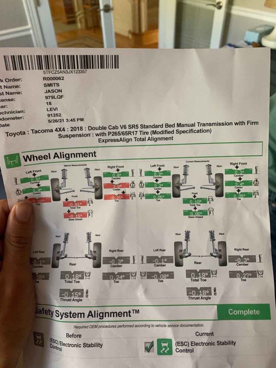

    Here's my alignment sheet Ironman FCPs and SPC UCAS. Done at a very good off road shop, zero rub at any articulation with 285/75r16s.
    (right side is current)

    Those numbers look good, and no rubbing on top is really good. I still have minor rubbing but I can pretty much avoid it all.
