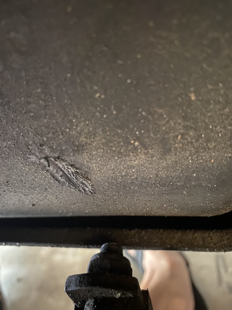

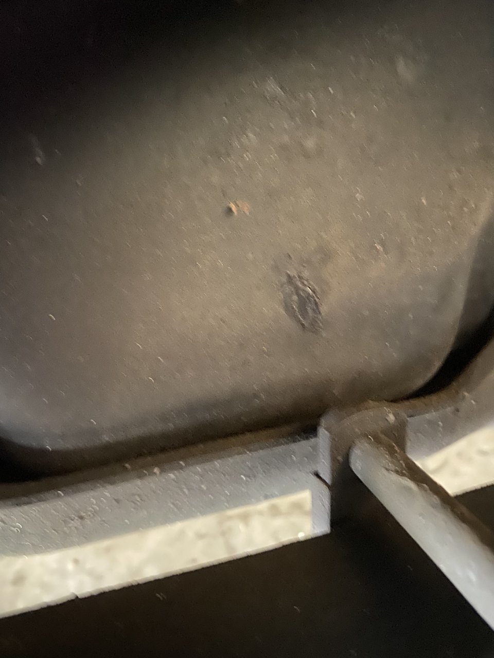

    I was checking out my suspension and tq stripes today and noticed what looks like the leaf pack shackle bolt rubbed the fuel tank. Not sure if that could happen from driving or when I was at the beach or when the fuel pump was replaced. I tried but would not be able to swap the bolt around for the head on the tank side. I took a few metal SS fender washers and put under the bolt head now only 1-2 threads stick out. Should not be an issue anymore.
    While typing this, even though I knew I put them on the correct sides, I made sure the N/S leaf was on passenger side. It was/is on the correct side.

    I feel like that bolt needs to be inserted the other way with the nut facing away from the tank. Maybe they messed up?

    Yea, looks like it. I’ve got an off road trip this weekend but next week I’ll drop the front of the leaf and turn it around. I’m pretty sure it’ll be ok…

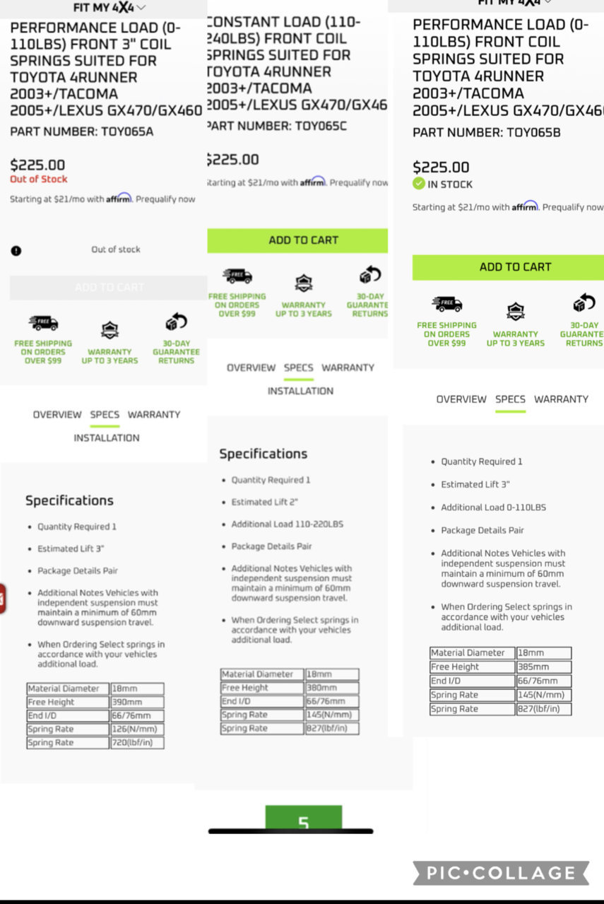

    Someone had asked a question about this on my review thread and after seeing @jasmits1 response I looked again. IM lists 3 springs on the site for Tacoma’s. The performance 2.5,3 and constant load. For some reason I had thought the 2.5 and 3” were the same and the constant were different. I was wrong, they are all different, though the 2 performance both say 3” in the specs. I’ve no idea which I have since they only listed it as 2.5-3” when I bought mine a year ago and don’t have a box…. Maybe I can find the number on the spring…
    Not sure if this will help but you can look at the rates and maybe figure out what’s going to be best for you.

    Thanks for the advice! I never thought about doing separate front/back as I assumed it all had to be the same - but this makes more sense for me as the only major source of weight will be the camper in the back.
