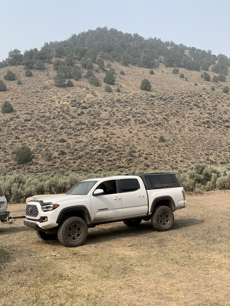

    I pulled the leafs (leaves?) prior to ever installing. Just reading through this thread told me the constant load would be way too harsh for my truck. I'm currently running the RSI SmartCap, so we're in a similar position. I've been on a couple camping trips with the usual items, as well as trips to Colorado and back, with quite a bit of shit each way. Really happy with the ride and lift achieved. Not sure if I have any recent pics... lemme see if I can post current setup and give you an idea of how it sits.
    Edit- Added pic from 2 weeks ago.

    Great pic!

    Yeah that looks really good! Nice spot.
    I’ll have to give it a try and see how mine sits.

    Thanks! Was a smokey weekend, but couldn't resist getting out!

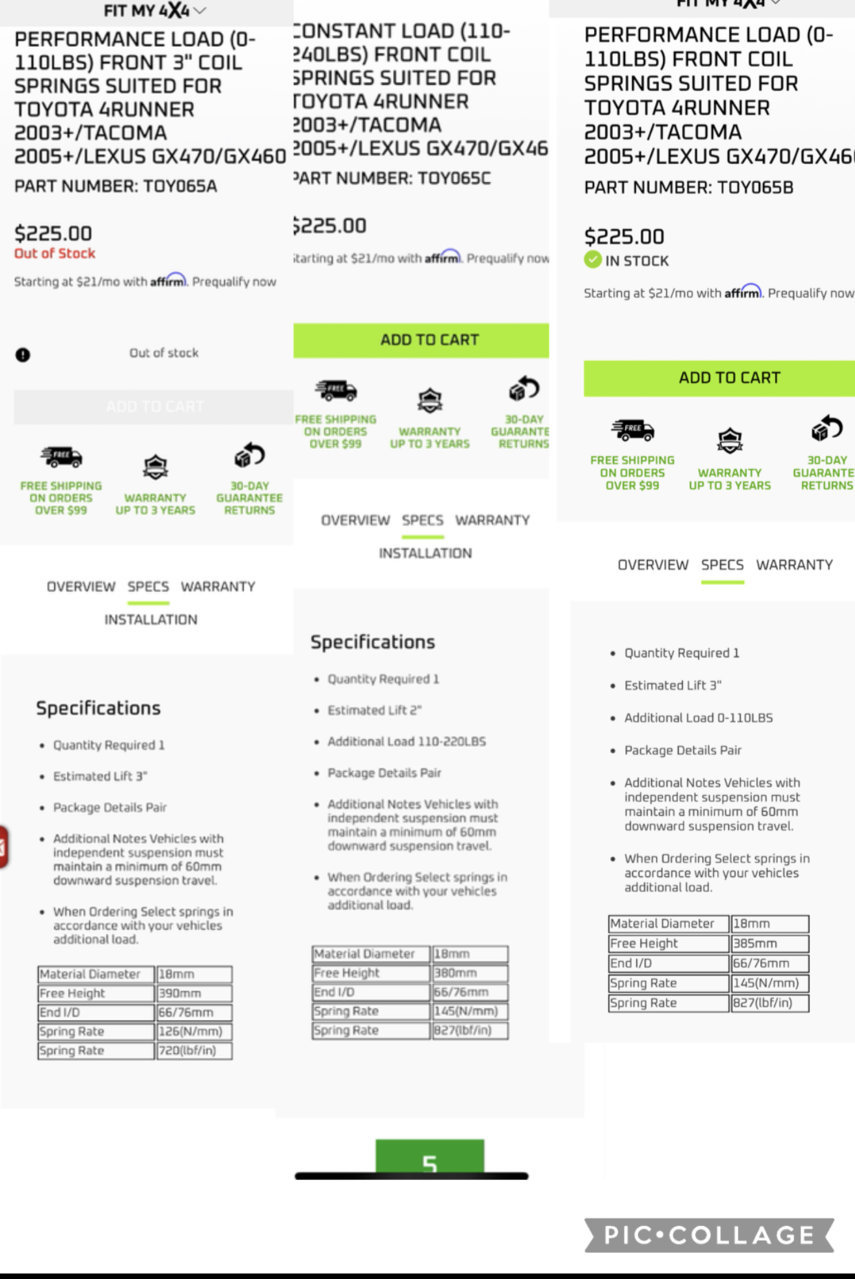

    I'm confused. Yesterday was checking out the performance vs constant load springs and saw both had the same 827 spring rate. The only difference was the spring length.
    Edit: Ah, they list two different spring sets as "Performance". The parts numbers end in A or B.
    I'm not hating my current ride quality. It's worked well, but if I can get a little more cush up front, I'd dig it even more. May be I'll order the lower spring rate Perf springs.

    I’m with you, I do like the ride but would like a little more cush in it. But I would not want to sacrifice getting the roll and dips back, which is what I worry about…
    I took a look and have the “B” model on mine. It looks like there is 10mm difference between the two performance as well as the 100lb spring rate.
    I posted this pic somewhere here before but now it’s more relevant.
    While I wait for my slider invoice I keep looking into King springs (only a few choices of 3” springs) and thinking I would get a used set of 600lbs (maybe 650lb but I dont plan on weight other than sliders (maybe skids if I’m really lucky)) if I could for a good price. The only thing I’ve not figured out is if I can make up for the 1-1.5” spring height difference by just adjusting the collar by the same amount without any unintended consequences. Anyone here smarter then me know?
    I found that King and Ebach have 3” I/d x 14” springs. Anyone have other thought?
