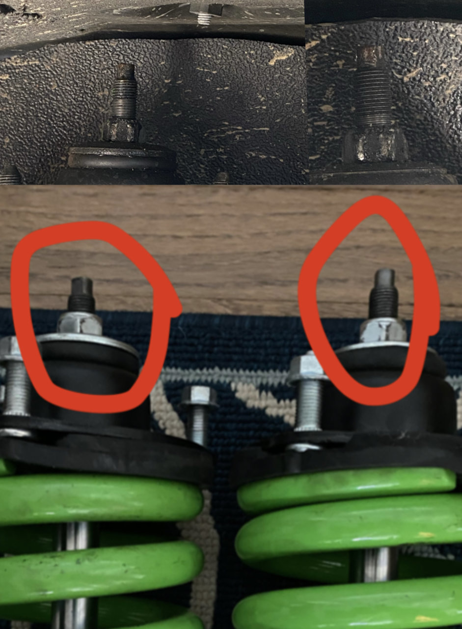

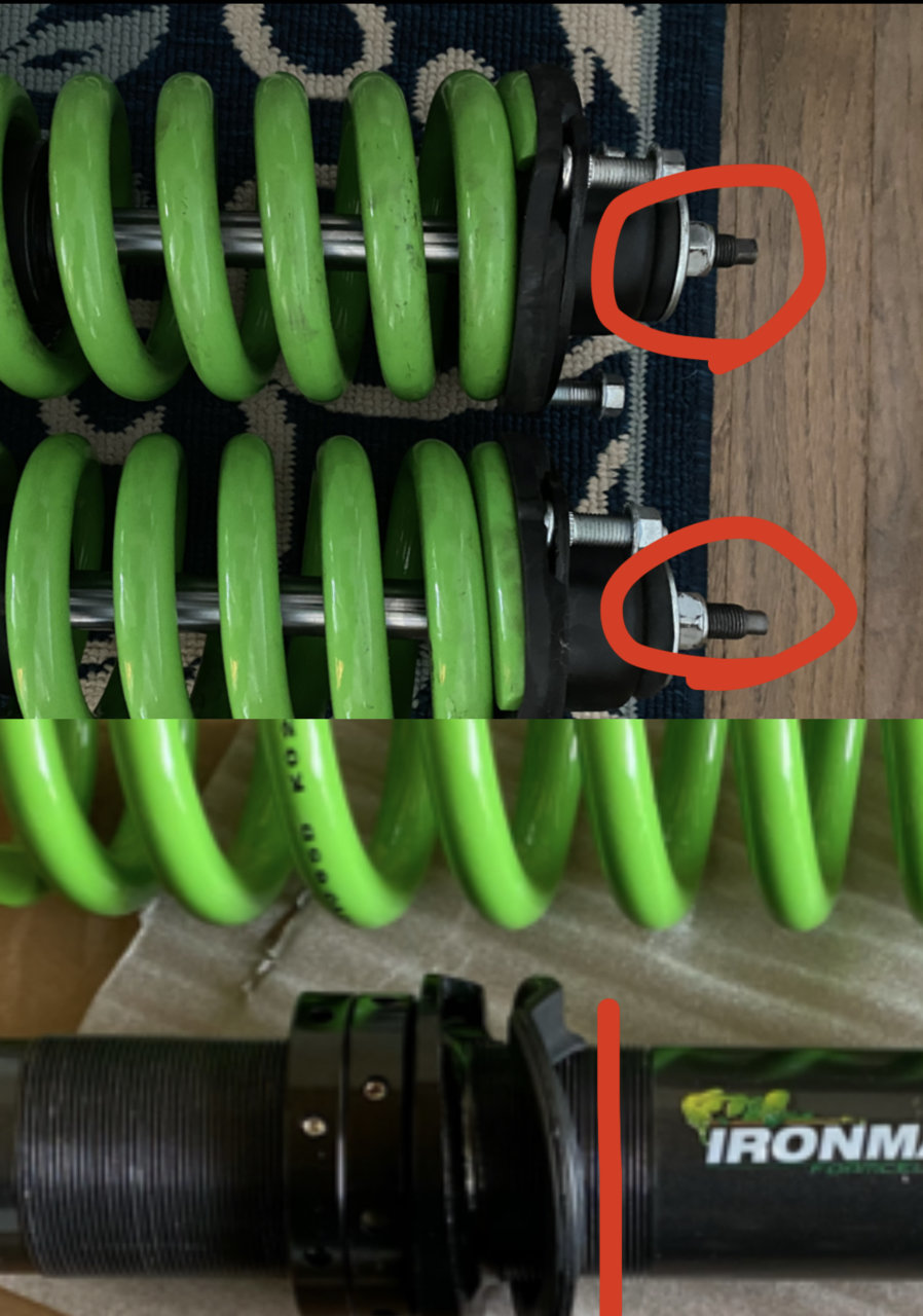

    I shouldn’t assume that all work done is right even when done at a shop…
    I’ve had my kit installed for over a year now. I had the shocks/springs put together at a local shop. Well, I had assumed that everything was right and didn’t notice anything odd. Well, while looking at different springs to put on I rewatched the IM coil build video. During the video Chris said that you don’t need to torque the top bolt, just tighten it till it stops and you’re hood to go. I looked at a pic of mine before installed and they we’re definitely not tightened all the way. I went out and fixed that today and got quite a bit of turns on one and a few on the other shock.
    Just throwing this out there in case anyone else had their shocks built at a shop other than IM.
    Now onto the springs I’ve been eyeing. I saw a set of Fox 3.0 for a really good deal but they are 13” while the IM are 15.15”. If I put those on, would I need to be concerned that the spring perch would only have a few threads showing above?
    See the pic for both things, the top shows the strut tops not being fully tightened and the bottom shows about where the spring perch would be with 13” springs just set roughly where the spring seat would be… looking at it now, I think it’ll be too short to add any additional lift back.. might have to wait for 14” springs to pop up…
    Edit- added before and after of the top nut.
