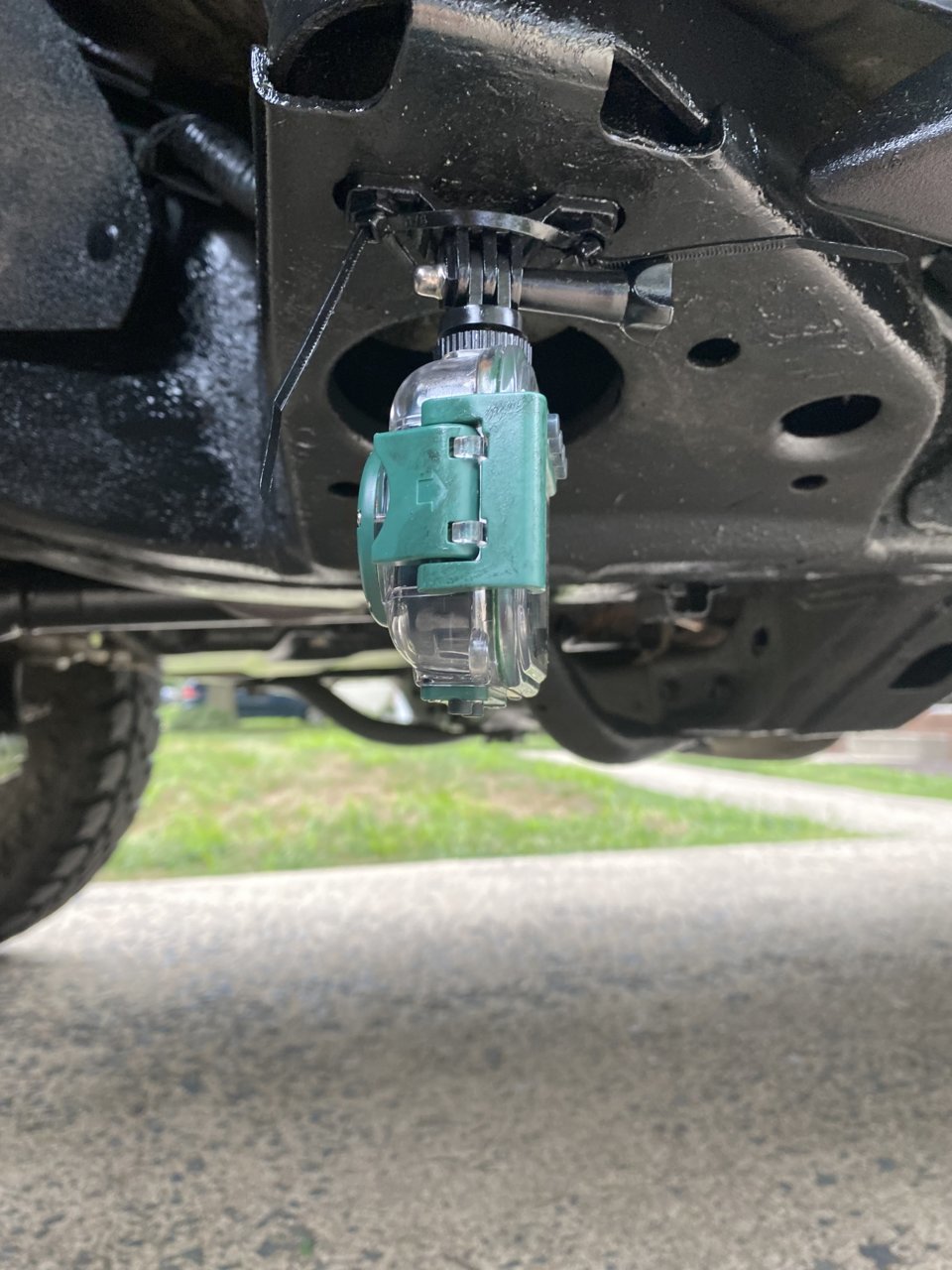

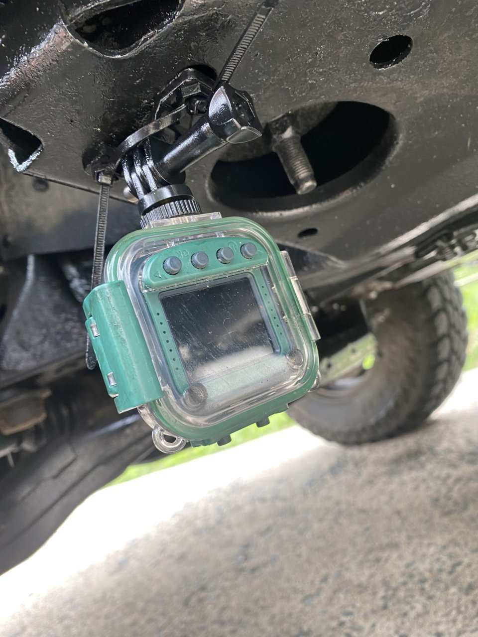

    Here is my grainy video of the stock bumps and the coil overs. The video is about 20 min long with the first 10 or so min the bump stock and the second half the shocks.
    Spoiler, I never saw the bump stops make contact.
    Went over speed humps from 20-30 MPH and at different approach angles. Enjoy- https://youtu.be/acW0AVsWUVY

    Here is where I put the camera for the bump stop part. For the shocks, I used one of the top fender liner screws. Luckily the whee didn’t stuff up in there and hit the camera lol.

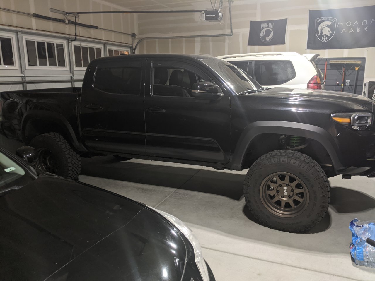

    So I'm looking at the clearance on this lift after installing it today. I don't rub and I'm thinking of running 315s/35s. Anyone else running this?
    Also what spanner wrench for adjusting the suspension

    Nice looking truck! I can’t help with the tires, I have 255/85/16s on mine. That said with enough trimming, cutting, bending and molding what you want could fit.

    Thanks buddy! I had a few 35s on my toyotas but every time I had enough clearance all that was needed was cmc. This one didn't get it quiet yet.
