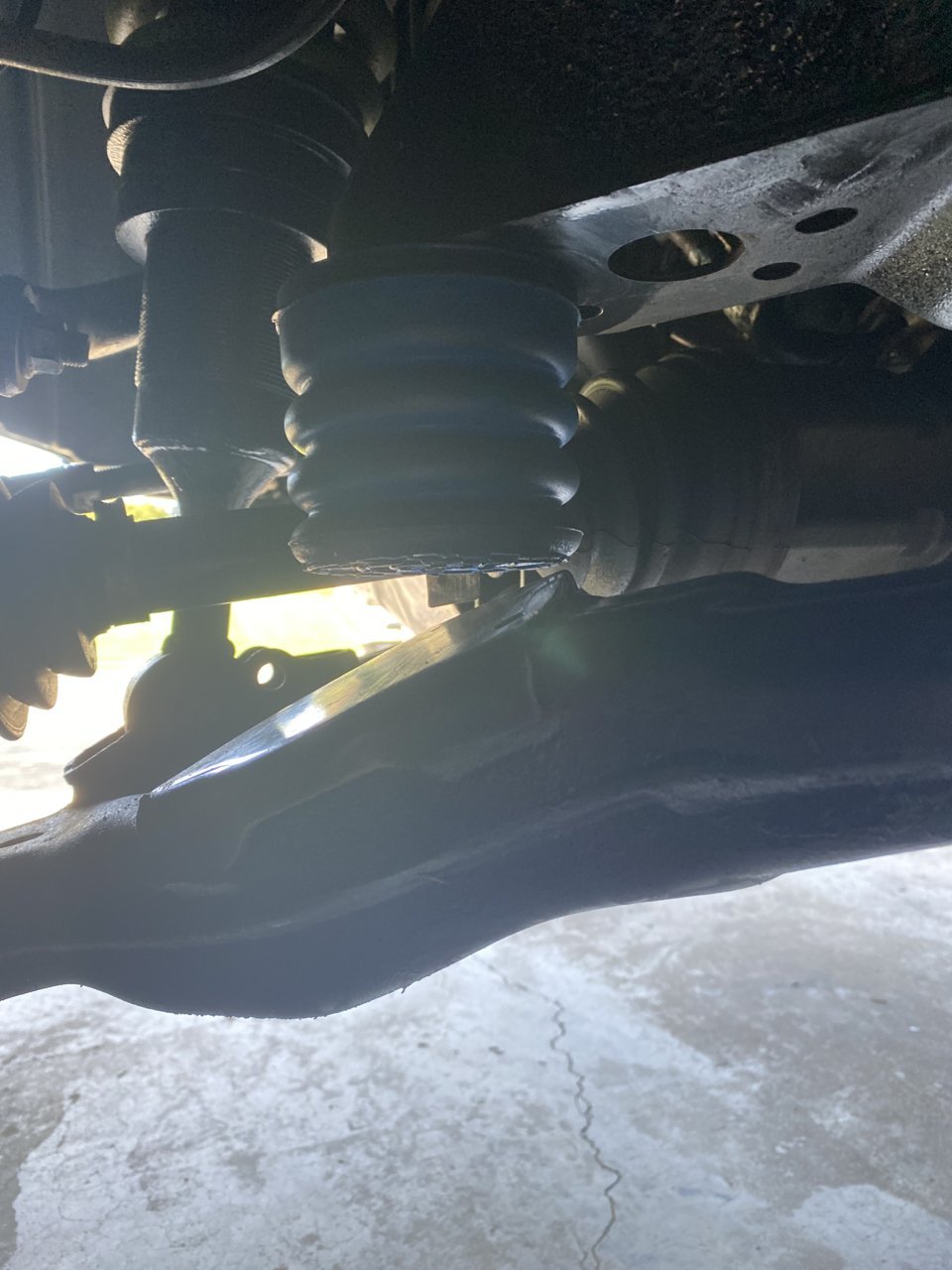

    Got the sumo spring front bump stops. Space at lowest point between stock stop and LCA about 1.5”, most about 2”.
    My lift has me about 22.25” wheel center to fender.
    After, about 1.25 to 1/8” on the inside. Depending if the truck is sitting level. If it’s parked on a hill facing down, the inside will touch slightly.
    It feels like it definitely did dampen some of the speed bumps. I made the video and will post it later. I’m not going to post the before again but if you’re curious, the stock stop didn’t make contact that I could tell in the video. The Sumos have plenty of contact. My lift had already taken care of the nose dives and body roll. Overall, I think it was a good purchase!
    Video finished uploading- https://www.youtube.com/watch?v=3URbxxPMeow

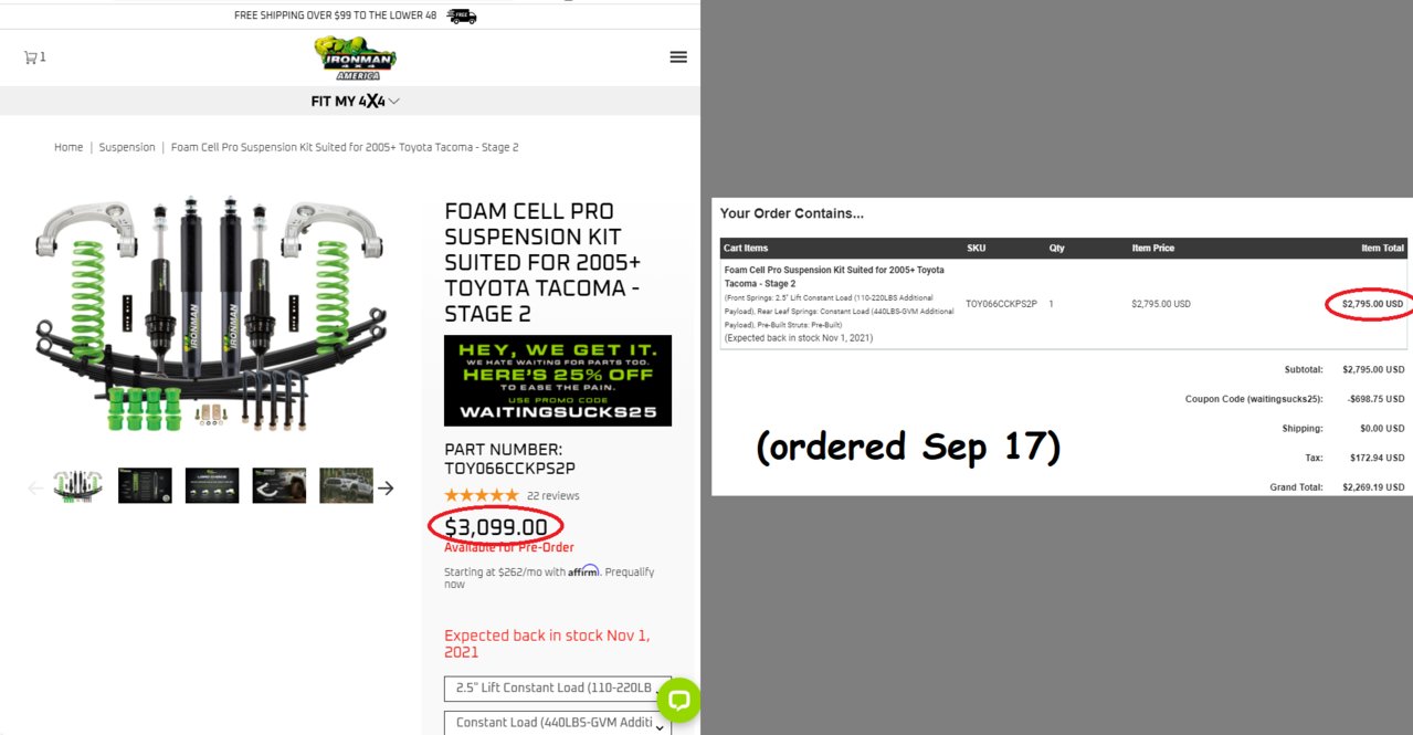

    Damn, did they *just* increase their price by 300 bucks?? Guess it's a good thing I jumped when I did.

    Probably, but they will probably have a 30% off coupon soon lol.
    I would guess they started off lower to sell and get going but now that more people are buying (and material prices+shipping increases) they might not have a choice.
    I remember last year when I got my Stage 1 unassembled kit for under 1500… a lots changed since then

    Yeah. Literally almost bought that kit last week and it was $2800
