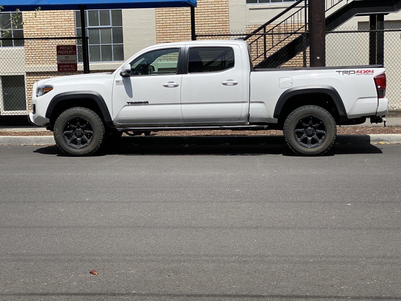

    Got the stage 2 kit installed. Initial thoughts are the ride is better than factory. The truck feels planted. Still waiting for it to settle and may want to raise the front a little more. It has quite a bit of rake and the bed has 300lbs in it right now.
    Looking forward to getting miles on the suspension and seeing how they do off road.

    To be honest, I was lazy and paid a shop to do it. They were giving a discount and it ended up be like $400 in labor, it was hard to pass up. They went to a alignment shop with a laser alignment machine. Said everything was good and it appears really good. But I didn’t ask for the sheet.
    That is something I am going to ask about. I’d like to get up to a 33” inch tire. 265/70/18 and don’t know I can without cutting.

    Amount of rake looks good IMO! Is that the standard rear Ironman leafs or the high-capacity?

    It’s the performance leaf pack.
    The photo doesn’t do it justice. But it’s sitting a couple inches higher probably and that’s with 300 lbs in it. But that’s also why I’m letting them settle before I do anything. I’d rather have some rake than dragging the rear on the ground.

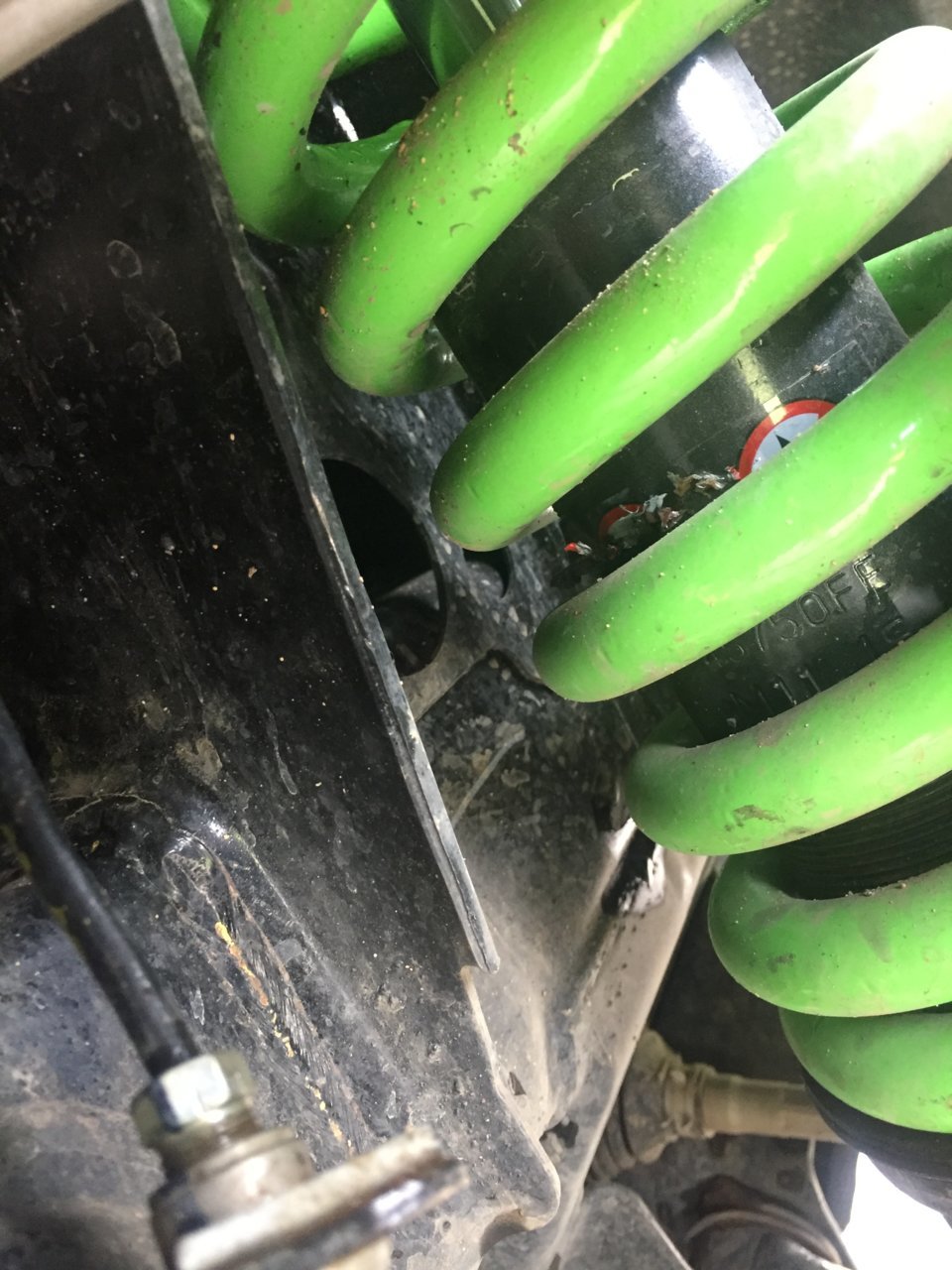

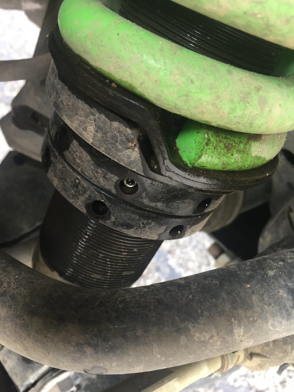

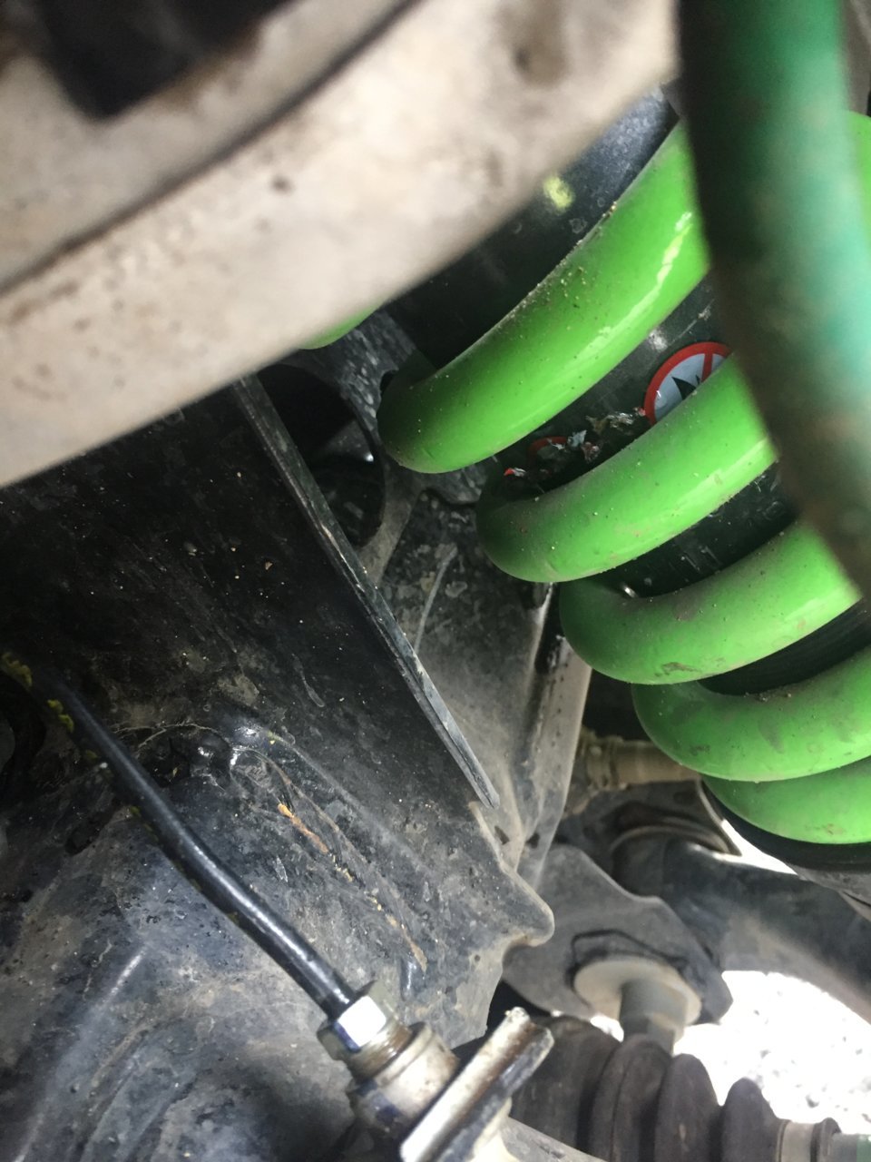

    I’ve been trying to track down a few noises and grinding sensations after installing my stage 2 FCP kit.
    I had a thunk from the passenger side front when flexing the front. Also had a mild grind coming through the steering wheel when slowing to a stop.
    I think I found the problem: passenger side coilover spring rubs on the shock body. Internet says to rotate spring 45-90 degrees. (I bought the kit with the springs pre-installed.)
    Anybody run into this issue?

    With the fitted spring perch, I don't think rotating the spring 45 or 90 degrees is an option. I would contact Ironman and likely they'll need to send you a new unit. This same issue happened to another user on the forums IIRC.

    They’re sending me replacements but are out of stock. 3 weeks. I had also ordered an awning a few weeks ago which was to be available May 31 but that got pushed to mid June. So I’m not holding my breath any thing will be here when I’m told. Rides fine other than some grinding when I stop.
    Looking at the coilover more closely, I think the spring bends into the shock body rather than the shock being deviated. Maybe it’s too much preload on the coils? I didn’t adjust anything from the preassembled stuff they sent. I think they were at ~2.5” with a slight adjustment for lean.

    I had this happen with my first set. Incorrect installation of the coils into the perch was the culprit. This wasn't on the FCPs, but on the traditional IM4x4 shock/coils.

    I posted this a few years ago. (Not me, but my coil). This was caused by improper installation of the coil into the perch, and went on until I got a replacement from IM.
