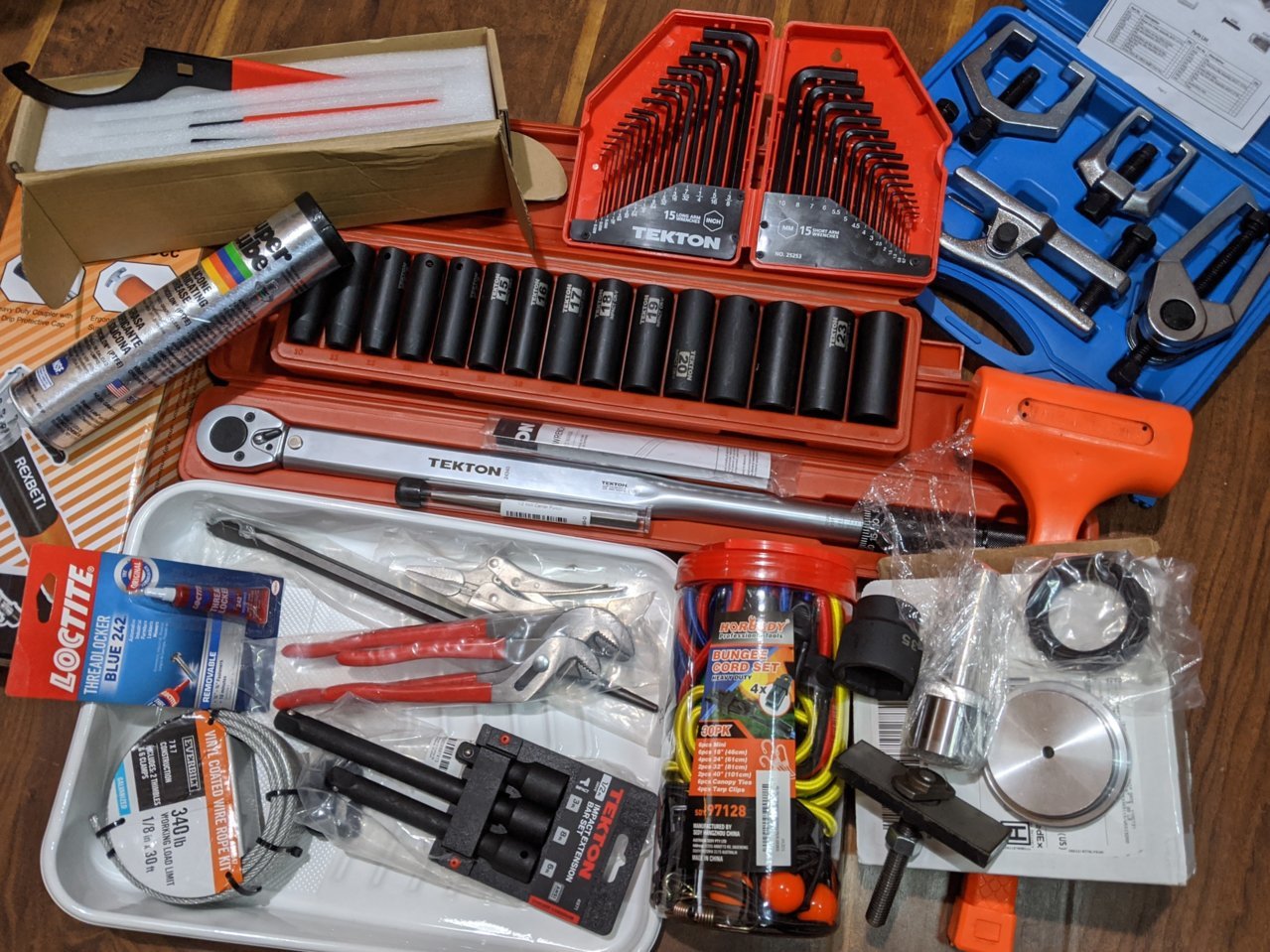

    I love spending all the money I "save" doing my own installs on tools... muhahah.
    After weeks of watching install videos this is everything I've "saved" for my upcoming foamcell pro & ECGS bearing install. :bananadance:
    Sadly it seems my Ironman shipping date has been pushed back almost a month and a half from when I originally expected it to ship due to the shenanigans at the ports... which double sucks because I actually requested some time off work this month to do the install. Le sigh. Here's to patience building character and all that. :playball:
    Snaeper and ohcaltexscar like this.

    Not a bad plan to have everything you need! Don’t forget a friend to lend a hand if you can get one. It’ll make things much easier (if they are mechanically inclined)
